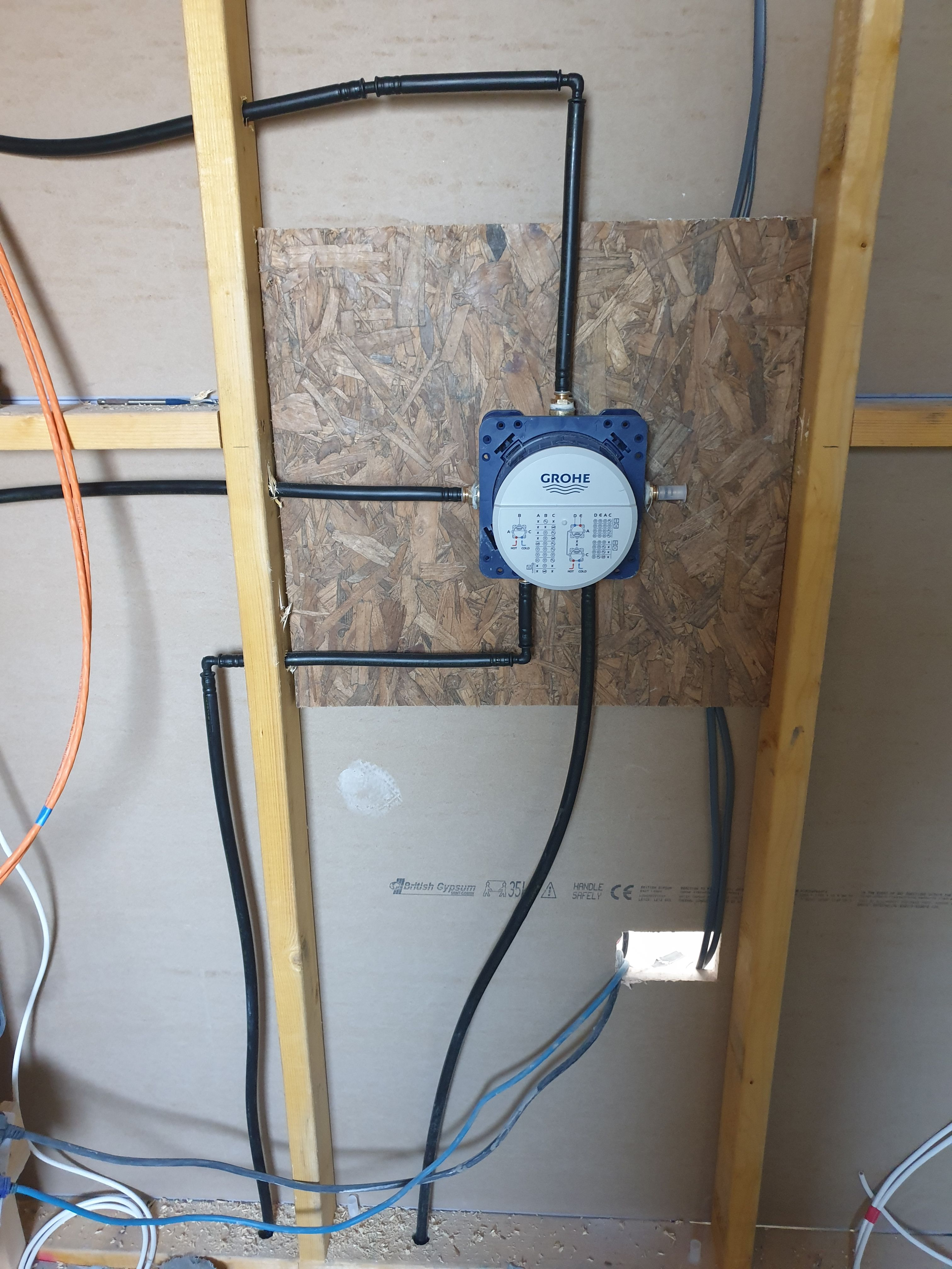

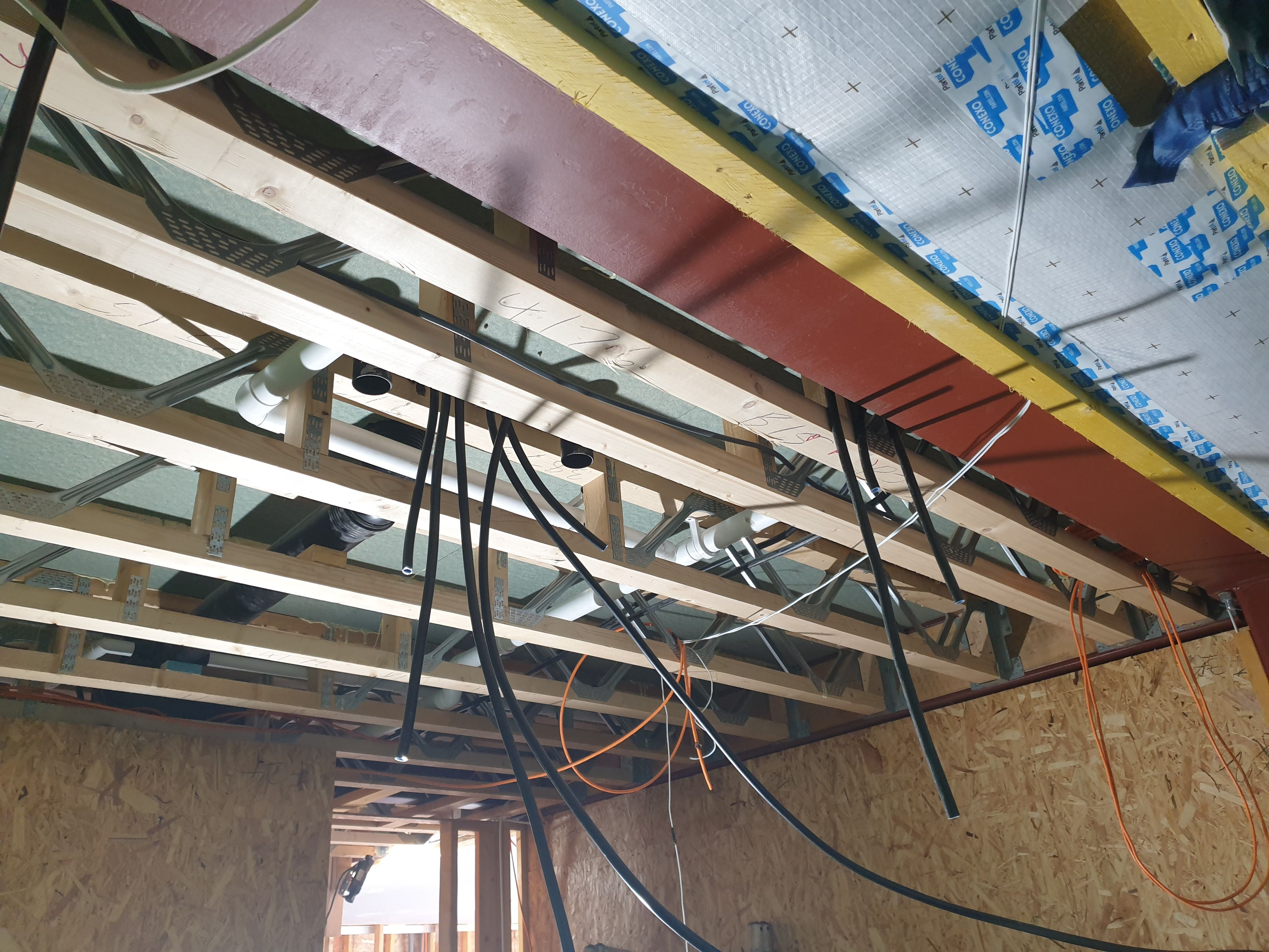

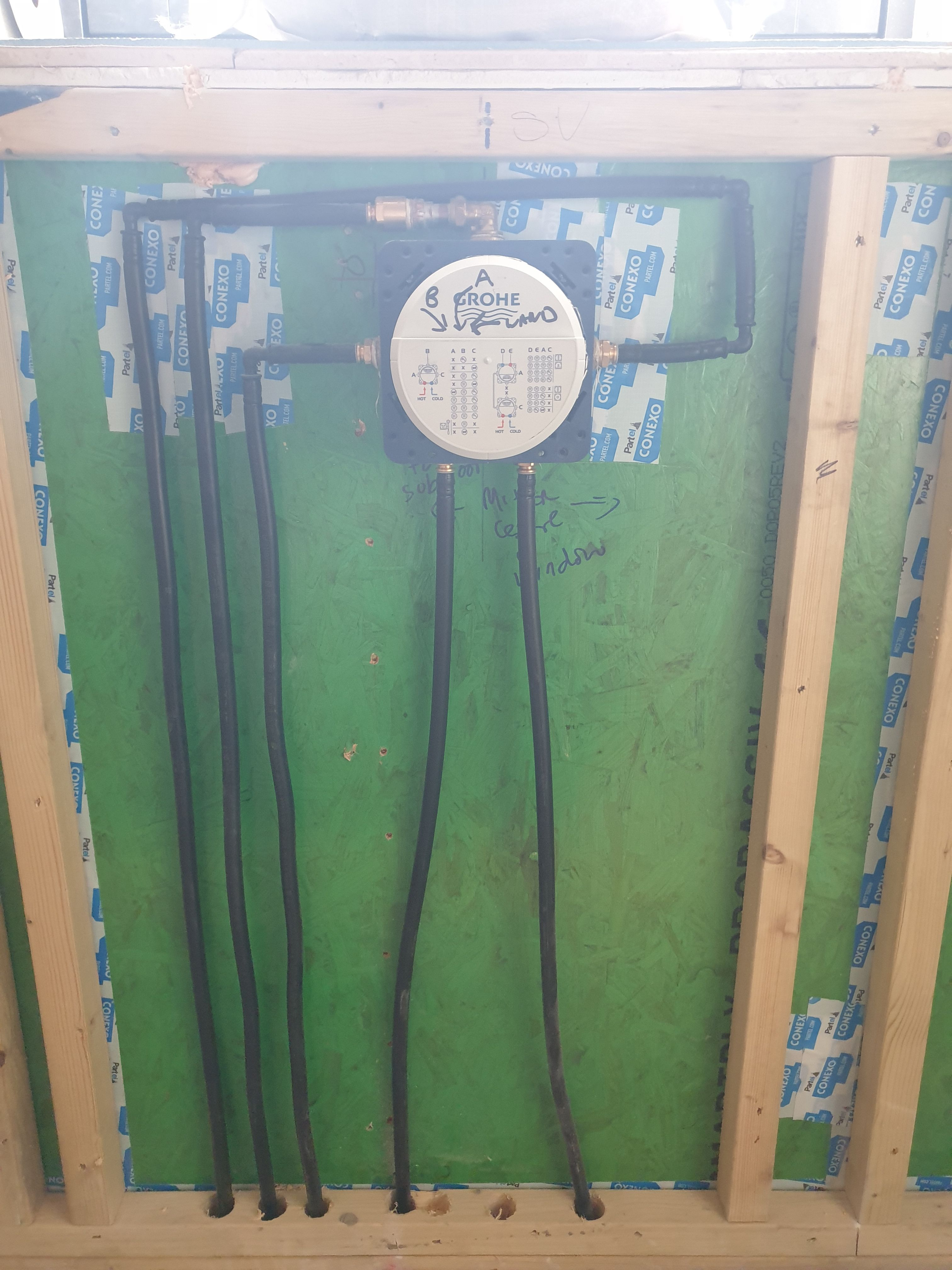

17 hours ago, HughF said:
The issue with 16mm is the internal bore of some of the fittings. I use 16mm mlcp wherever I can, but I always try and minimise the fittings count, as they are restrictive.
Tell me about it!  Our plumber hadn't used MLCP before (or at least it seemed that way) as he installed shower runs as if they were copper with fittings everywhere, rather than bending the pipe.  This was with the MEPLA fittings, which are even narrower than some of the other brands, so, with a 12m 16mm run and 5->6 of the 90-degree fittings, we'd had got minimal flow rate from the shower.  Had to take some photos and send them to Geberit technical who confirmed that it wasn't going to work and not designed to be used like that, to convince the plumber (with the help of the main contractor) to redo things.   I've still got the photos somewhere, which were quite assuming..
Edited by Dan F
I've got a 16mm bender, I always try and bend as much as possible.
image.thumb.png.1f907ff8aec21560a36cb607aefc558f.pngimage.thumb.png.ce531090615cdb3196160a84a2d2dd58.png
Then, on top of this, there were going to add more 90deg fittings in between the joists:
Edited by Dan F
