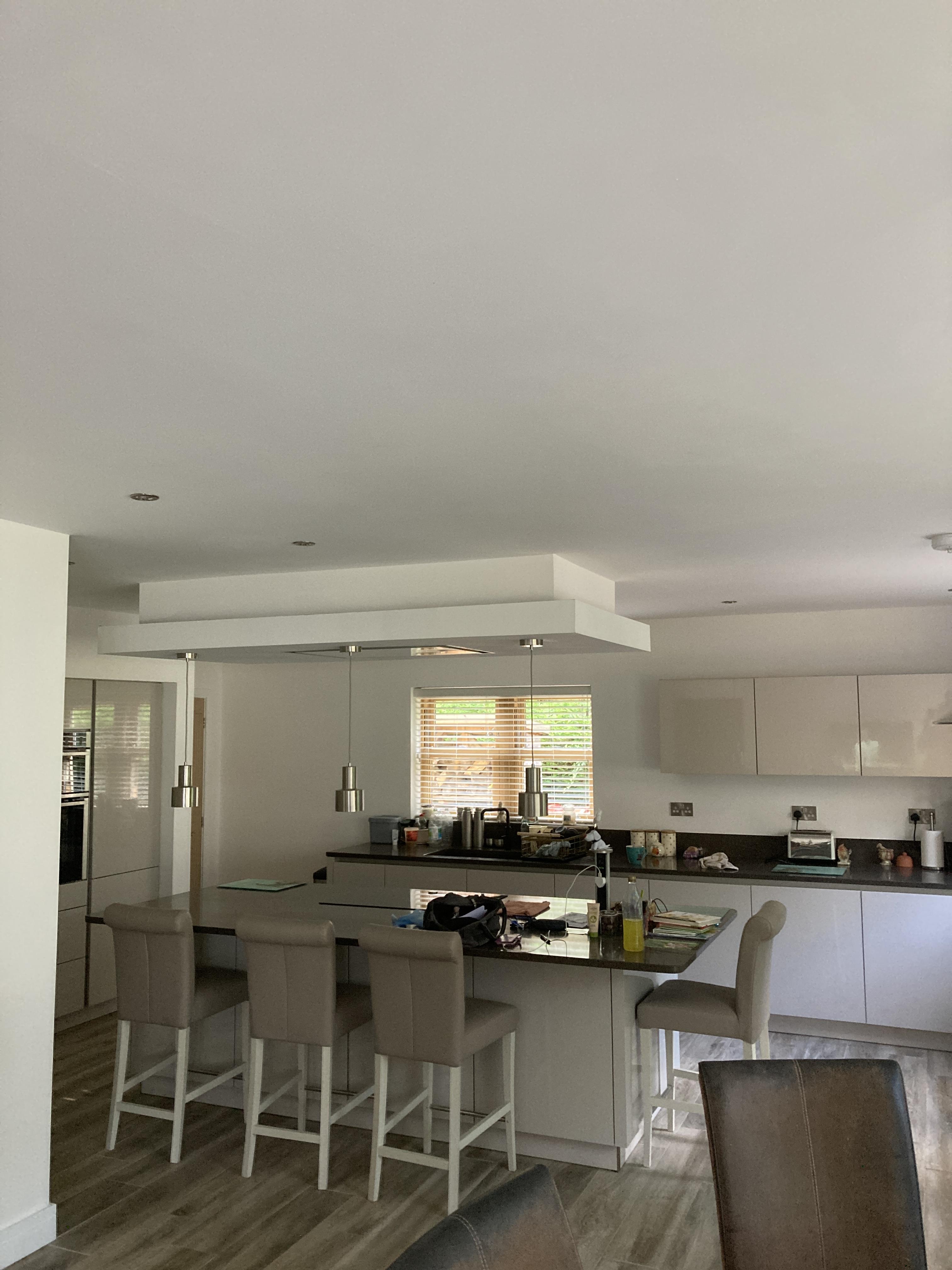

nod Posted July 4, 2023 Share Posted July 4, 2023 MF Is made for this It’s light perfectly straight and much easier to work with than timber Link to comment Share on other sites More sharing options...
Owool12 Posted July 4, 2023 Author Share Posted July 4, 2023 37 minutes ago, nod said: MF Is made for this It’s light perfectly straight and much easier to work with than timber Nice kitchen, something like that dropped ceiling is what I’m aiming for. In my opinion I feel that wood will be cheaper than MF & easier to work with so am wanting to work with wood for this Link to comment Share on other sites More sharing options...

nod Posted July 4, 2023 Share Posted July 4, 2023 1 hour ago, Owool12 said: Nice kitchen, something like that dropped ceiling is what I’m aiming for. In my opinion I feel that wood will be cheaper than MF & easier to work with so am wanting to work with wood for this Metal is about the same price and much easier to work with Link to comment Share on other sites More sharing options...
