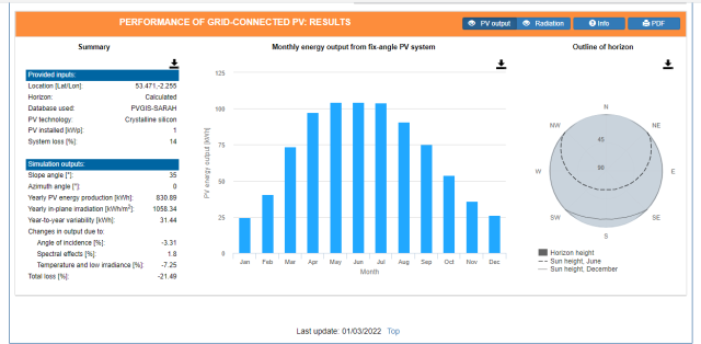

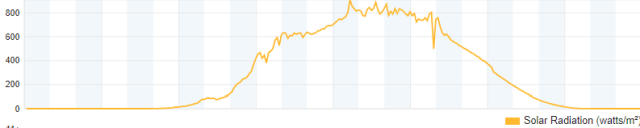

SteamyTea Posted July 3, 2023 Share Posted July 3, 2023 3 minutes ago, DazRave said: Little too advanced for me to use without fully understanding the basics yet. This is for a 1 kWp system in Manchester Link to comment Share on other sites More sharing options...

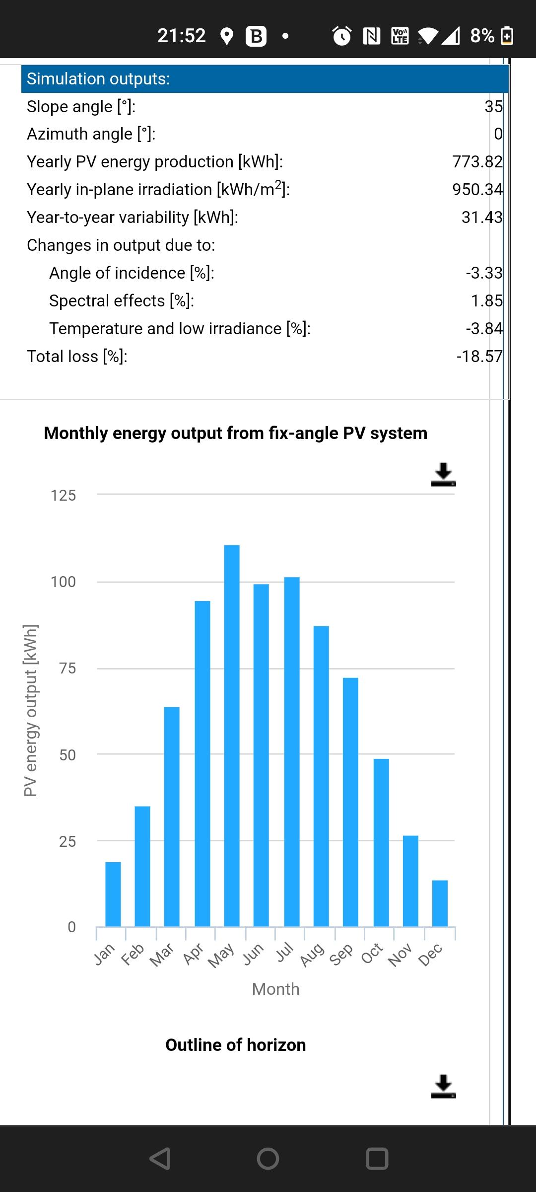

JohnMo Posted July 3, 2023 Share Posted July 3, 2023 Out of interest NE Scotland with same data inputs - winter production for me is rubbish compared to Manchester Link to comment Share on other sites More sharing options...
DazRave Posted July 3, 2023 Author Share Posted July 3, 2023 9 minutes ago, SteamyTea said: This is for a 1 kWp system in Manchester Thank you. I've just had another little look on the laptop and managed to actually make it work. The site wasn't very phone friendly that's for sure. So it reckons "Yearly PV energy production [kWh]: 861.08" - How much degree of change should I expect from that estimate? Considering we intend to stay in this house for well over 15 years and assuming the panels don't work half as good in 10 years time, my loose calculations say a £8-10k system (inc battery) could be really worth it. Link to comment Share on other sites More sharing options...

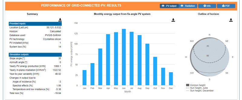

SteamyTea Posted July 3, 2023 Share Posted July 3, 2023 5 minutes ago, JohnMo said: winter production for me is rubbish compared to Manchester Penzance Link to comment Share on other sites More sharing options...
SteamyTea Posted July 3, 2023 Share Posted July 3, 2023 (edited) 4 minutes ago, DazRave said: How much degree of change should I expect from that estimate? It shows that So for me, 48/1060 * 100 = 4.5% Huge daily variation though. Edited July 3, 2023 by SteamyTea Link to comment Share on other sites More sharing options...

SteamyTea Posted July 3, 2023 Share Posted July 3, 2023 (edited) 12 minutes ago, DazRave said: How accurate is this tool, was actually what I was getting at. As in, how close is it's prediction compared to reality if you were to input the exact specifications (not that I have these, but curious how good the tool is) Pretty good, most people find it under estimates a bit, maybe 3 to 5%. Some of that will be down to quality of modules (the real term for panels). This is because, to offer a guaranteed output in a decade of say 80% performance, the manufactures actually supply higher powered modules, but marked up as lower powered ones i.e. 320W modules but marked as 305W. Edited July 3, 2023 by SteamyTea 1 Link to comment Share on other sites More sharing options...

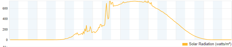

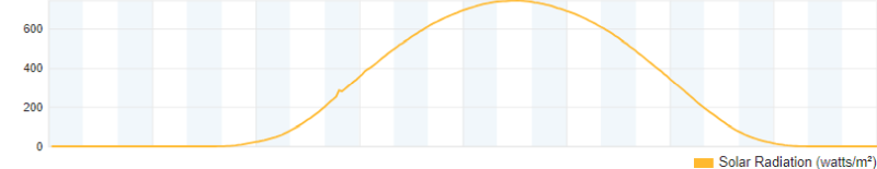

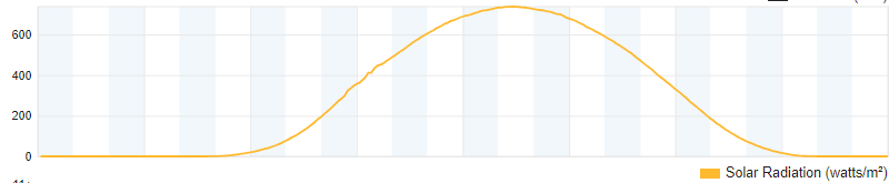

SteamyTea Posted July 3, 2023 Share Posted July 3, 2023 1 minute ago, DazRave said: As for heating water, we're going to keep the gas boiler as it's not very old but I hadn't thought about a solar system that could aid this too. You can get 'diverters' that sense when the system is exporting power to the grid and turn on the water heater, or battery charger. The thing to remember is that PV is not a constant power, or even a normally distributed power curve. It is very variable. If you can find a local WeatherUnderground station that has a solar meter on it, you will see how, even on a sunny day, there is often a lot of variation. Two very very rare days in a row. 3-6-23 4-6-23 5-6-23 6-6-23 1 Link to comment Share on other sites More sharing options...
