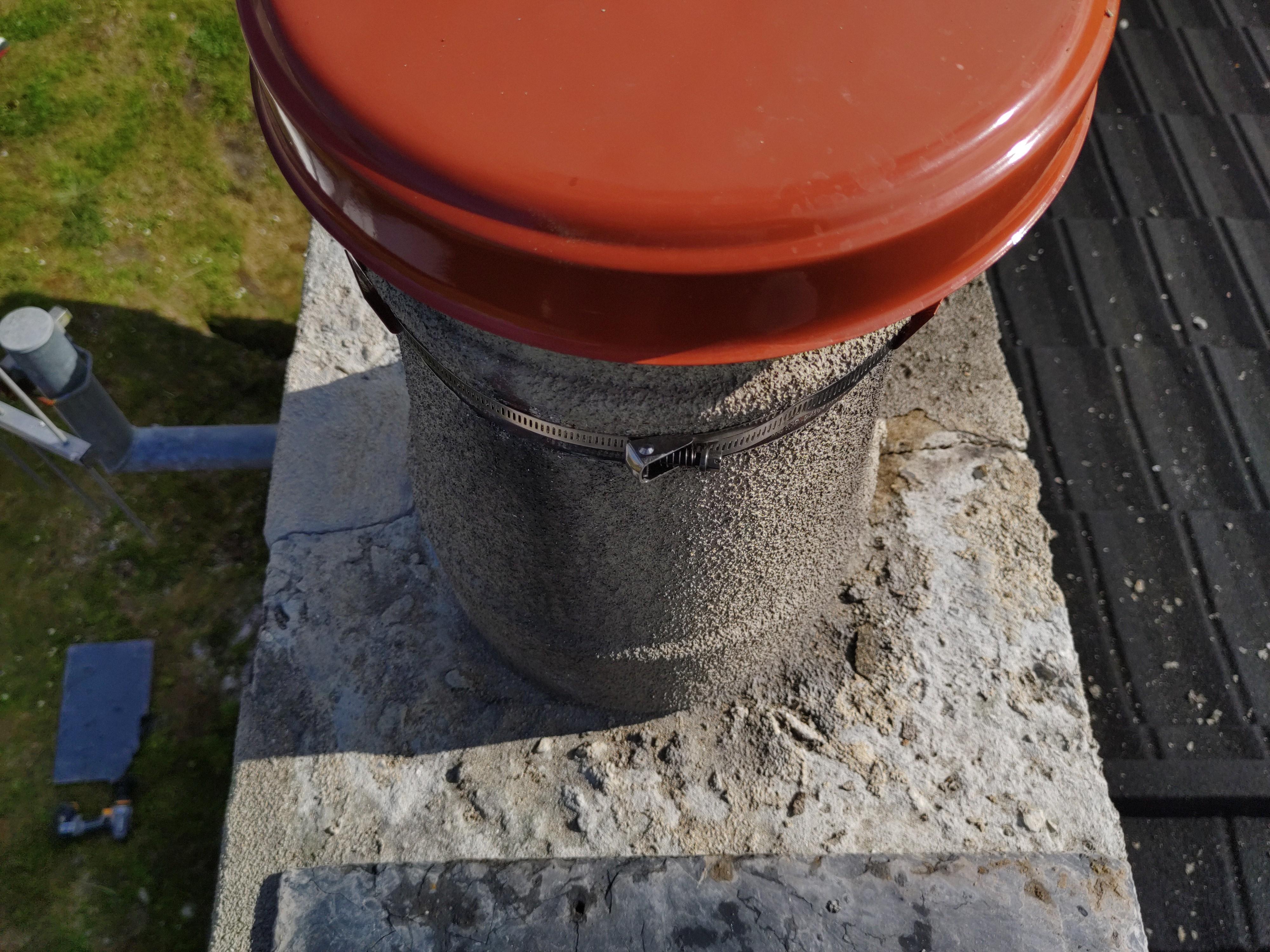

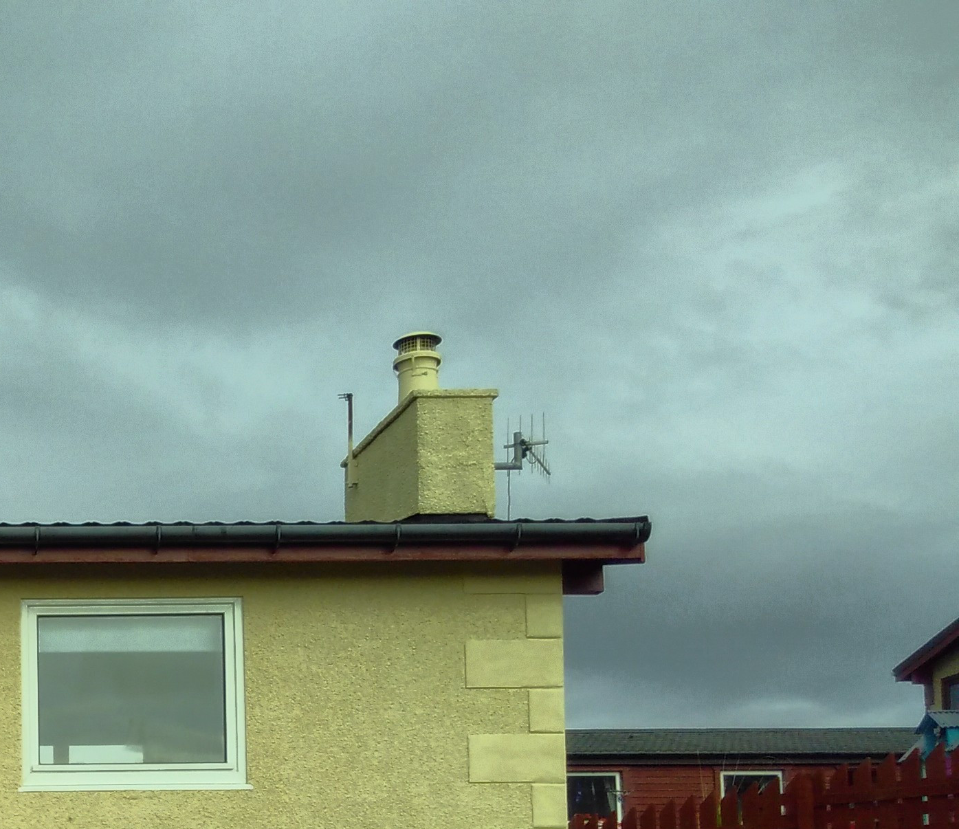

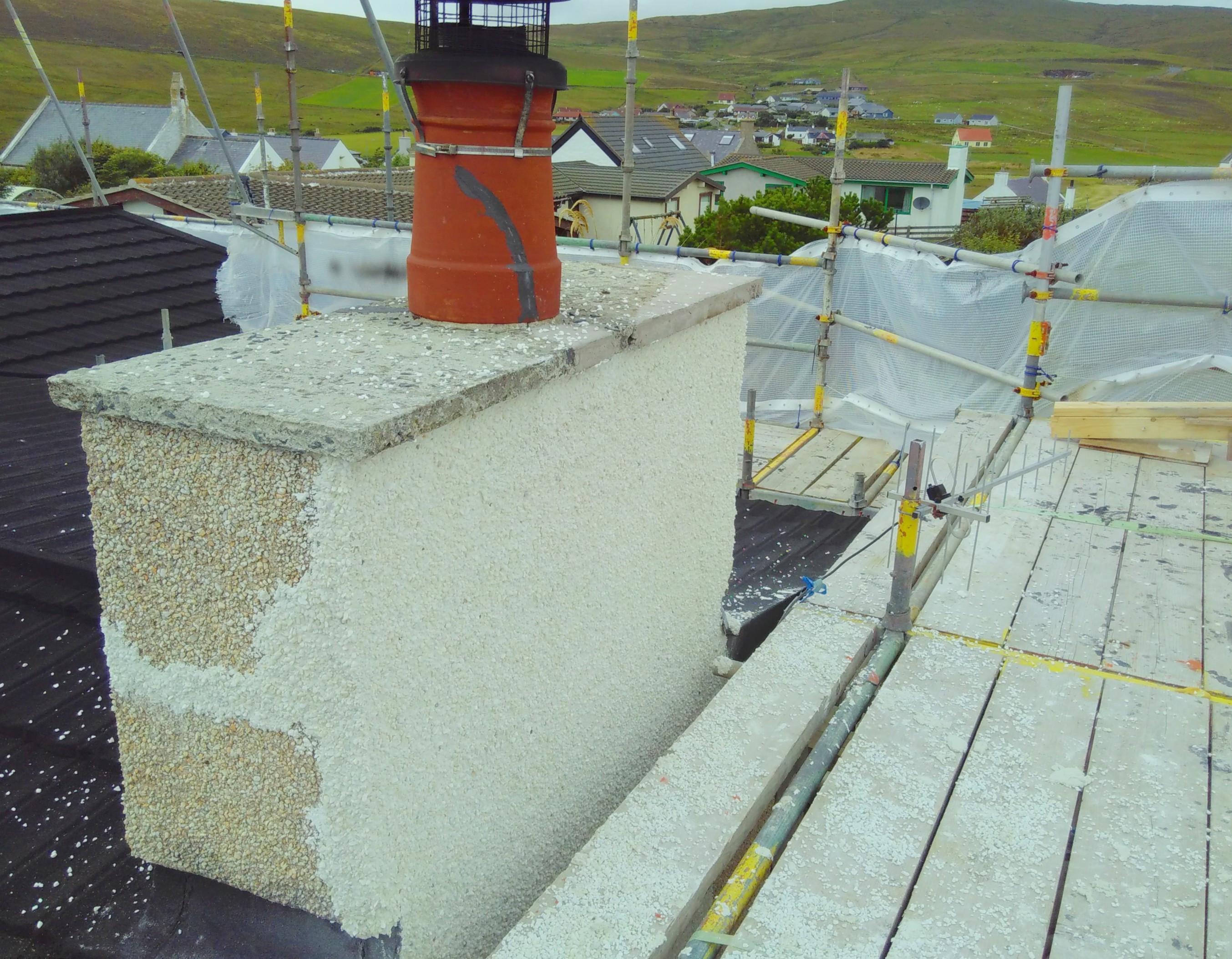

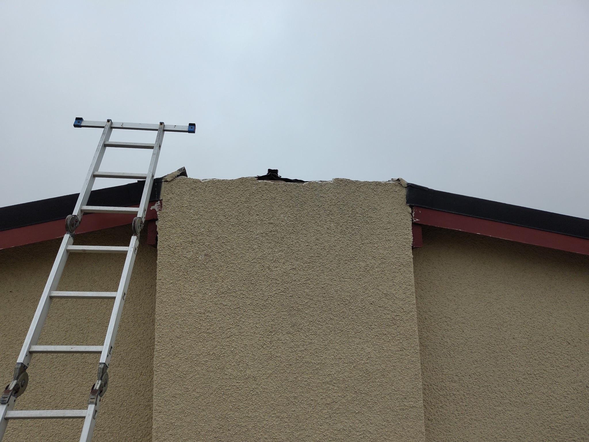

Nick Thomas Posted June 28, 2023 Author Share Posted June 28, 2023 Thanks; yeah, entirely possible that we've missed something. If so, it'll become obvious when the rain continues to come in, and I can get on with those more drastic measures... So, pics. Exterior: Probably the best pic I've got of the top of the chimney stack, partway through a great deal of work. It's less awful than this now, honestly, but still... what a mess. It currently looks more like: (We didn't *just* cover up the awful with a layer of waterproofing, we also remedied the fabric). And interior: The only thing that's changed there is that we've stripped off the rest of the plaster. It was ruined anyway. Link to comment Share on other sites More sharing options...

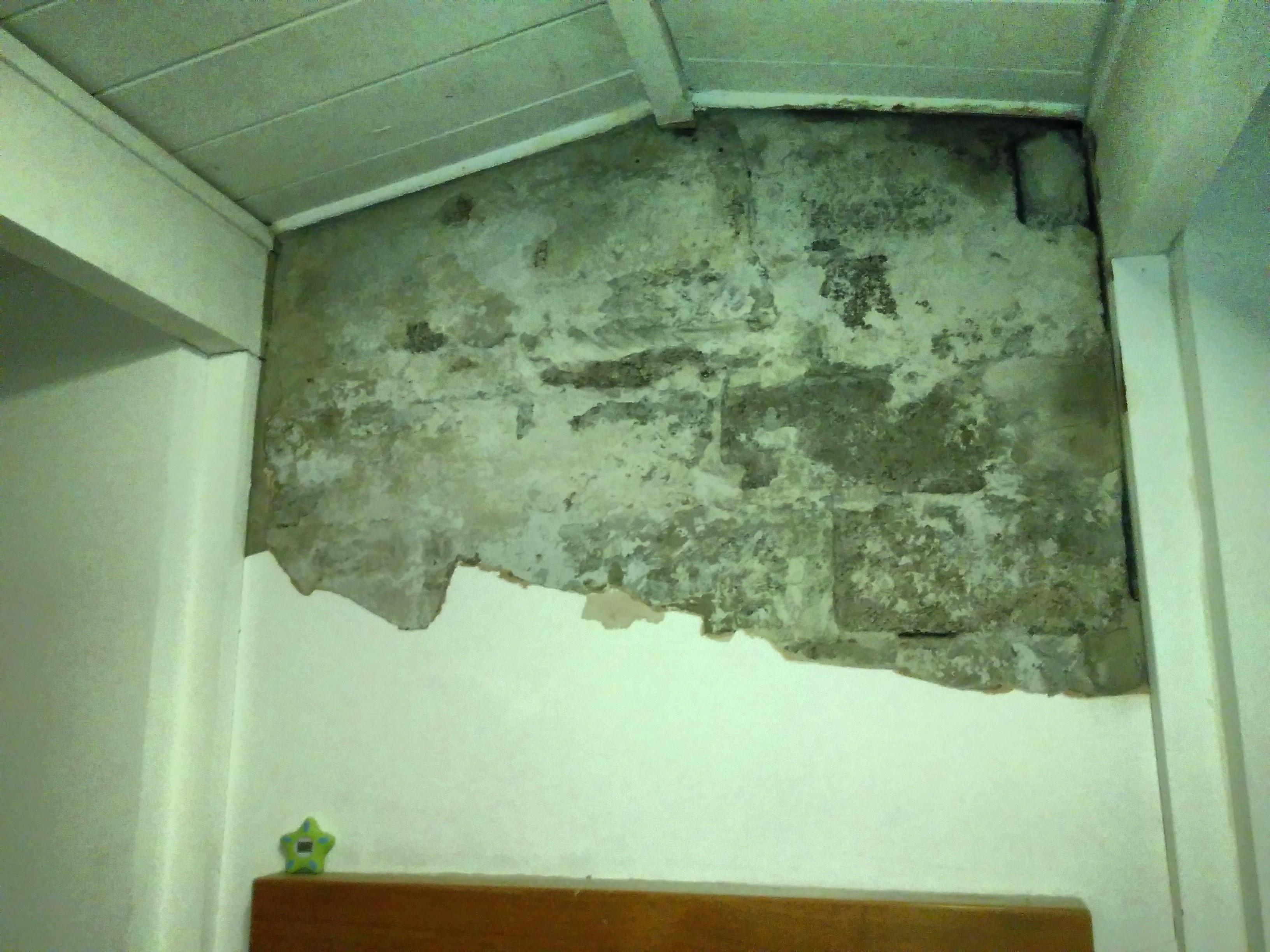

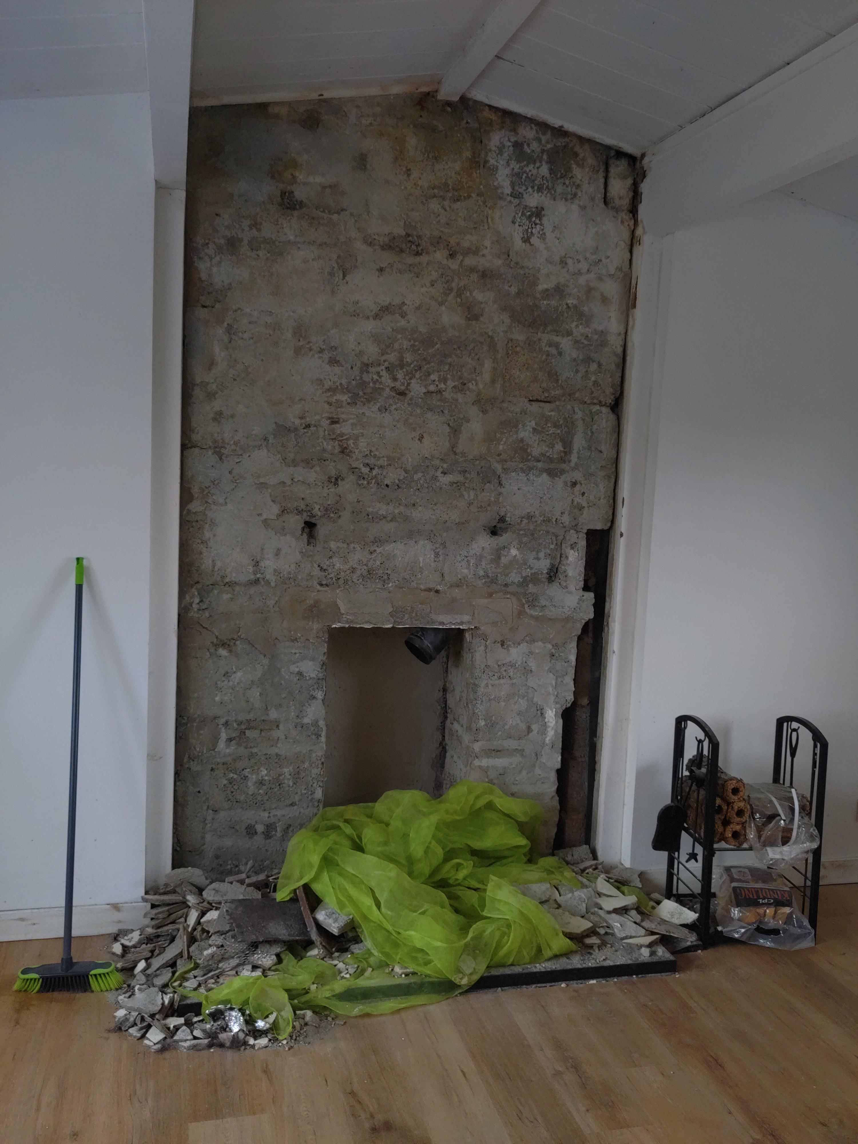

Nick Thomas Posted July 2, 2023 Author Share Posted July 2, 2023 Well, we're up now and here's the first bit of progress. Fire out, mantelpiece off (I was worried those two would be hard, but they were easy \o/), mouody plaster removed. Will have a go at capping the chimney tomorrow. Christ on a bike that wall is bad. Doesn't matter though, the gap between the two wooden uprights is 1700mm so I can just slap plasterboard in front of the whole thing - with insulation behind. The inside of the flue pipe is dry as a bone - I had soot coming down it while whaling on the wall. There were streak marks all over the outside of the flue pipe though, and there was plenty of rust too. Turns out Nome of the guttering or soil stack was replaced when the scaffolding came down though. So that's an unexpected extra job. Still, the top and bottom of each pipe is established so - famous last words - how hard can it be? Tomorrow, onwards. Link to comment Share on other sites More sharing options...
Nick Thomas Posted July 2, 2023 Author Share Posted July 2, 2023 Just ordered some https://www.jewson.co.uk/p/gyproc-thermaline-pir-2400-x-1200-x-38mm-BGB28492 in anticipation of being able to make the leak go away. It's not a lot of insulation, but I'll feel better with an air gap between it and the stack - and *any* insulation on this bit of wall is an improvement. Butyl tape to go all around, and i guess for the seams between the boards. I'll probably lay them lengthwise, so the joins run horizontally. I guess I need studs going up the centre of the wall and along where each seam will be, for screwing into? Link to comment Share on other sites More sharing options...

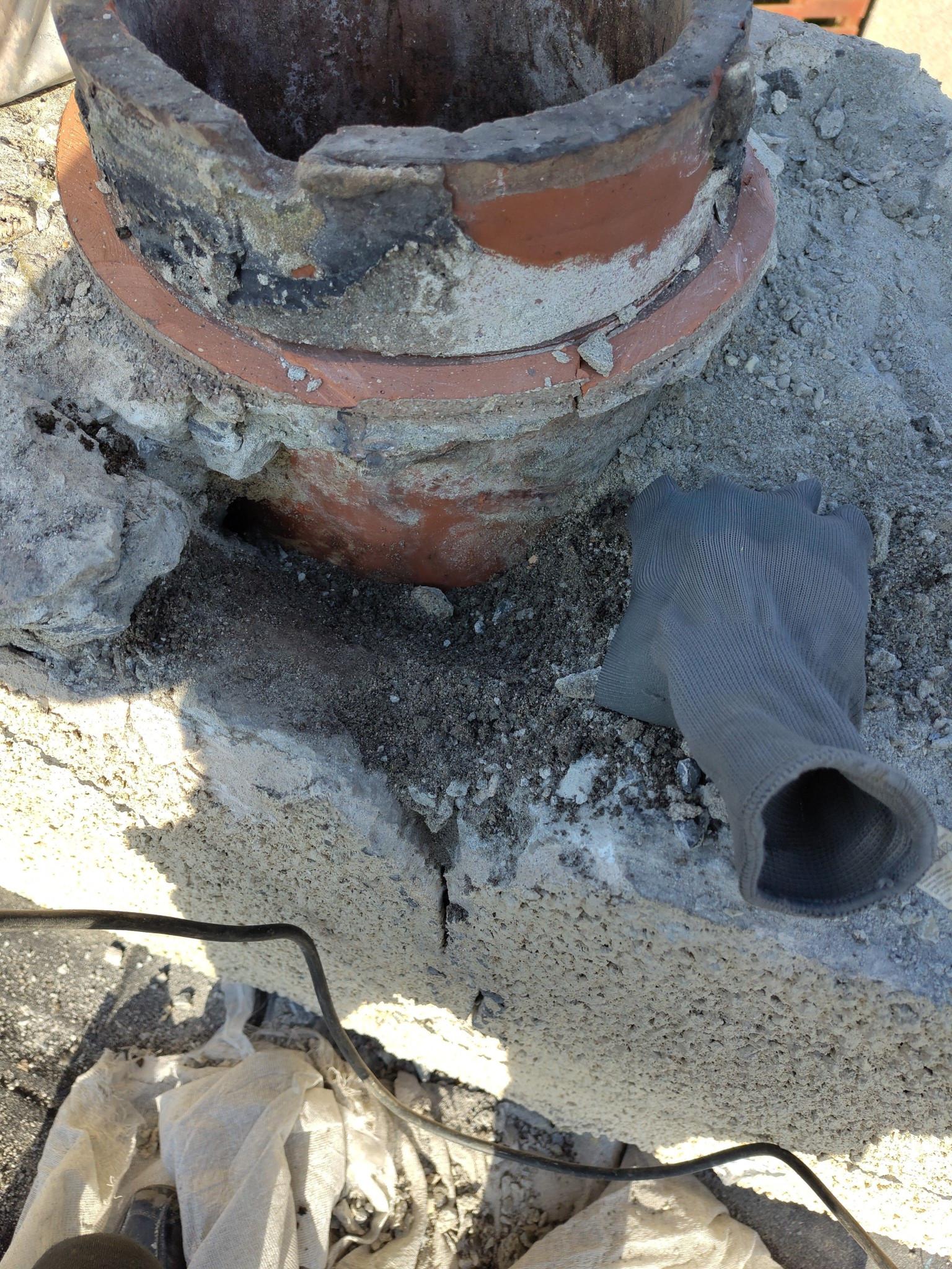

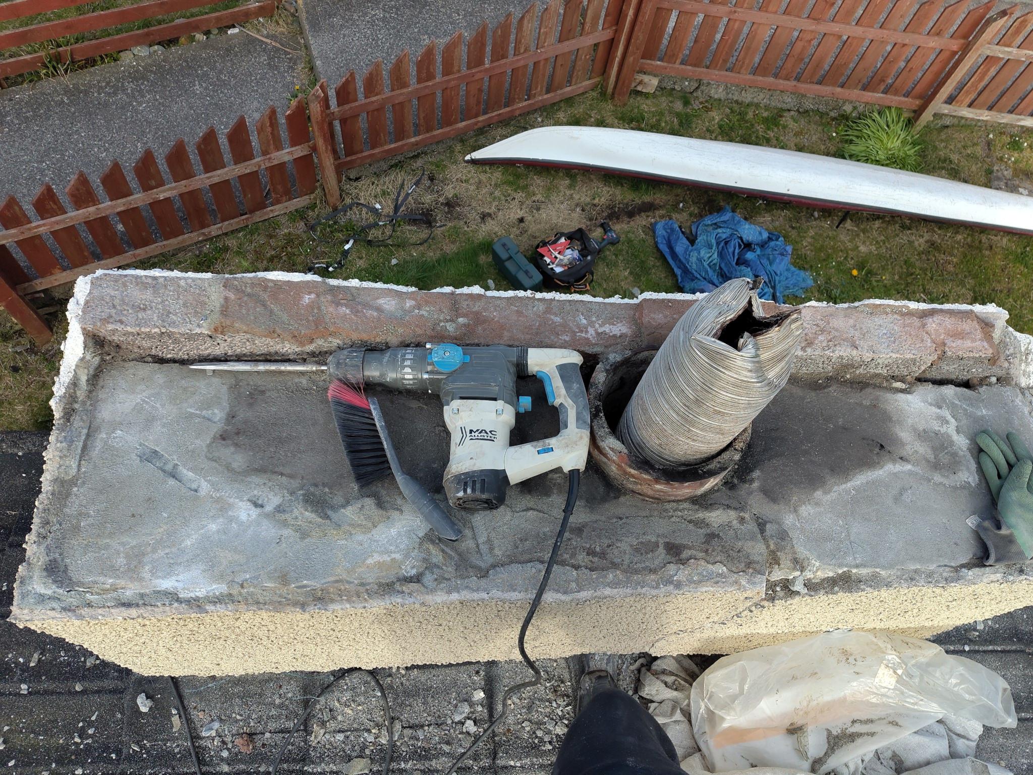

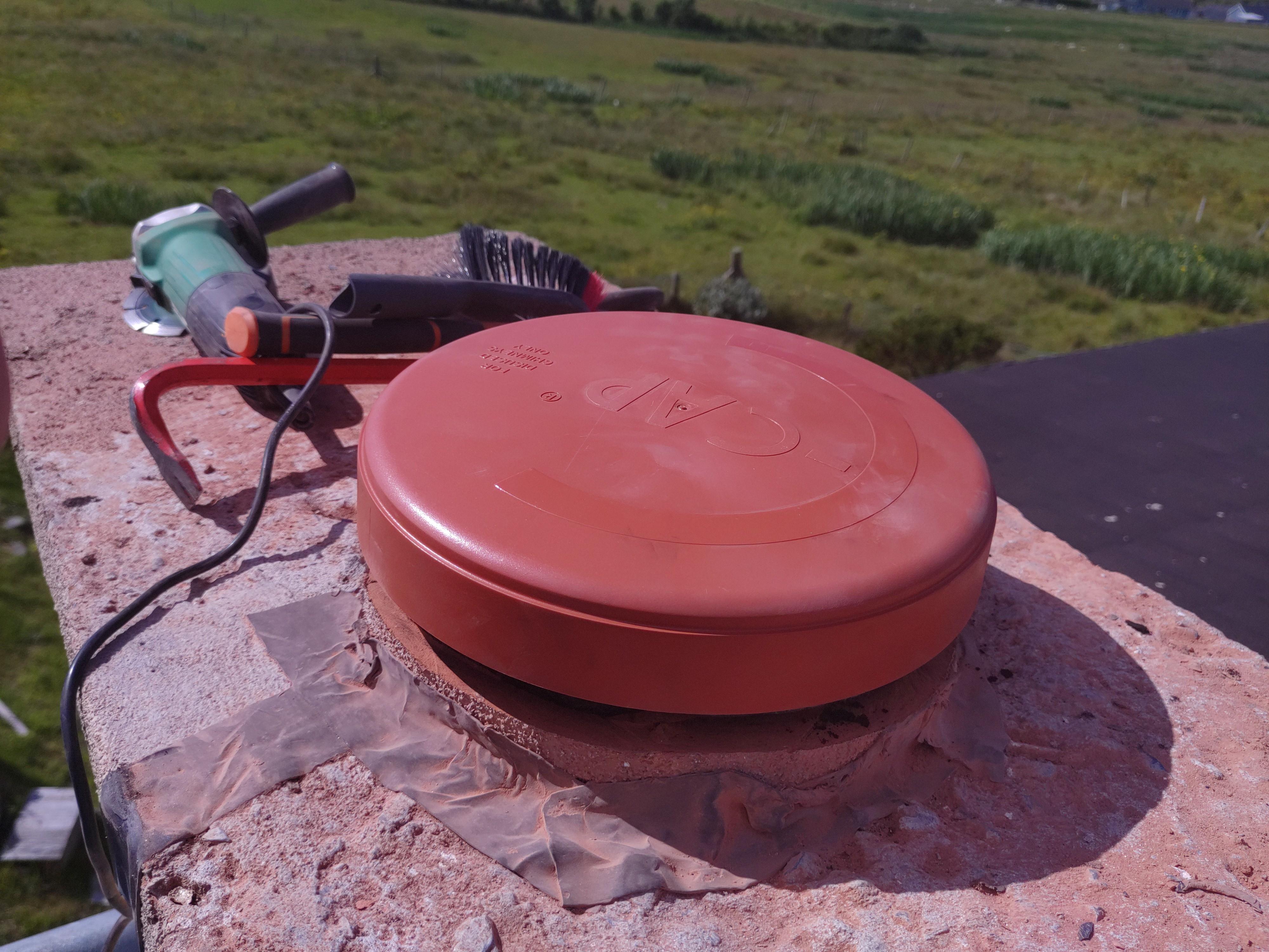

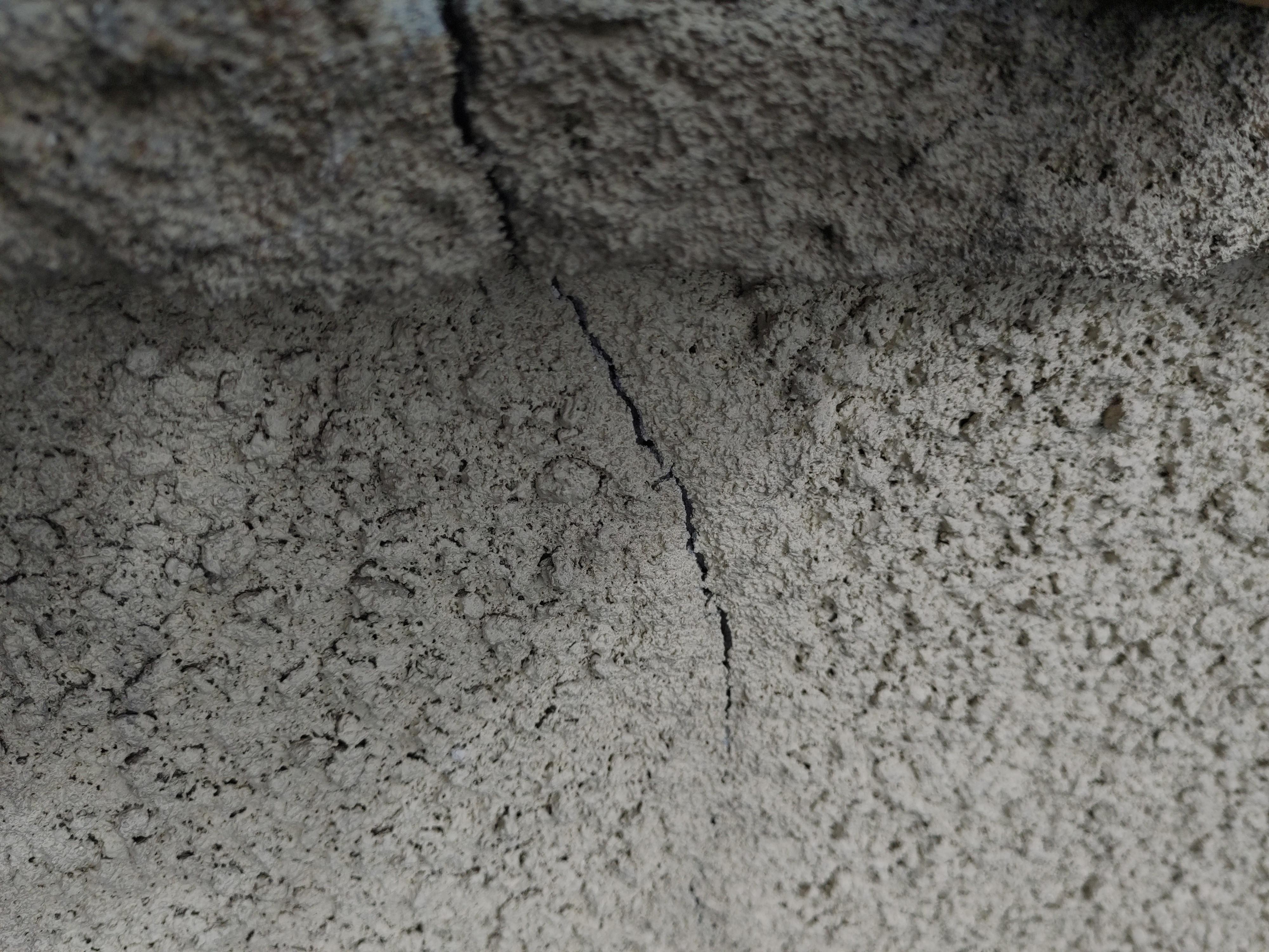

Nick Thomas Posted July 5, 2023 Author Share Posted July 5, 2023 Got the chimney capped, but I'm pretty sure that won't solve the problem. The corksol hadn't stuck well to some parts of the capstone, so I went up with a wire brush to clear it off ready for a different water-tight coating, as I'm pretty sure it's porous, to find... The south side - the one where rain causes the strongest leaks - is to the right in this picture and the crack extends about halfway down the chimney stack. It wasn't like that two years ago; it's new movement/separation since then. Just. What. I've got until Sunday to do something to this. New plan is to knock off the chimney pot, to get a nice cuboid shape to work with, then drape it with heavy-duty plastic sheeting, ratchet straps near the bottom, pop some concrete blocks on top to hold it in place. Then come back another time and demolish the stack down to well below the crack. I could pop a new cap on the new level, or get it below the existing roof and have the roof cover it, I suppose either would work. Happy to take suggestions for other ways to do it ^^. Link to comment Share on other sites More sharing options...
joe90 Posted July 5, 2023 Share Posted July 5, 2023 (edited) I second get rid if it’s not used, take down below roof level and tile/slate/whatever over. Edited July 5, 2023 by joe90 1 1 Link to comment Share on other sites More sharing options...
Gone West Posted July 6, 2023 Share Posted July 6, 2023 12 hours ago, joe90 said: I second get rid if it’s not used, take down below roof level and tile/slate/whatever over. +1 Link to comment Share on other sites More sharing options...

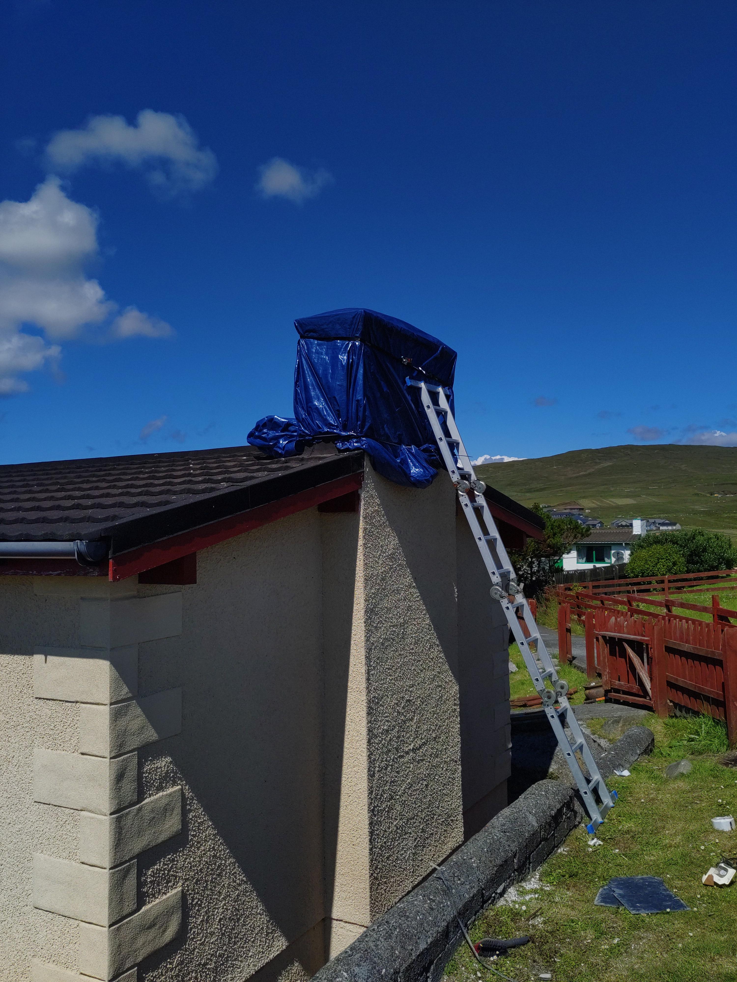

Nick Thomas Posted July 6, 2023 Author Share Posted July 6, 2023 (edited) Aye, definitely the plan when I've got a bit more time, I don't want to put myself under pressure with it when we're definitely leaving on the boat on Sunday . I can probably make it back a bit later in the year, but wanted to give it every chance of staying dry until then. So I've applied copious butyl tape to the cracks, knocked off the chimney pot, fitted a chimney cap to the hole, and wrapped the whole thing in tarp. It'll do for now. Edited July 6, 2023 by Nick Thomas 2 Link to comment Share on other sites More sharing options...

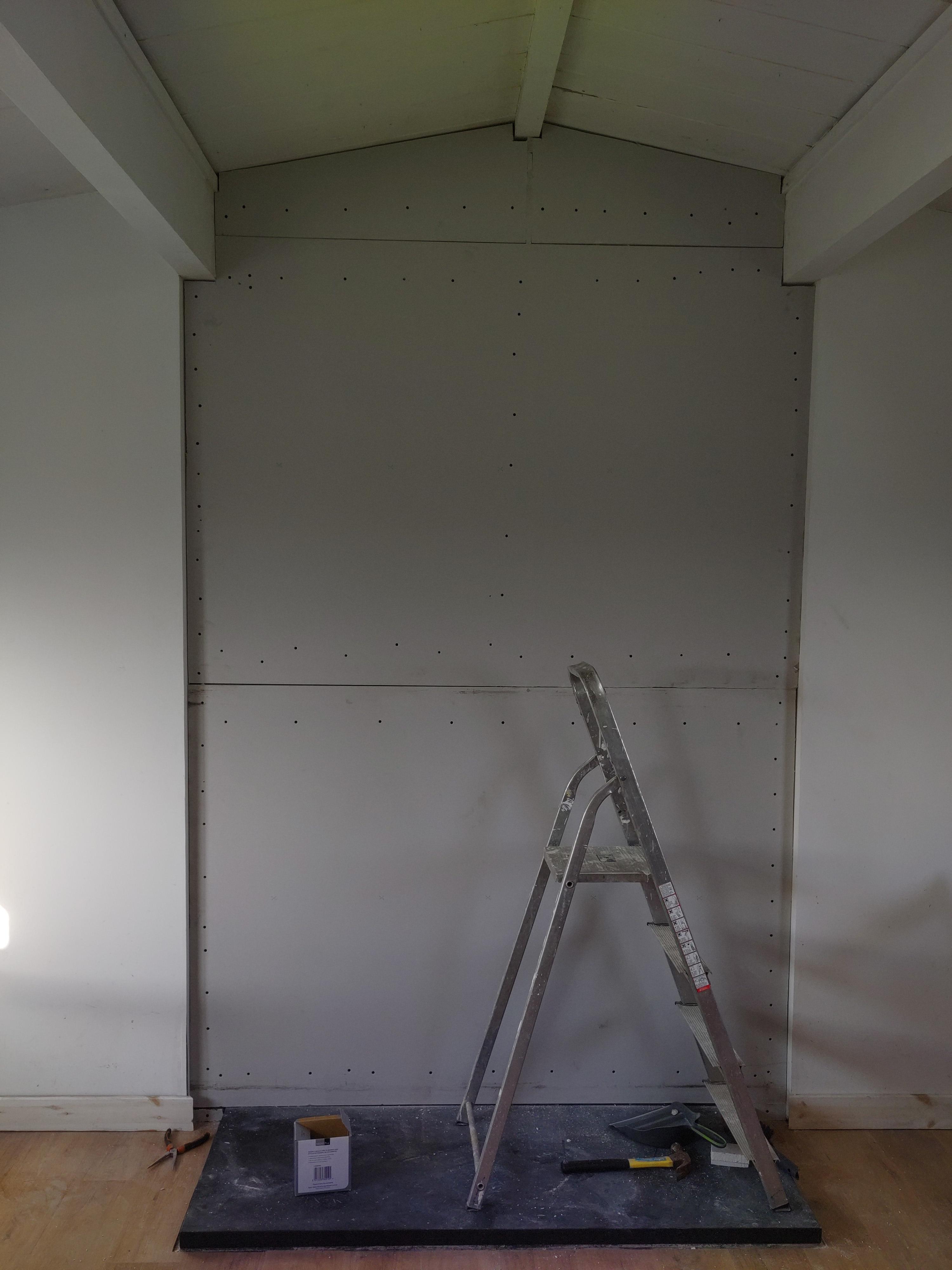

Nick Thomas Posted July 7, 2023 Author Share Posted July 7, 2023 The rain came down and the wall stayed dry, so I went for it: First time plasterboarding. Still need to tape&fill but reasonably proud of it. Lifting that middle piece into place by myself - several time, to adjust the fit - was an absolute killer. Time for a beer I think. 2 Link to comment Share on other sites More sharing options...

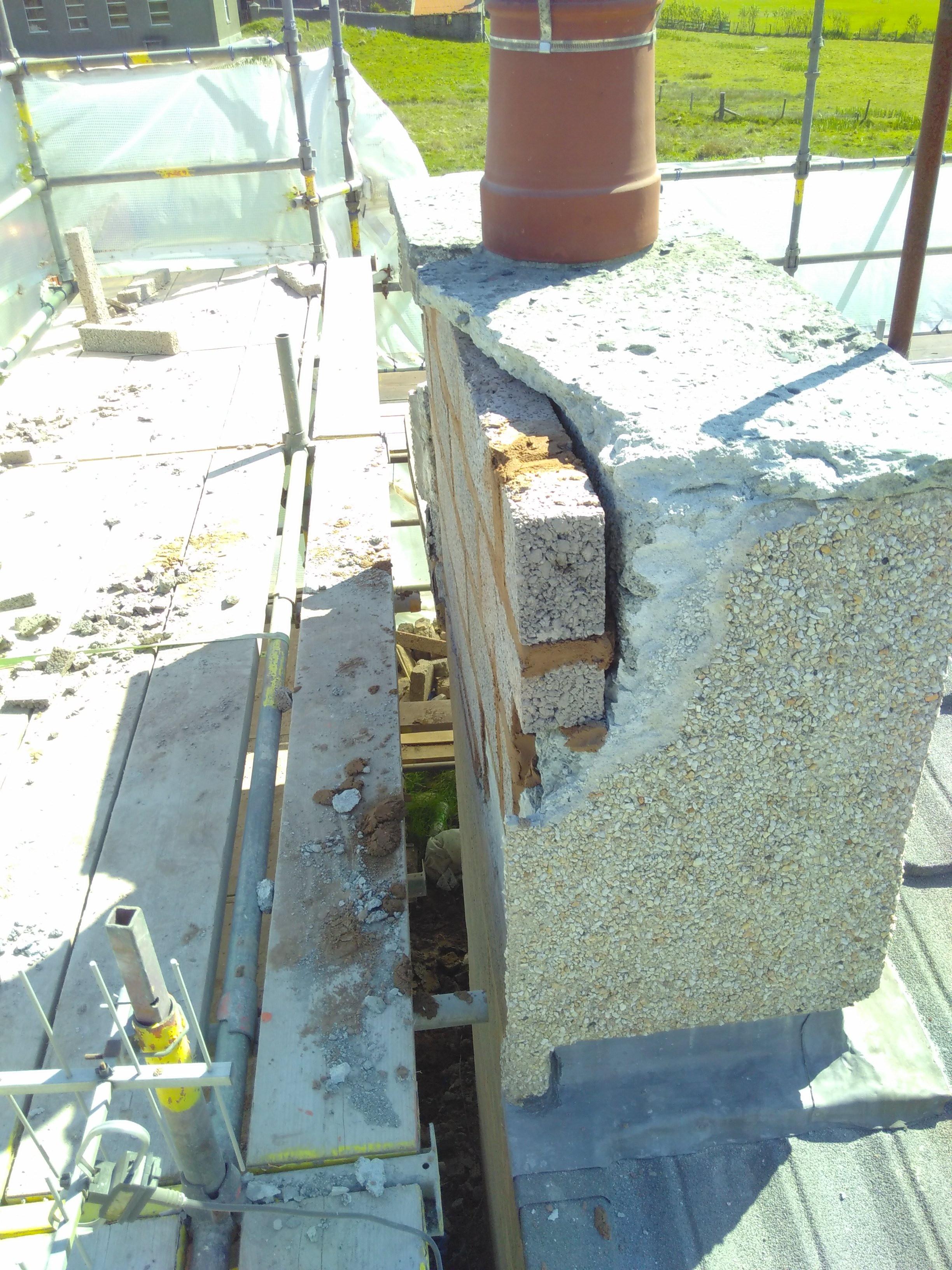

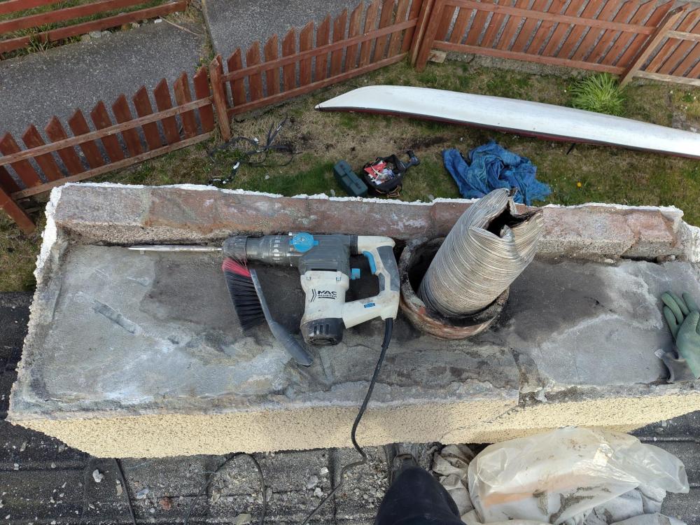

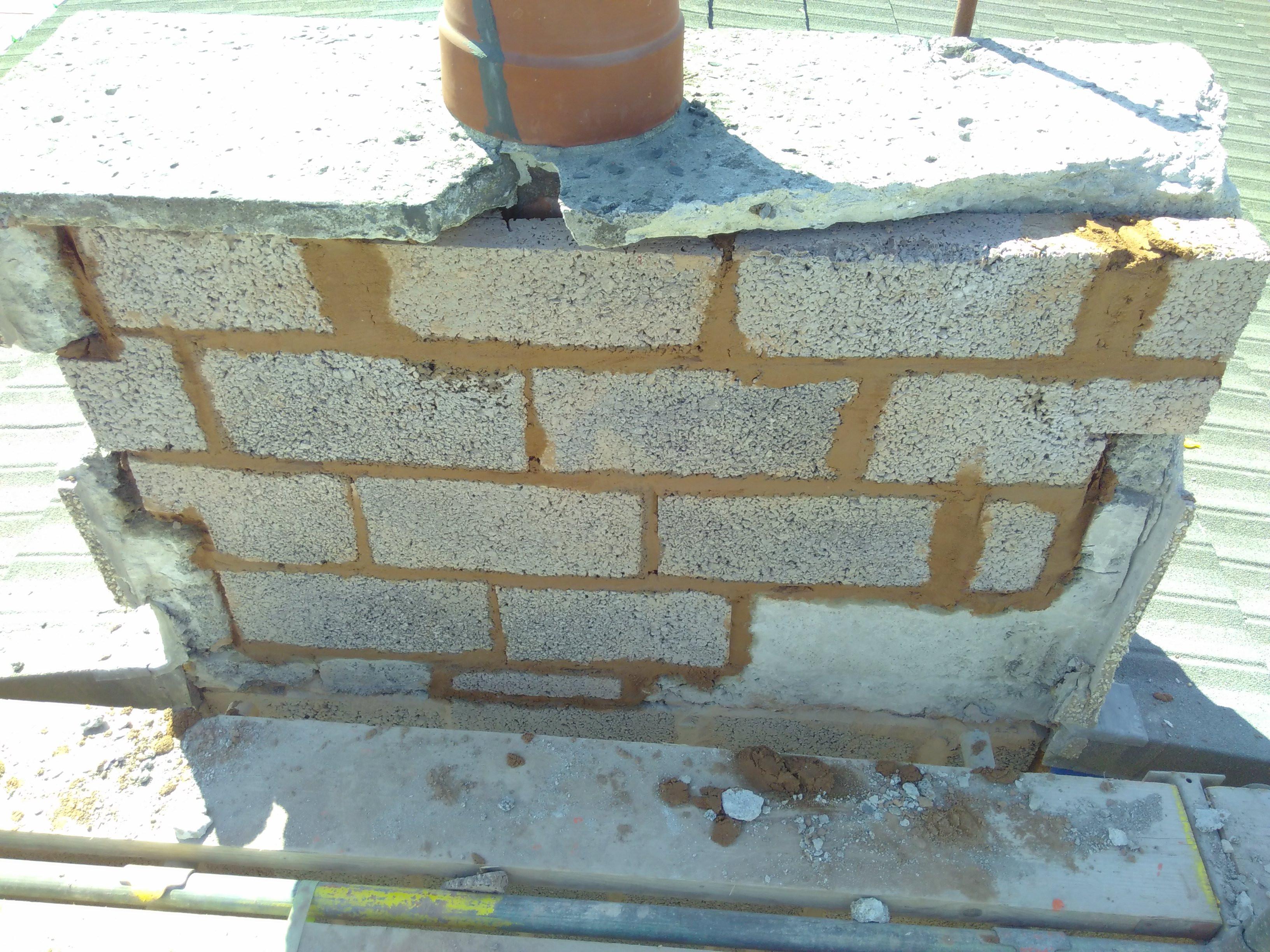

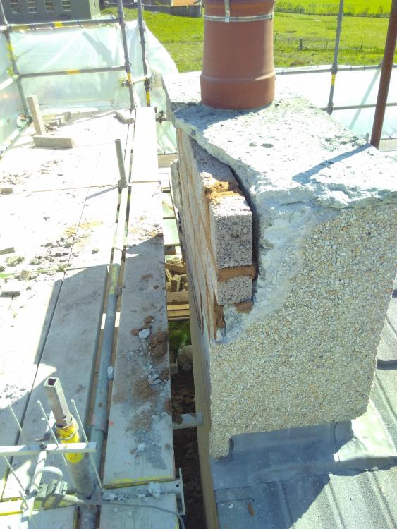

Nick Thomas Posted April 29, 2024 Author Share Posted April 29, 2024 It's been a while but I'm back up around this weekend - there's a break in the weather and I'm keen to do something permanent to this chimney. I'm reliably informed that the tarp has been ripped to shreds over winter; hopefully the butyl tape I popped over the various cracks has kept the water out, though. I found a few more pics from when the builders rebuilt part of the chimney stack, chasing leaks and rotten block - back in 2021: Judging from the courses of blocks, I'm looking to take down ~1.2Mx0.6Mx1M of assorted concrete fun?, which is apparently about 1½ tonnes. Bit by bit, for sure. I've got an angle grinder and a hammer drill to go at it with. In my head, I've allocated ~2 days to the demolition and ~3 to making good, but it's strictly a guess. It's just me and a ladder, so I'm going to need to be veeeery careful. I'm still on the fence between just taking it down to below the cracked portion and casting something like a chimney crown - only without a flue - over the top, vs. going below the roofline, then making good the roof over the top of it. Commentators above (and thanks for the input) were keen on the latter, but I'm a little stressed about the possibility of demolishing to that level, then failing to build a decra roof "patch" over the ex-chimney, either correctly, or at all. That said, the crown approach seems pretty complicated - I found https://www.concreteconstruction.net/_view-object?id=00000154-22df-db06-a1fe-73dff6220000 which talks about the process some. Obviously, hard to say without seeing what's *around* the chimney, under the roof tiles, but am I just psyching myself out here for no good reason? Link to comment Share on other sites More sharing options...

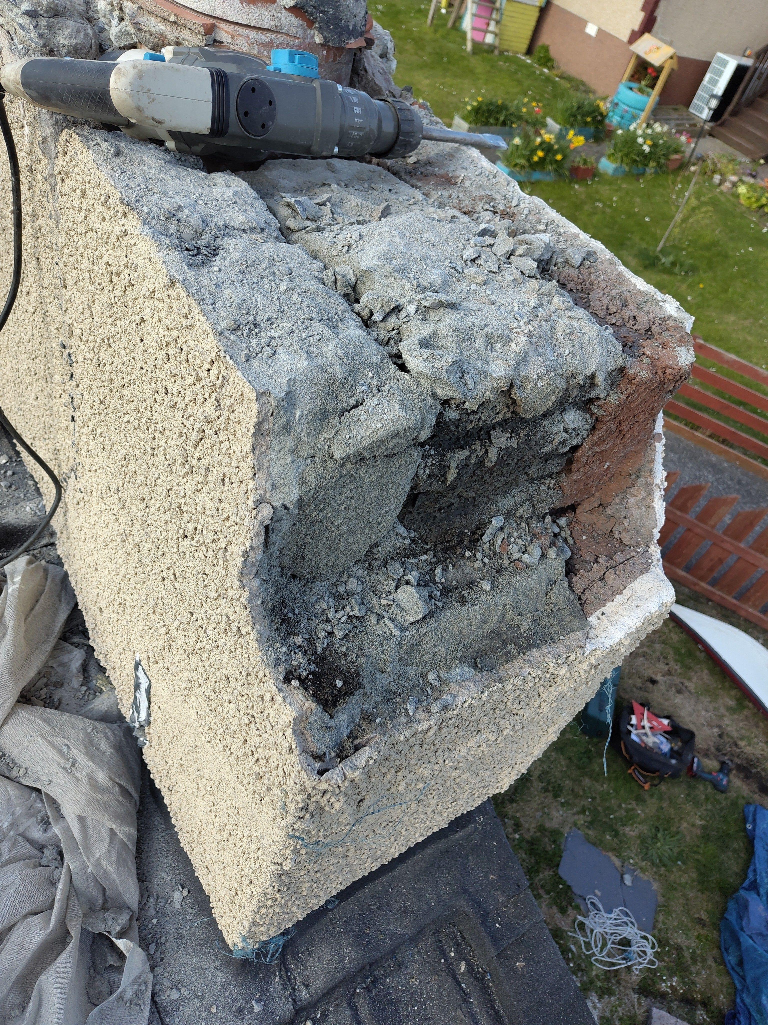

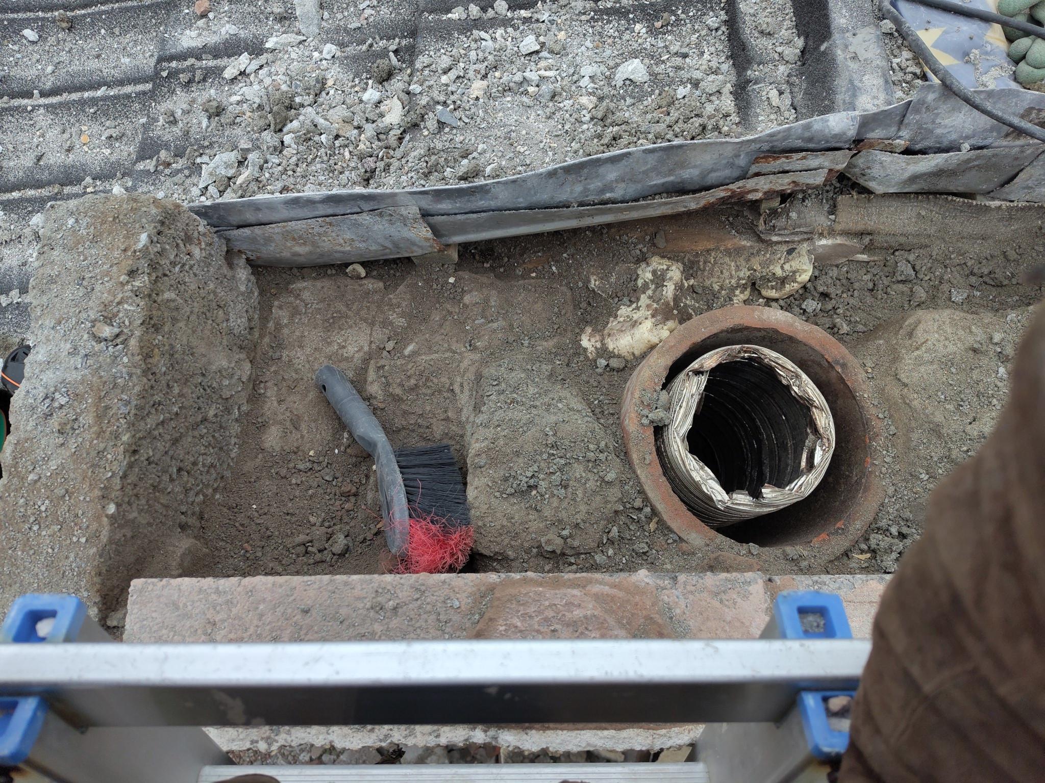

Nick Thomas Posted May 3, 2024 Author Share Posted May 3, 2024 OK, I'm up and making some progress. I wasn't really expecting another chimney crown a third of the way down, but it made a decent place to finish for today. Same again tomorrow; I should be able to get to the roofline if I stick at it. I'm told it only takes 2-3 weeks for decra panels to arrive once ordered, so I'm definitely not rebuilding the roof- I was hoping they held small quantities in stock. Ah well. I'll pour yet another chimney crown instead. Link to comment Share on other sites More sharing options...

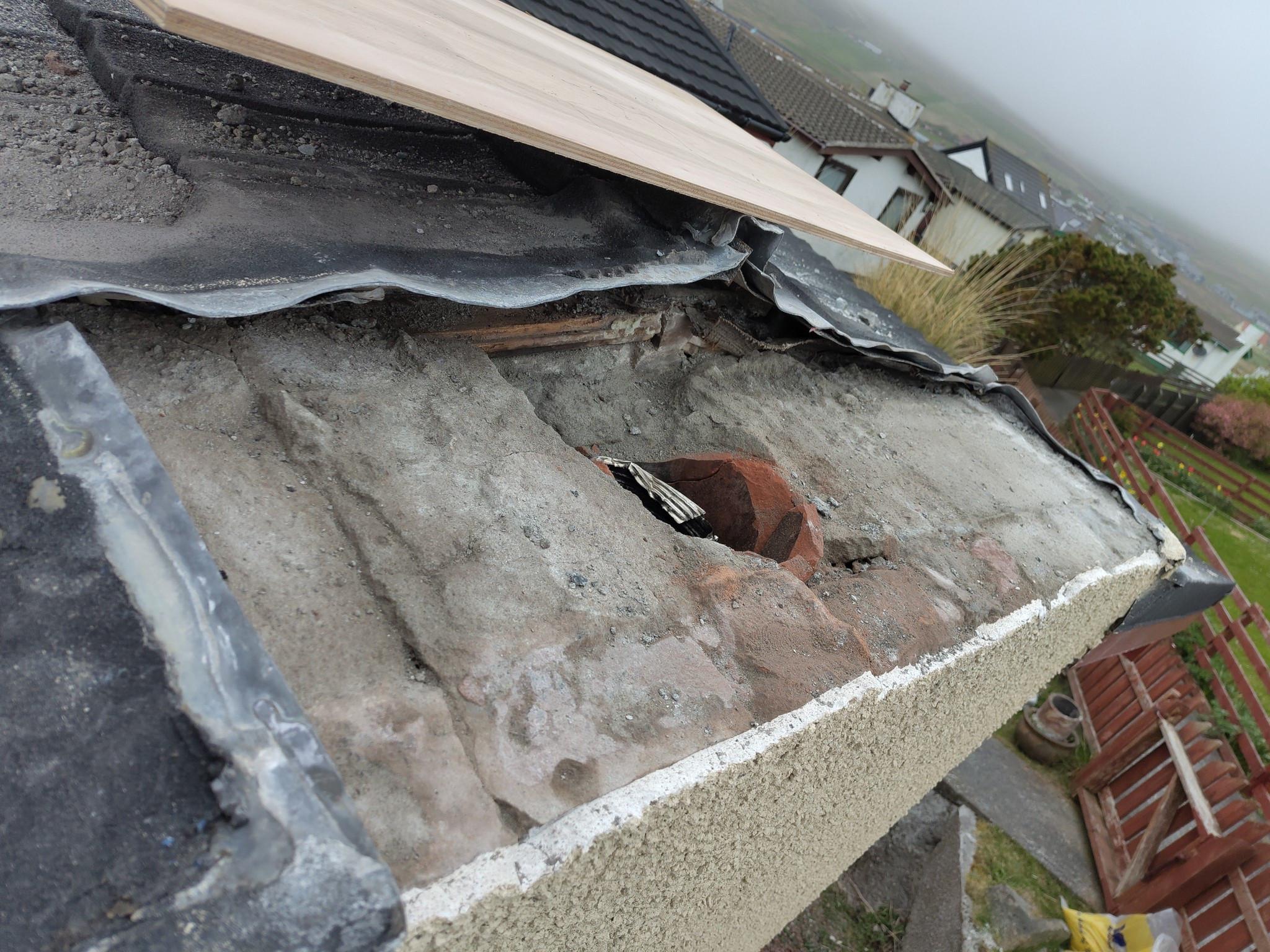

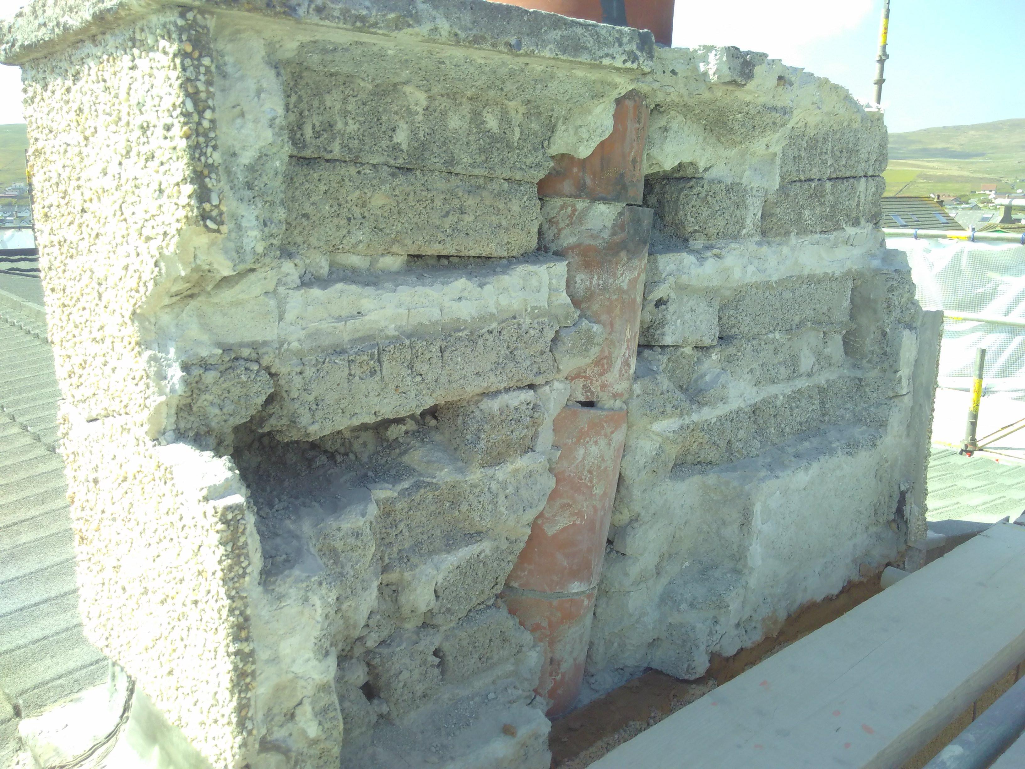

Nick Thomas Posted May 4, 2024 Author Share Posted May 4, 2024 OK, the stack is gone. I ended up going down one course further than I wanted though, as the blocks on the inside face were completely rotten - they crumbled away as I removed the blocks on top of them - so I'm kind of in no-man's-land, height wise. Too low to easily cast a crown, too high to rebuild the roof, even if I had the parts. Fun fun. Yup, that's expanding foam - making up a good chunk of one of the block that crumbled away, and the one below, bless it. The top of the roof deck is just visible; it's above the surface near the ridge line, but then dips down below. If I try to cast something, I'm struggling a bit with the form - it'll have to come up flush against the lead, and then have an overhang past it to keep the water out, and needs to be at least 50mm thick everywhere. Tricky, but... doable? I suppose I could lay some block to get some height, then cast over that, but presumably I'd need to leave several days between the two stages? I could dig out yet more block and try to extend the wooden roof, but I really don't have the parts 😬. Big sheet of lead and a hammer? 1 Link to comment Share on other sites More sharing options...

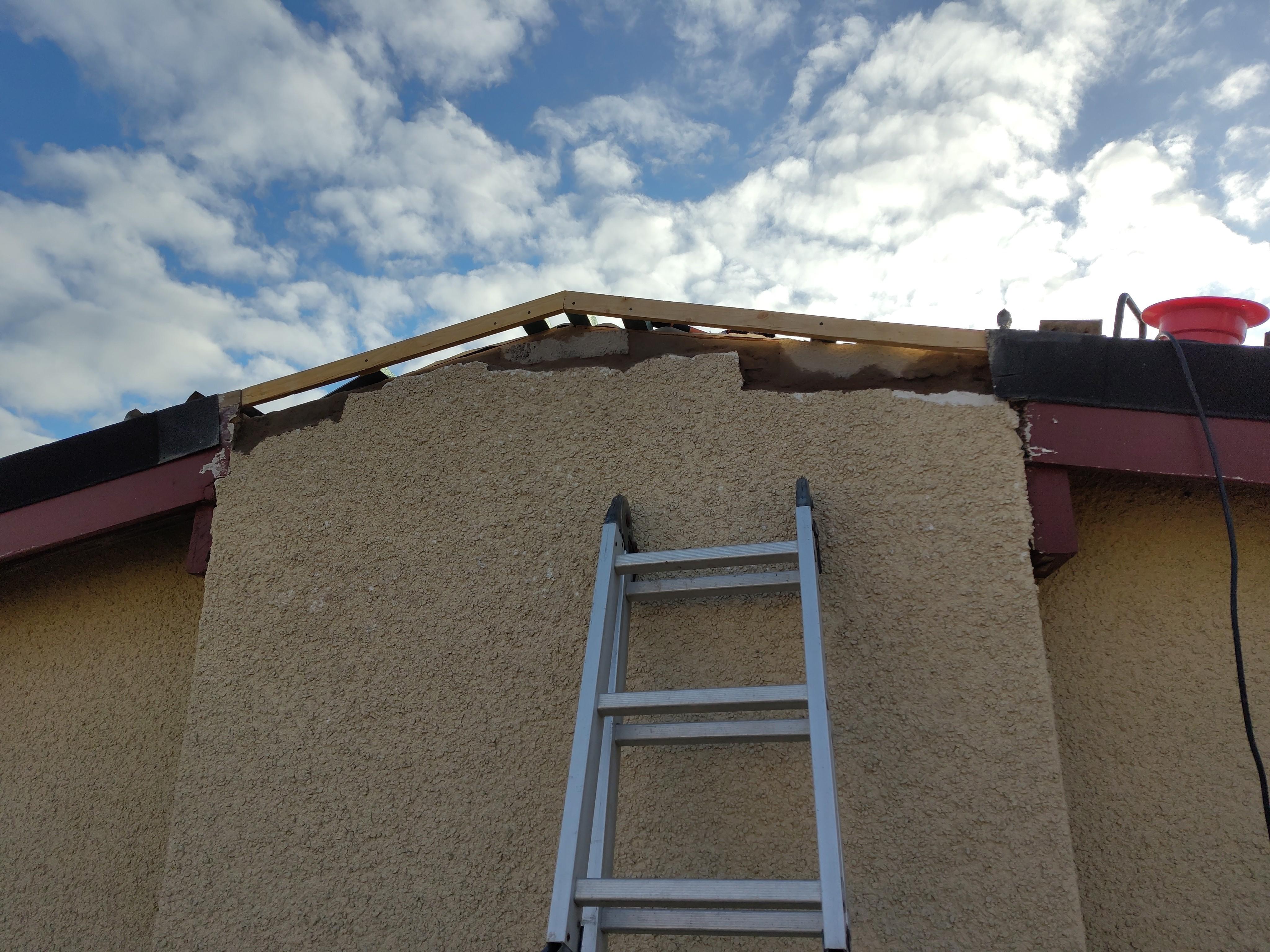

Nick Thomas Posted May 5, 2024 Author Share Posted May 5, 2024 I rather liked the artist impressions - especially back when they were watercolours! I spent the day fiddling with mock-up formwork and not really getting anywhere; the height requirement is just so impractical, I think the concrete requirement was up from 80 ->240kg or so. Fortunately, a neighbour with the same roof system happened by and just happened to have a stock of spares, so I've got a new plan A: 1. Get some timbers and battens put together, fastened to the blocks making up the outside of the stack - those are new and not crumbly at all. 2. Nail the decra into place 3. ??? 4. Celebrate Still working on 3, as I don't have the ridgepole-shaped bits or the edge trim bits, but even if they end up being lead, there'll be a lot less of it than my original plan C! The island life is great sometimes, it really is. Link to comment Share on other sites More sharing options...

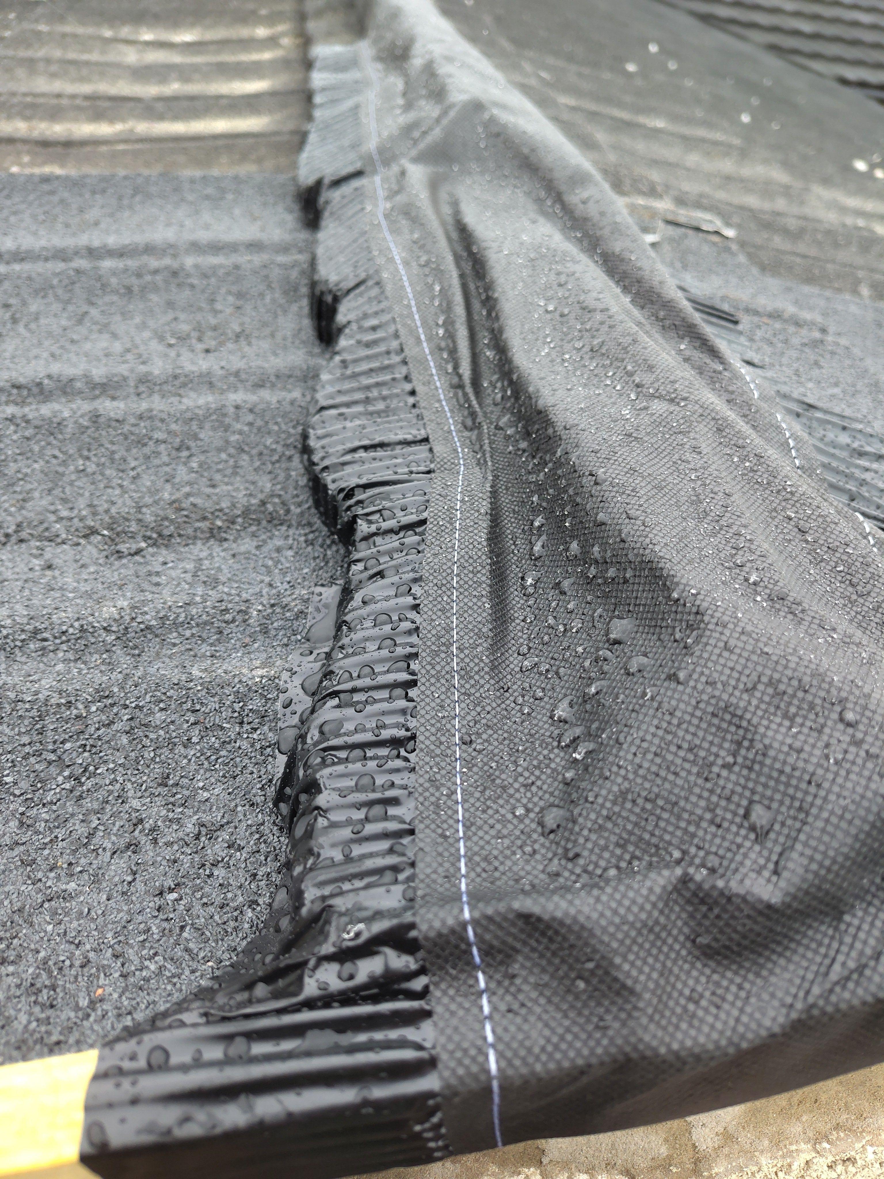

Nick Thomas Posted May 7, 2024 Author Share Posted May 7, 2024 1 done, working on 2 ^^. For 3, I've grabbed a "timloc dry ridge kit". I'm not very interested in most of it, but it comes with a nice membrane with sticky stuff either side that can pretend to be the ridge *and* edge trim - hopefully. If not, I've got lots of offcuts of panel, I suppose I could try to fabricate the required bits. Turns out lead is absolutely not wise to use on these metal roofs, due to the risk of bimetallic corrosion. I could really see it when I took the chimney flashing off, too - rust everywhere. We're pretty close to the sea, of course. Link to comment Share on other sites More sharing options...

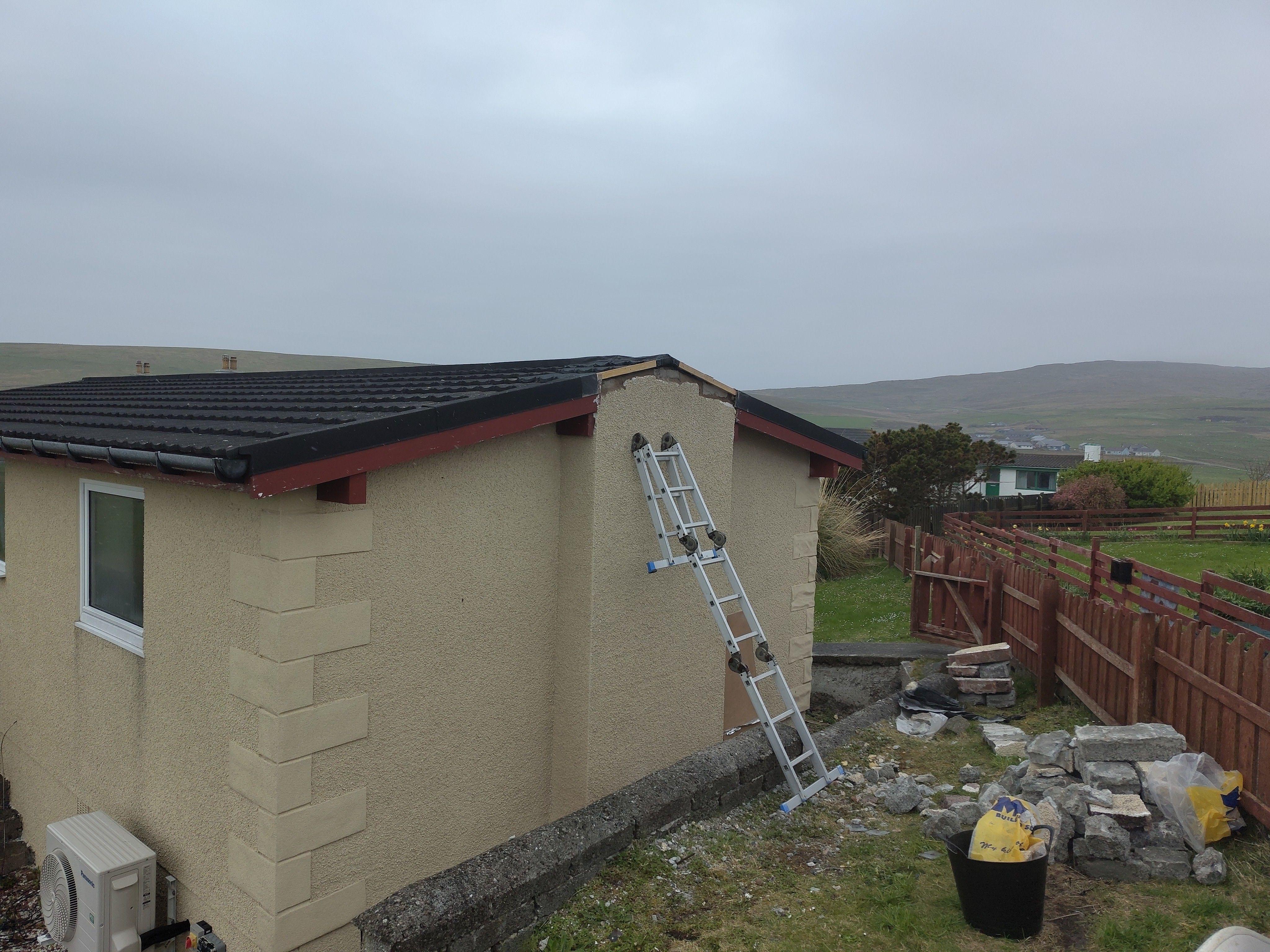

Nick Thomas Posted May 7, 2024 Author Share Posted May 7, 2024 Oh, turns out it's not decra - it's metrotile. Seems to be more or less the same stuff though. Link to comment Share on other sites More sharing options...
Nick Thomas Posted May 8, 2024 Author Share Posted May 8, 2024 OK, I'm watertight - and it is very conveniently raining, so I'm just sat waiting to see if I get a leak or not . The dry ridge membrane is less sturdy than I imagined, but in fairness it's designed to go under a real ridge, rather than being the ridge itself. I'm happy enough leaving it like that until I can get back in the summer with the real metal pieces, though. The bargeboard is really just a placeholder, below that very skinny wood will go some 8x1, and if I'm lucky that might hide all the missing render - if not, there'll be a small patch to reinstate. Since i need to cut away some of the other render to install it, I won't be getting to it on this trip either, but I'm happy to call it a success overall. Take that, chimney! 1 Link to comment Share on other sites More sharing options...
