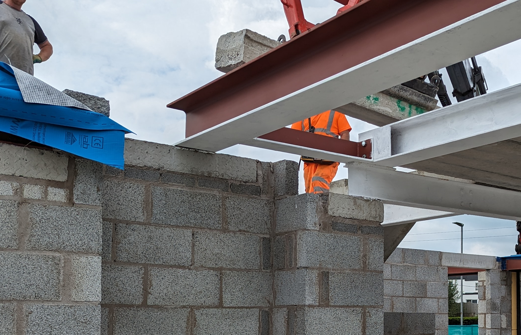

Mr Blobby Posted June 28, 2023 Author Posted June 28, 2023 Structural Engineer has got back to me about this RSJ (and some other things hence the delay). He says the bearing is "a bit short". He says it works in calculation at 210mm but if replacing the steel then he advises 250mm bearing to give some additional capacity. He has suggested an alternative to replacing the RSJ may be to weld a piece on at the end. Glad I checked this🧐
saveasteading Posted June 28, 2023 Posted June 28, 2023 (edited) 20 minutes ago, Mr Blobby said: weld a piece on at the end. A very heavy piece, or it will just bend. I think SE should be telling you this.eg what thickness of plate and what weld. Good to get an answer though. Edited June 28, 2023 by saveasteading
Mr Blobby Posted June 28, 2023 Author Posted June 28, 2023 1 minute ago, saveasteading said: A very heavy piece, or it will just bend. I think SE should be telling you this.eg what thickness of plate and what weld. I'd assumed the same cross section as the one installed. I'll ask...

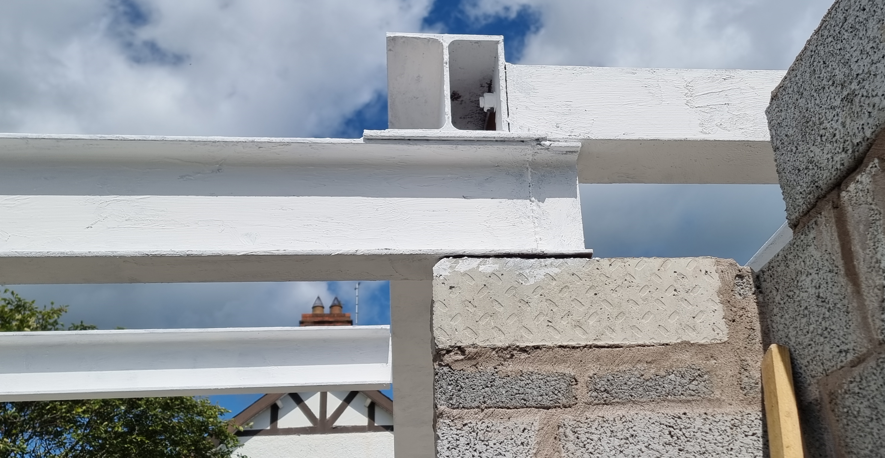

Mr Blobby Posted July 22, 2023 Author Posted July 22, 2023 On 27/06/2023 at 18:12, saveasteading said: Do you have calculations based on the steel sections? Yes, the paint company had the steels plan and calulated the required quantity. On 27/06/2023 at 18:12, saveasteading said: But will these beams be on show? No On 27/06/2023 at 18:12, saveasteading said: A steel needs to get to about 300°C to fail. Where will that fuel be coming from? Isn't there a ceiling? I agree, I think the paint is probably a waste of time but building control like to see it. ..Painting wasn't as bad as I expected. But then after reading all the comments here, I was expecting it to be hellish. 😬 Yes its thick and hard work but my builder actually pitched in to halve the pain. Which was nice of him. And here's the finished beam, with a bit welded on to take it over the middle of the padstone and beautifully painted. 🤗 2

jon-lee Posted July 23, 2023 Posted July 23, 2023 (edited) On 26/06/2023 at 18:47, ETC said: Look at the specification on your SE drawing. You won’t get an answer here. On 26/06/2023 at 17:11, Mr Blobby said: I think steel beam marked with 2300 should be longer so that it is supported by more of the padstone. Should I get it swapped out? in most design there's no right or wrong providing it structurally stable. IMO the bearing is more that adequate. What id be concerned about is steel to the left bearing onto it as the pic shows that the far left steel is cantilevered by a pinned connection (im assuming that blockwork will be built up to support??) personally id of extended the 2300 beam to support the far end beam but thats just me Edited July 23, 2023 by jack Moved text out of quote

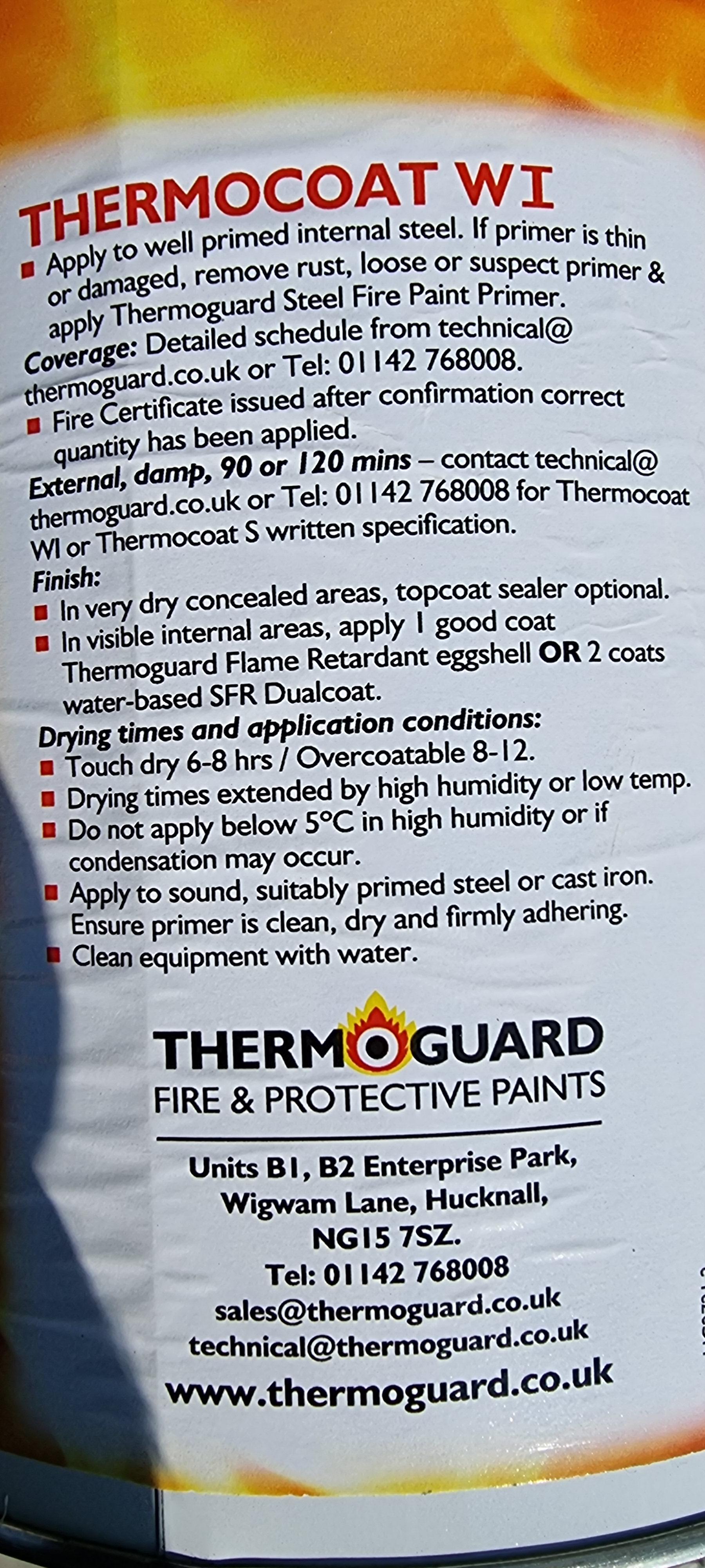

Mr Blobby Posted July 23, 2023 Author Posted July 23, 2023 (edited) 18 hours ago, saveasteading said: How many voats was that? Have you applied the same manufacturer's seal coat? One coat. My builder laughed when I asked if it needed a second coat. On the tin it said the sealant was optional. AFAIAA the BCO has never questioned the paint, as long as he can see it. 10 hours ago, jon-lee said: What id be concerned about is steel to the left bearing onto it as the pic shows that the far left steel is cantilevered by a pinned connection (im assuming that blockwork will be built up to support??) I'd be concerned about that beam being cantilevered too! I can see that's how it looks from the picture above, with a body hiding the detail. This picture shows it better, witht the steel supported, taken from a differnent angle: Edited July 23, 2023 by Mr Blobby
saveasteading Posted July 23, 2023 Posted July 23, 2023 3 hours ago, Mr Blobby said: My builder laughed when I asked if it needed a second coat. OK, so it's not going to fail in fire. My original point here was that it may not need any coating. But the builder laughing isn't great. The same one who fitted the beam? The amount of paint required is usually measurably thick, such that most people choose an alternative, or ignore the instructions. I have never known a bco check the thickness physically or by counting tins, so I think this is deliberately avoiding responsibility. If you have any paint left, it is fun to apply it elsewhere and low torch it. That's the first time I've heard of the seal coat being optional, that is quite an advantage. What brand is it?
Mr Blobby Posted July 23, 2023 Author Posted July 23, 2023 5 hours ago, saveasteading said: That's the first time I've heard of the seal coat being optional, that is quite an advantage. What brand is it? This stuff I think. https://www.rawlinspaints.com/home/fire-retardant-paints/steel-intumescent-paint/5227-thermoguard-thermocoat-wi-ultimate.html The tin is in the wheelie bin. I'll go and check when back on site on Tuesday. 1
Mr Blobby Posted August 4, 2023 Author Posted August 4, 2023 On 23/07/2023 at 17:23, saveasteading said: That's the first time I've heard of the seal coat being optional, that is quite an advantage. What brand is it? Here's that paint tin. It says the sealer is optional if the beams are in dry concealed conditions. They will be dry at some point, but not during construction.
