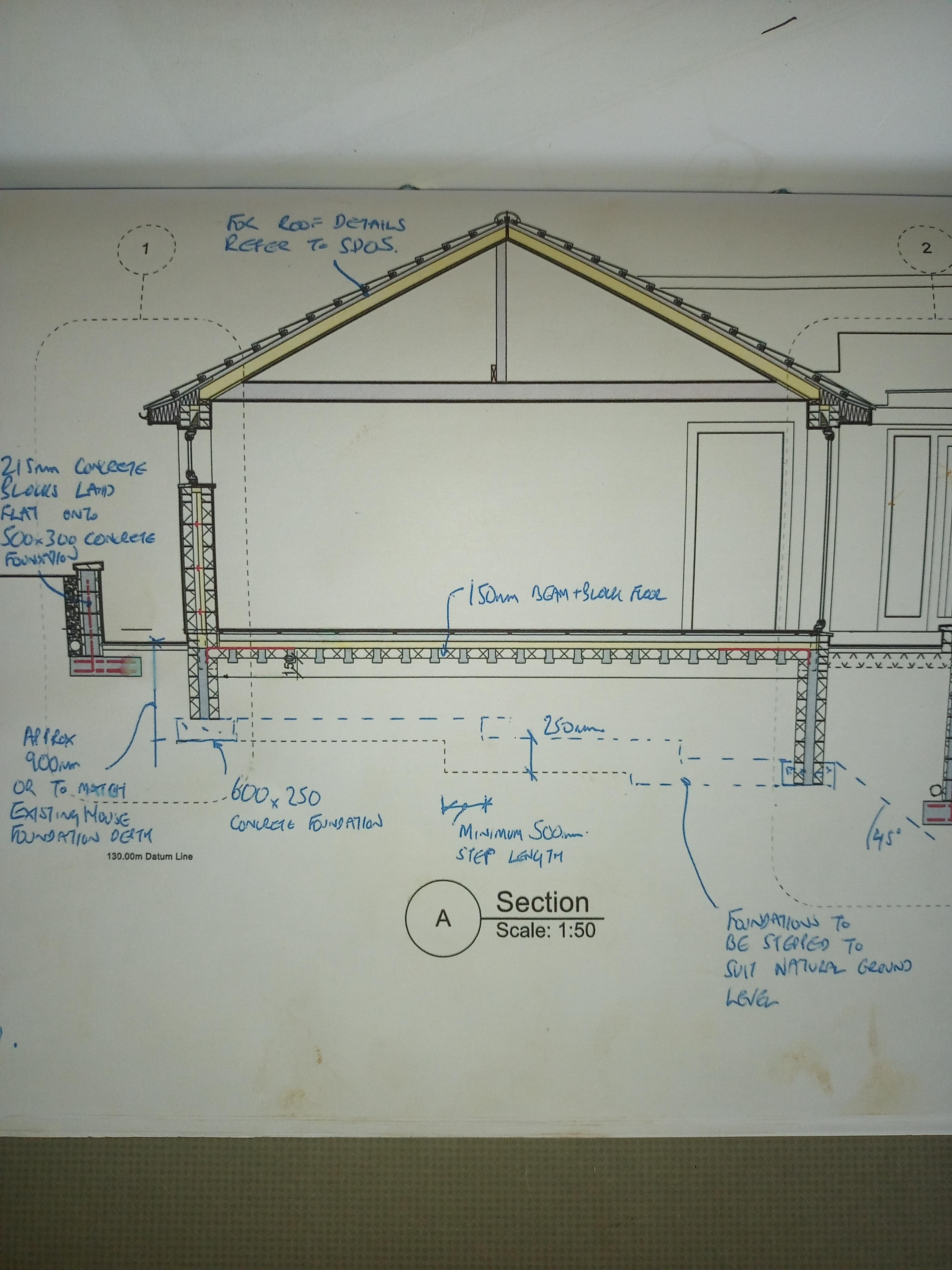

Todd Posted June 25, 2023 Posted June 25, 2023 Hi, First time post, so sorry if this is a daft question Currently building a single storey extension.Site is sloping downwards meaning with have a stepped footing . 2 steps , dug out to correct depth , overlap etc. As access is tricky, we will a line pump. We have shuttered sides and risers of steps. Question is ; when we pump concrete, what stops the concrete from finding its own level and effectively acting like a manometer , basically leveling out either side of shutter? Foundation are 8mx6.5 m with steps on the 6.5 m run Hope this makes sense Many thanks..

Todd Posted June 25, 2023 Author Posted June 25, 2023 Hi, many thanks for the quick and clear replies.. To answer some questions. 1) myself and three other on site , 3 are family builders. I am householder and acting labourer 2) the builders have experience of pumped concrete and the pump guy they use is doing a site visit before pour. Not sure builders have done a stepped pour before. 3) footings are min 250, so we have two steps at 500 ( min ) 4) SE design and full plan approval for BC 5) building control have visited site We are using 18 mm ply with 90x40 mm bracing to hold sides.( Photos to big to upload).. I think it's a simple (?) job .,but my engineering background questions why the wet concrete doesn't find it's way under the step shutter and become a equal height throughout the trench.. Thanks again for your time and help.. 1

Todd Posted June 25, 2023 Author Posted June 25, 2023 Hi, thanks again for your help. 1) to get height, builder will use laser to get line, then spray paint line all way round on inside of shutter. 2) access lane to house is tight..too narrow for mixer , everything is offloaded about 100 yrds away. There is no way to get mixer on drive.. so options of dumper, but hard to pour due to slope or pump. 3) total volume for day is approx 14m3 , stepped part of foundation accounts for 6m3. Connor, Idea of putting weight on lower part is to counteract upward pressure of concrete trying to raise up ? Thanks...
