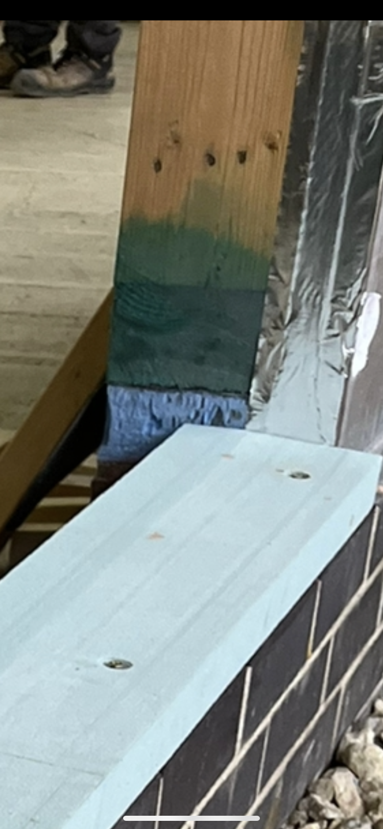

I’m currently on a SIP’s type build (TF with 140mm PIR infill) and Marmox was the obvious choice there, plus under the large sliders. Also for the rising intermediate internal walls. All of these are significant cold bridges.
IMO you should 100% go with this detail, with the top of the Marmox finishing above ToC, but I am assuming this is not on a raft foundation?

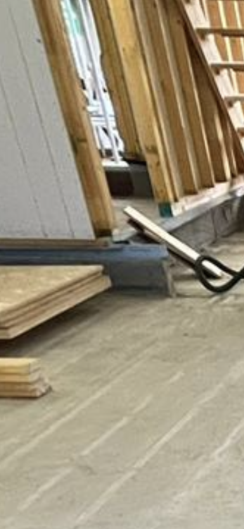

Yup. Pretty much what is on site at this project.
30mm PIR upstands against kicker blocks, and Marmox on top / immediately under TF sole plate.
AT tape starts at 1st 100mm layer of PIR and then top layer and joints taped / foamed again for belt and braces. Internal AT membrane then comes down and gets taped to the tape already on / across the Marmox blocks.
PIR updstands hidden by internal service battens + PB + skim.

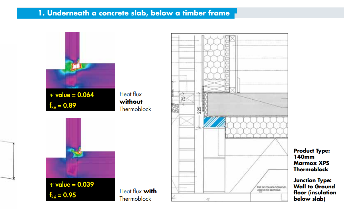

Do you have a drawing you can post of the current design?
Yup, agreed. Sectional drawings would help, as we’re currently drawing conclusions from what info is available here.

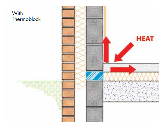

here is what i am using albeit with block and beam but its the same.
the full guide is here https://www.marmox.co.uk/uploads/catalogue_gallery/33/datasheets/ThermoblockTechnical2019.pdf
