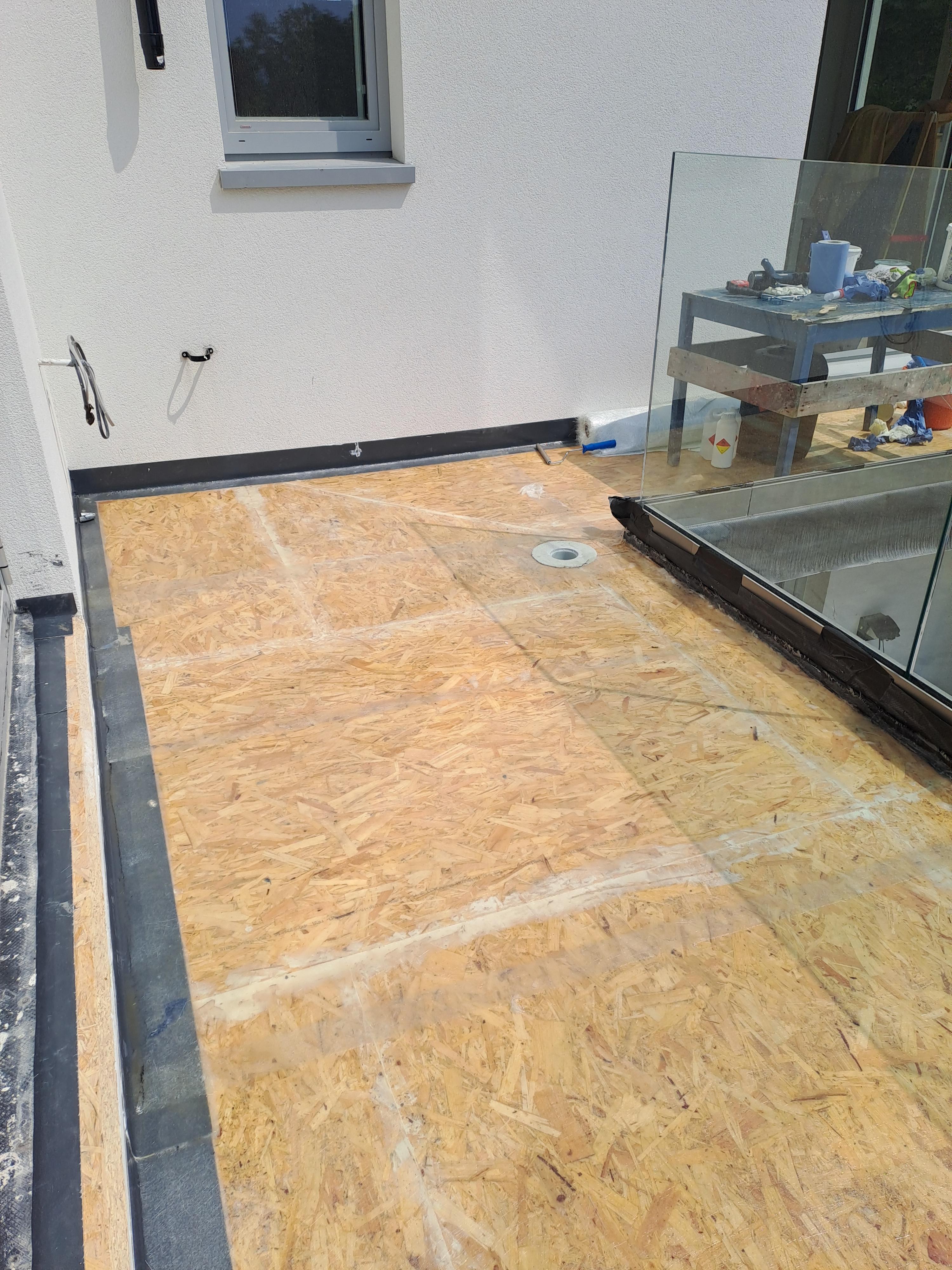

Conor Posted June 11, 2023 Posted June 11, 2023 (edited) Boarding out our deck for tanked balcony this afternoon. Had to give up as just too damn hot, no shade, no breeze. Forecast is for 25-27c all week, little cloud, no breeze. Did a quick Google and apart from using less catalyst, any issues with fibreglassing in this weather? With the direct sun I'm sure surface temp will be 40c+ as direct south facing and sheltered Edited June 11, 2023 by Conor
SteamyTea Posted June 11, 2023 Posted June 11, 2023 11 minutes ago, Conor said: Did a quick Google and apart from using less catalyst, any issues with fibreglassing in this weather? With the direct sun I'm sure surface temp will be 40c+ as direct south facing and sheltered Will give you problems as too little catalyst (really an oxidant) will stop proper cross linking of the monomers. You can get different hardeners to get round this problem. Your biggest issue will be UV light, that caused the top to react and cure faster, this stops the excess styrene evaporating away. If you can be sure it will be dry early morning, that is the time to do it.
Conor Posted June 12, 2023 Author Posted June 12, 2023 Thanks. For the catalyst it's a pre assembled kit so don't think there's much choice, but I'll speak to the supplier today. Was just thinking using 1% catalyst rather than the usual 1.5-2% I would have used previously. I'll try and get most of the work done in the mornings to avoid the direct sun.

SteamyTea Posted June 16, 2023 Posted June 16, 2023 5 minutes ago, Conor said: So was up at 5.30am this morning... Job done Pictures please. And not just of your sticky fingers.
Conor Posted June 16, 2023 Author Posted June 16, 2023 Not until the top coat is on and flashings on! All you can see is the OSB deck through the grp. Which means it was done right I suppose. I did 2% catalyst when it was still cool, down to 1.75% when the sun started hitting. Had about 15mins working time only. Few spots it got away from me that resulted in a few lumps and bubbles. Will need a bit more work. Many rollers and brushes in the bin now.
SteamyTea Posted June 16, 2023 Posted June 16, 2023 (edited) 10 minutes ago, Conor said: I did 2% catalyst when it was still cool, down to 1.75% when the sun started hitting. Had about 15mins working time only There are very few job that once started, you really cannot stop, resin work is one of them. As you can see the OSB though the GRP, it seems like you went for a resin rich layup, which is a good thing. I am sure you can sort the lumps and bumps out easily enough with an angle grinder and some extra mat/resin. A topcoat always makes thing look better. Edited June 16, 2023 by SteamyTea
Conor Posted June 16, 2023 Author Posted June 16, 2023 1 hour ago, SteamyTea said: There are very few job that once started, you really cannot stop, resin work is one of them. As you can see the OSB though the GRP, it seems like you went for a resin rich layup, which is a good thing. I am sure you can sort the lumps and bumps out easily enough with an angle grinder and some extra mat/resin. A topcoat always makes thing look better. 2.5kg m² rather than the reccomended 2kg. 2
