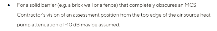

The cost of accoustic screens/enclosures for ashps is quite out of proportion, this needs to come down by a factor if 10.  I'm surprised ashp manufacturers haven't done something in this space (I think I read somewhere that Daikin have).

On 08/06/2023 at 23:54, sharpener said:
Can you provide a link to the specific enclosure you have in mind? Do they warrant its performance with your particular HP and what dB reduction do they state it will achieve? Also how does it vary across the spectrum?
