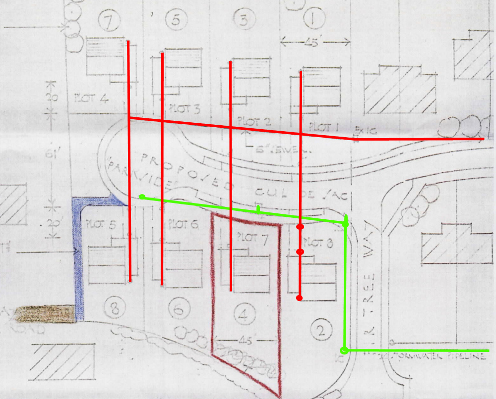

Mattg4321 Posted June 7, 2023 Share Posted June 7, 2023 Following on from my other thread re foundation design near a large oak tree, I will also need to think about dealing with rainwater from the extension. I'm told a soakaway is not possible, because it will either be too close to the oak tree, the extension, or the boundary. This seems like it's probably true, but is there a set distance a soakaway must be away from a building/oak tree/boundary? I'm not sure what the current setup is, but I'm pretty sure it's not a combined drain. Property was built in 1970. A 'stormwater pipeline' is shown on the planning drawings we have from when the house was built - unfortunately not all that clear. I've not got around to it yet, but we are plot 8 in the picture and the manhole cover shown to the front right of our property is there. I guess I could lift this and pour something in the downpipe to see if that's where it goes. If so, can we just connect on to this same system in general? Architect was going on about having to pay the water supplier a monthly amount to discharge into the foul drains. Something I'd like to avoid obviously! The one shown in our rear garden definitely isn't there however. I've dug out a whole section of ground more than a meter down in this area (don't ask) and found nothing! Thoughts welcome Link to comment Share on other sites More sharing options...

Temp Posted June 7, 2023 Share Posted June 7, 2023 Its not very clear but this was my interpretation of the drawing. Green being the storm pipeline and red being the foul sewer - but the slope of the land might mean I'm wrong. What are the circles that I have marked in red? Are they where you have gutter down pipes or soil stacks? If you don't have any soakaways I suspect you might have a combined sewer. Perhaps see if dye appears at the manhole in red near the cul-de-sac? What I would do is figure out where existing rainwater goes then propose the same to the BCO when you make your Building Control Application. Normally they want a drainage diagram so I would get one drawn up and write on it something like.. "Surface water drainage connects into existing surface water drainage system at this point". Then see what the BCO says. He might just accept it. PersonaIly I would avoid asking the BCO a specific question about it. In my experience you don't ask a policeman "Are you going to give me a ticket for going 79", you just say good evening and let them decide if they are going to give you words of advice or a ticket. 1 Link to comment Share on other sites More sharing options...

Mattg4321 Posted June 8, 2023 Author Share Posted June 8, 2023 (edited) Thanks for the advice, the red circles you have drawn are foul drains manholes. I think there is also a dotted line connecting to the storm water drains (in green on your drawing) from each property. Just to the left of the red line leaving my property. I’m going to try and lift the ‘green’ inspection chamber to the front right of my property in the next few days. Is it possible that my downpipes eventually connect to this (along with presumably the rainwater drains from the side of the road etc)? Edit, on second thoughts, that could just be the driveway being shown! Edited June 8, 2023 by Mattg4321 Link to comment Share on other sites More sharing options...
