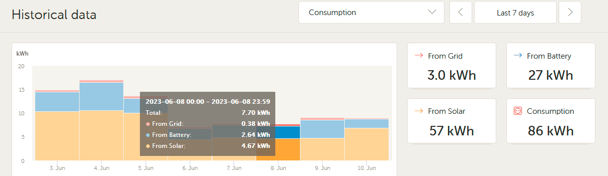

SteamyTea Posted June 10, 2023 Posted June 10, 2023 I would think if I had PV there would currently be days when I literally import nothing at the moment.
sharpener Posted June 10, 2023 Posted June 10, 2023 1 hour ago, SteamyTea said: I would think if I had PV there would currently be days when I literally import nothing at the moment.
