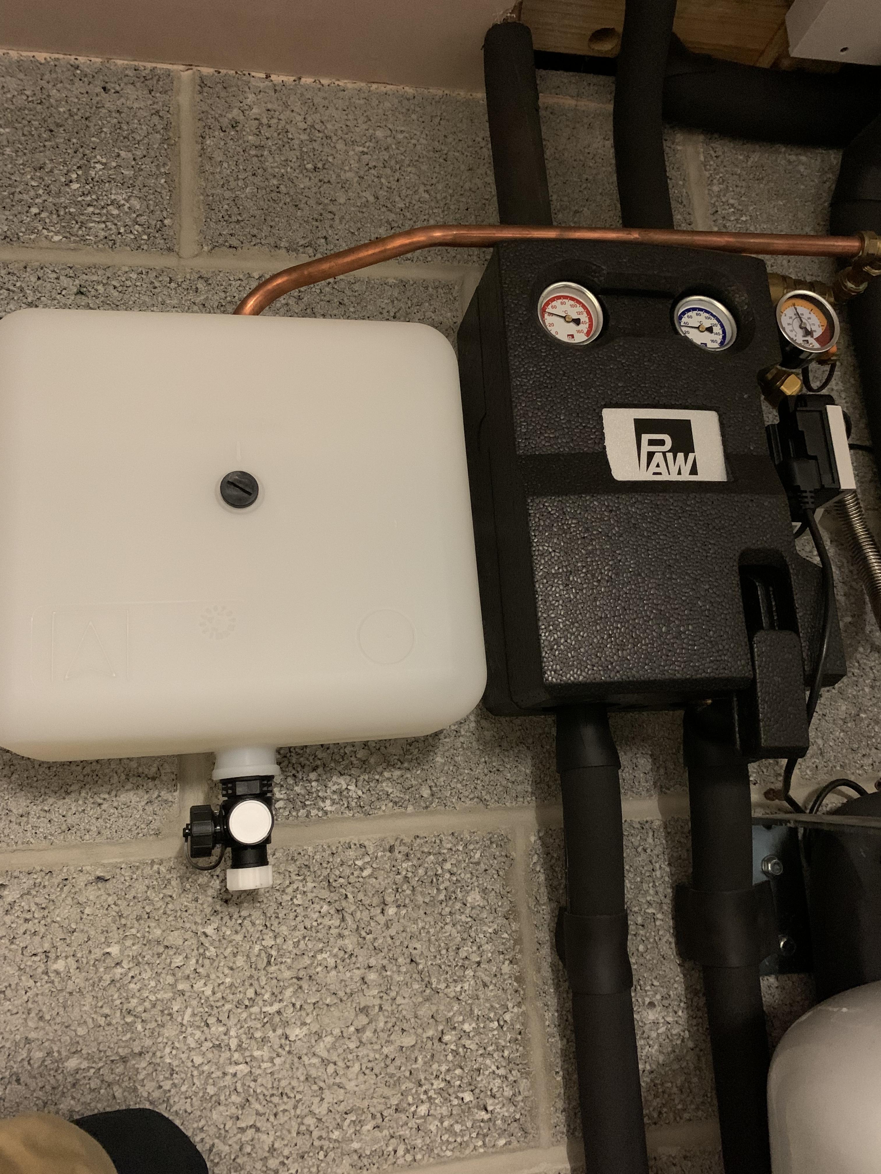

Chriswills Posted June 4, 2023 Share Posted June 4, 2023 https://www.resol.de/Produktdokumente/11204293_DeltaSol_CS4.monen.pdf I have the above Resol solar controller, everything works fine until the tank reaches its max setting at 70 deg. Once the pump is then switched off the temperature on the roof goes up to about 170 deg C and the pressure goes up to over 6 bar. The warning icon flashes then too. Is there a way to cool the collector or is this normal? Link to comment Share on other sites More sharing options...

Chriswills Posted June 5, 2023 Author Share Posted June 5, 2023 I just upgraded the tank to a 300 litre from 200. There are settings which allow it to cool the collector and the store but i don't know how to set it up. We have the pressure valve and drain off all set up so good there, just worries me to see 6 bar plus on these very hot days Link to comment Share on other sites More sharing options...

Chriswills Posted June 5, 2023 Author Share Posted June 5, 2023 (edited) 2 hours ago, dpmiller said: At 70c you must have a tempering valve on your tank to protect users, so why not just increase store temp to 80c or more? Is this a drainback system? How many sensors are connected? what is the setting for EM, collector limit? EM is set at 130 sensoe on roof and one on tank. drainback installed ive been told not increase it anymore in temperature! Edited June 5, 2023 by Chriswills Link to comment Share on other sites More sharing options...

dpmiller Posted June 5, 2023 Share Posted June 5, 2023 ...but hang on, you say it's a drainback system? Are there any valves that have erroneously been shut off that might be restricting that? Link to comment Share on other sites More sharing options...
Chriswills Posted June 5, 2023 Author Share Posted June 5, 2023 Is this a drainback system? Not sure. Link to comment Share on other sites More sharing options...
dpmiller Posted June 5, 2023 Share Posted June 5, 2023 nope, that's just an overflow tank to catch anything from the safety valve. Link to comment Share on other sites More sharing options...
