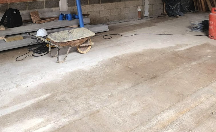

bmj1 Posted June 2, 2023 Posted June 2, 2023 (edited) Hi All, I've found myself with just 120mm of floor build up above Ground Floor block and beam solid concrete floor. I'm trying to figure out what our floor build up can look like to enable us to have underfloor heating, here is where I've got to: 50mm - VIPs 50mm - liquid screed / underfloor heating 20mm - floor A) Can this work ? B) Any recommendations in terms of VIP flooring providers ? Thank you in advance ! Edited June 2, 2023 by bmj1
Dave Jones Posted June 2, 2023 Posted June 2, 2023 (edited) always annoying when the build up below damp isnt designed properly. You will struggle to pass building regs even with 100mm of celotex. can you lose ceiling height ? I think your best option is to remove the blocks and replace with insulated ones. Edited June 2, 2023 by Dave Jones
bmj1 Posted June 2, 2023 Author Posted June 2, 2023 58 minutes ago, Dave Jones said: always annoying when the build up below damp isnt designed properly. You will struggle to pass building regs even with 100mm of celotex. can you lose ceiling height ? I think your best option is to remove the blocks and replace with insulated ones. That's an interesting idea. It actually was designed right, but the implementation was botched... So you are suggesting that we remove the blocks between the beams, and replace with insulated ones. Neat. Any blocks you have in mind ?
Nickfromwales Posted June 2, 2023 Posted June 2, 2023 4 hours ago, bmj1 said: That's an interesting idea. It actually was designed right, but the implementation was botched... So you are suggesting that we remove the blocks between the beams, and replace with insulated ones. Neat. Any blocks you have in mind ? No affiliation, but I quite like this system / offering. Others are out there, but some do not "under-sling" as these do. https://springvale.com/beamshield/
Dave Jones Posted June 3, 2023 Posted June 3, 2023 couple systems if you have a search, you will still have a large area of cold bridging from the beams but it will still be miles better. 50mm celtox over the top / 50mm screed.

Nickfromwales Posted June 3, 2023 Posted June 3, 2023 VIP's will also bankrupt you Knock the blocks out, sell them for hardcore, and insulate with the beam(fill) insulation option(s). You pay for insulation once, and energy to heat for the rest of your life. "Fabric first, people!!". You might want to watch the tyre on the wheelbarrow. Looks like it may be over-inflated. 16 minutes ago, bmj1 said: It looks to me like it is sealed in somehow ? It's a cement based slurry, often referred to as "grouting" the blocks in. Once you get one block out, by destroying it, the others usually can be knocked up and out. Do this by tapping (hitting) them up from the underside with a sledgehammer.
bmj1 Posted June 3, 2023 Author Posted June 3, 2023 (edited) 19 minutes ago, Nickfromwales said: VIP's will also bankrupt you Knock the blocks out, sell them for hardcore, and insulate with the beam(fill) insulation option(s). You pay for insulation once, and energy to heat for the rest of your life. "Fabric first, people!!". You might want to watch the tyre on the wheelbarrow. Looks like it may be over-inflated. It's a cement based slurry, often referred to as "grouting" the blocks in. Once you get one block out, by destroying it, the others usually can be knocked up and out. Do this by tapping (hitting) them up from the underside with a sledgehammer. Sounds good to me. Can anyone recommend alternatives to Beamshield ? Planning to hit the phones hard on Monday AM and would be good to have 2 or 3 companies in mind to tap up for this. I did look at Milbank Warmfloor Pro, but they appear to require 75mm of concrete on top, which is self-defeating in terms of minimising floor build-up... Thanks in advance Edited June 3, 2023 by bmj1
saveasteading Posted June 3, 2023 Posted June 3, 2023 These blocks should knock out upwards easily. There is just a skim of cement slurry by the looks if it. The first block in any row may have to be smashed down. After that I would expect them to come out whole. Then polystyrene or pir placed in between the t beams. They are not terribly strong so I am wondering whether you should first lay some thin board. OR, instead of normal screed, perhaps add steel mesh. I also wonder if a thin layer of insulation can be placed over the whole floor before the screed, to provide z thermal break over the beams. 20mm pir, 60mm screed.??
bmj1 Posted June 3, 2023 Author Posted June 3, 2023 16 minutes ago, saveasteading said: These blocks should knock out upwards easily. There is just a skim of cement slurry by the looks if it. The first block in any row may have to be smashed down. After that I would expect them to come out whole. Then polystyrene or pir placed in between the t beams. They are not terribly strong so I am wondering whether you should first lay some thin board. OR, instead of normal screed, perhaps add steel mesh. I also wonder if a thin layer of insulation can be placed over the whole floor before the screed, to provide z thermal break over the beams. 20mm pir, 60mm screed.?? Honestly, that's a relief to hear ! We're planning underfloor heating, and my preference was liquid screed (I think we can get this down to ~50mm ?). I've got 120mm total to play with above the beam/block floor, minus say 20mm for the floor finish and 50mm for liquid screed.. So room for PIR or some kind of board or potentially both..

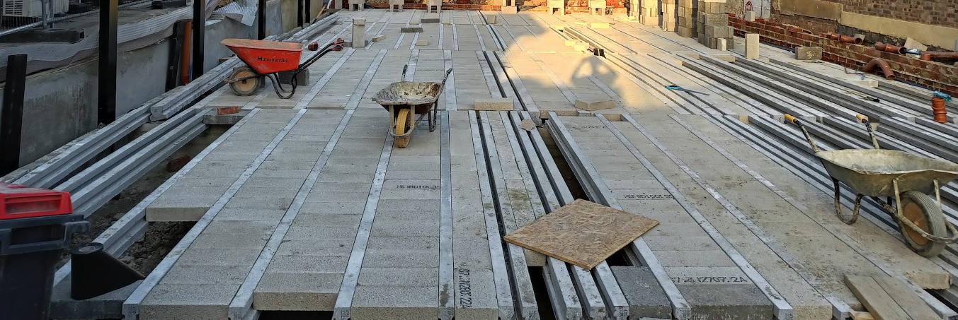

bmj1 Posted June 3, 2023 Author Posted June 3, 2023 Just to add, here is my floor layout (this photo taken 9 months ago when we were at this stage)

bmj1 Posted June 4, 2023 Author Posted June 4, 2023 24 minutes ago, Nickfromwales said: Where are you building? If you don't mind me asking? Are there a lot of load-bearing walls rising? London. Load bearing walls are all on the perimeter. I wonder if they over ordered the T-Beams and didn't have anything else to do with them..
saveasteading Posted June 4, 2023 Posted June 4, 2023 6 hours ago, bmj1 said: didn't have anything else to do with them.. T beams are used close together to support an increased load, so I'd expect to see these are under walls or stair or some such. In which case you would not put insulation at that point.
Nickfromwales Posted June 4, 2023 Posted June 4, 2023 8 hours ago, bmj1 said: London. Load bearing walls are all on the perimeter. I wonder if they over ordered the T-Beams and didn't have anything else to do with them.. Yup, I asked as I don't think I've ever seen so many on one domestic floor before!! I lost count at 15 seemingly unnecessary beams . The problem is, where these are there will be huge thermal (cold) bridges to address, so wondered if any could be cut out. This appears to be a can of worms tbh.
