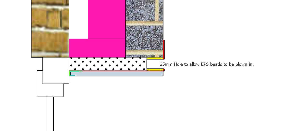

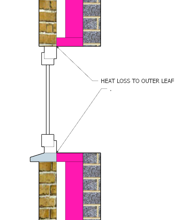

I don't know on the new build if the window overlaps the cavity closer.
Worse case it is like this and the installers haven't done it. The cold outer leaf could be practically "touching" the inside which is a bad thermal bridge.  I suspect in reality they've moved the windows more inboard and this isn't an issue.
However it's still better to cover as much of the frame as practical with some insulation.

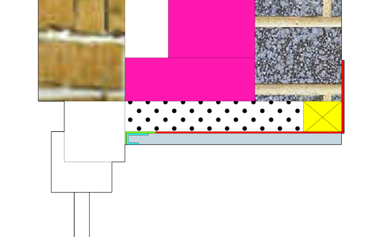

However you'll need to drill a 25mm Diameter through the membrane and batten as shown in each of the four sides of the window to allow your EPS beads installer to give a quick squirt of beads to thermally isolate the windows.
If you want you can drill a few extra holes in the batten only and not the membrane to visually check that it has filled to the corners (it will BTW).
The Hole in the membrane can be very simply patched afterwards with a piece of A/T tape.
Hey presto.
A fully thermally insulated window frame.
ZERO waste of insulation unlike boards products.
A fully gapless install No thermal looping/bypass.
Perfect A/T details.
Exactly consistent frame gaps unlike other methods.
A consistent pallet of very cheap materials.
No need to fight with the window installers.

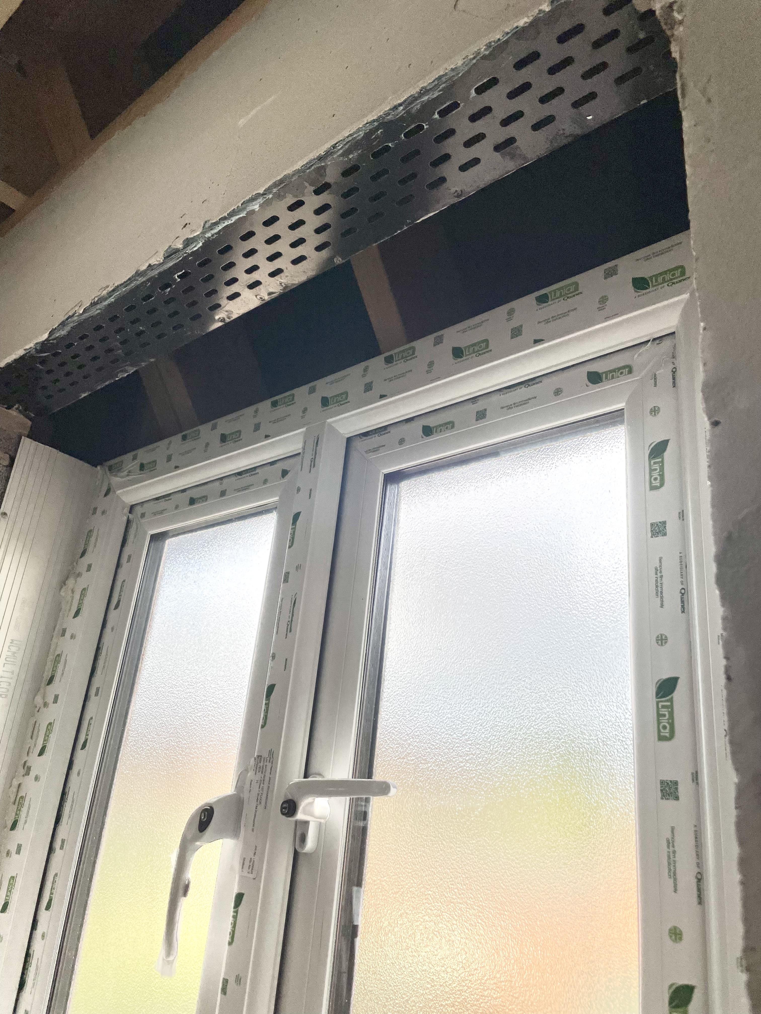

Hi again
I am starting to do some rooms ready for plaster boarding and somehow didn’t spot this last time on majority of my upstairs windows. There is nothing in my upstairs window cavity, just open to the loft etc
would it just be a case of putting PIR in there and taping it up?
I have attached a pic, so any advice appreciated as always
Posted
I assume that you'll be insulating from above with mineral wool?
If so just cut an appropriate triangular shape of mineral wool and shove it up there, careful not to block eaves ventilation if it's required. ( I've forgotten your roof Construction) .
Then use airtight tape and membrane to seal the window to the wall.
Then screw in J beads into the window and slot in your plasterboard.
