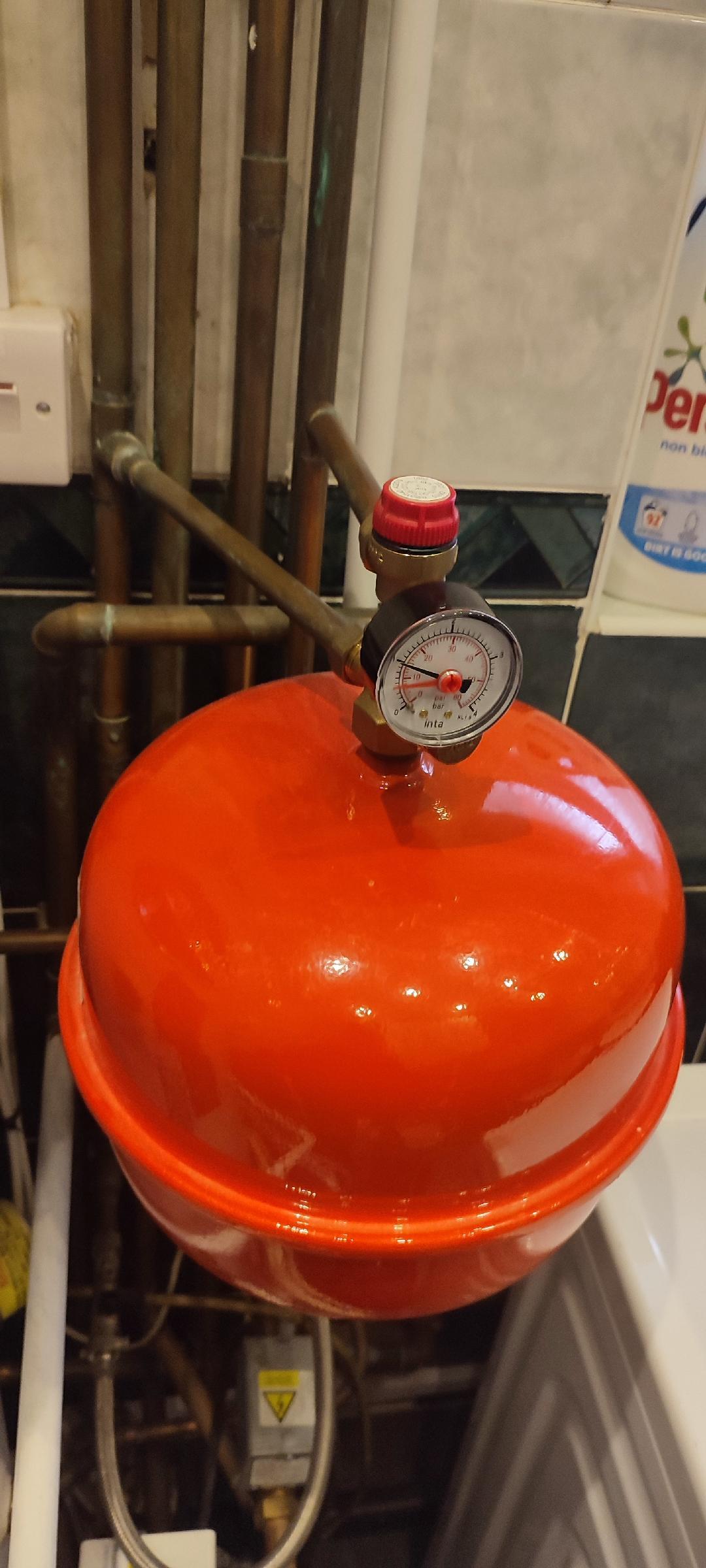

Question Posted May 31, 2023 Posted May 31, 2023 I had a new unvented cylinder installed with new expansion vessels a year. See image of the red vessel (12 liter 130 Cal-Pro Zilmet) supported only with the two copper pipes. Another plumber recently warned us that this expansion vessel could become very heavy if it failed, as it fills with water. That could result in the pipes breaking and to hot water flooding the room. It could also cause injury. Do I need to secure the expansion vessel with a bracket against the wall?
JohnMo Posted May 31, 2023 Posted May 31, 2023 I used a Tesla T-BAR Expansion Vessel Fixing Bar Kit (T-BARKIT)
Gone West Posted May 31, 2023 Posted May 31, 2023 2 hours ago, Question said: Do I need to secure the expansion vessel with a bracket against the wall? Yes is the short answer.
Question Posted June 1, 2023 Author Posted June 1, 2023 thanks for your replies. More expense probably as it will be very difficult to get the original installer back. Any thoughts about how we persuade a probably reluctant plumber to correct his own work?
Conor Posted June 1, 2023 Posted June 1, 2023 41 minutes ago, Question said: thanks for your replies. More expense probably as it will be very difficult to get the original installer back. Any thoughts about how we persuade a probably reluctant plumber to correct his own work? Might be a case of taking this on the chin and purchasing and installing the bracket yourself. Only a few quid and a couple screws. Somethings aren't worth the stress.
Alan Ambrose Posted June 1, 2023 Posted June 1, 2023 Yeah agree, looks easy to get to, so probably only 10 minutes work - even if you do it carefully
HughF Posted June 28, 2023 Posted June 28, 2023 On 01/06/2023 at 09:40, Question said: thanks for your replies. More expense probably as it will be very difficult to get the original installer back. Any thoughts about how we persuade a probably reluctant plumber to correct his own work? Easy, ask him for a day rate and tell him to crack on. Probably £300
