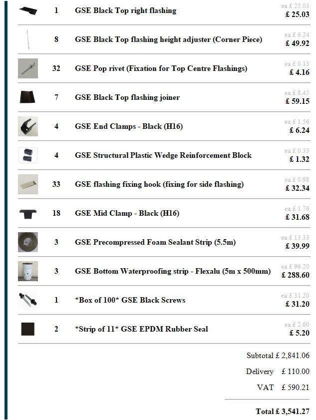

Jenki Posted May 30, 2023 Share Posted May 30, 2023 I'm looking at options and prices for PV, with my build budget tight, I still want to add a 4KW array to the roof, Getting costs the only options I can find are GSE trays and there are coming in more expensive than the panels. Are there other systems out there or am I looking on the wrong place. Eg if I went for 10 off 405w panels, I would need 20 of the half trays, plus clips trims etc. Midsummer quoted over 2k for the trays and ancillaries. Any ideas or alternatives? At these costs I may (have to), look at a ground mount after the build. Link to comment Share on other sites More sharing options...

Jenki Posted May 30, 2023 Author Share Posted May 30, 2023 5 hours ago, SteamyTea said: Where you getting PV modules from for 50 quid? https://midsummerwholesale.co.uk/buy/roof-integrated-solar-pv Not sure where £50 quid comes from for PV modules? I was looking at city plumbing for 405 we @ 159 less 10% Link to comment Share on other sites More sharing options...
Jenki Posted May 30, 2023 Author Share Posted May 30, 2023 4 hours ago, Dave Jones said: GSE trays are around £50 each, 1 per panel. Very easy to fit. https://midsummerwholesale.co.uk/buy/roof-integrated-solar-pv Not for the 405w panels I was looking at you need two halves Link to comment Share on other sites More sharing options...
SteamyTea Posted May 30, 2023 Share Posted May 30, 2023 2 hours ago, Jenki said: Not sure where £50 quid comes from for PV modules? From here. 9 hours ago, Jenki said: I can find are GSE trays and there are coming in more expensive than the panels. You can get two half trays at 28.60, so £57.20 1 Link to comment Share on other sites More sharing options...
Jenki Posted May 31, 2023 Author Share Posted May 31, 2023 (edited) 9 hours ago, SteamyTea said: From here. You can get two half trays at 28.60, so £57.20 Ahh, but you missed this bit in the same post 19 hours ago, Jenki said: Midsummer quoted over 2k for the trays and ancillaries. Edited May 31, 2023 by Jenki Link to comment Share on other sites More sharing options...
SteamyTea Posted May 31, 2023 Share Posted May 31, 2023 2 minutes ago, Jenki said: Ahh, but you missed this bit in the same post 19 hours ago, Jenki said: Midsummer quoted over 2k for the trays and ancillaries. Is the quite correct, there could be an error as they do happen. Link to comment Share on other sites More sharing options...
Jenki Posted May 31, 2023 Author Share Posted May 31, 2023 3 minutes ago, SteamyTea said: Is the quite correct, there could be an error as they do happen. the quote did include the panels @ £1352 (£1622) / plus the GSE trays couldn't screen shot the whole lot(🙈), but yes, including vat the trays and trims are £1800 (not 2K as I said earlier, but, more expensive than the panels.) Link to comment Share on other sites More sharing options...
SteamyTea Posted May 31, 2023 Share Posted May 31, 2023 3 minutes ago, Jenki said: the quote How does it compare to normal rail mounted. It does seem a little steep, but falls into line at around £1000/kWp. When I worked for the small wind turbine manufacturer, the complete installation cost about £12,000, the turbine was a couple of £2. The financial backers wanted to halve the price, we pointed out that the savings were not to be made on the turbine, but on everything else. Link to comment Share on other sites More sharing options...
