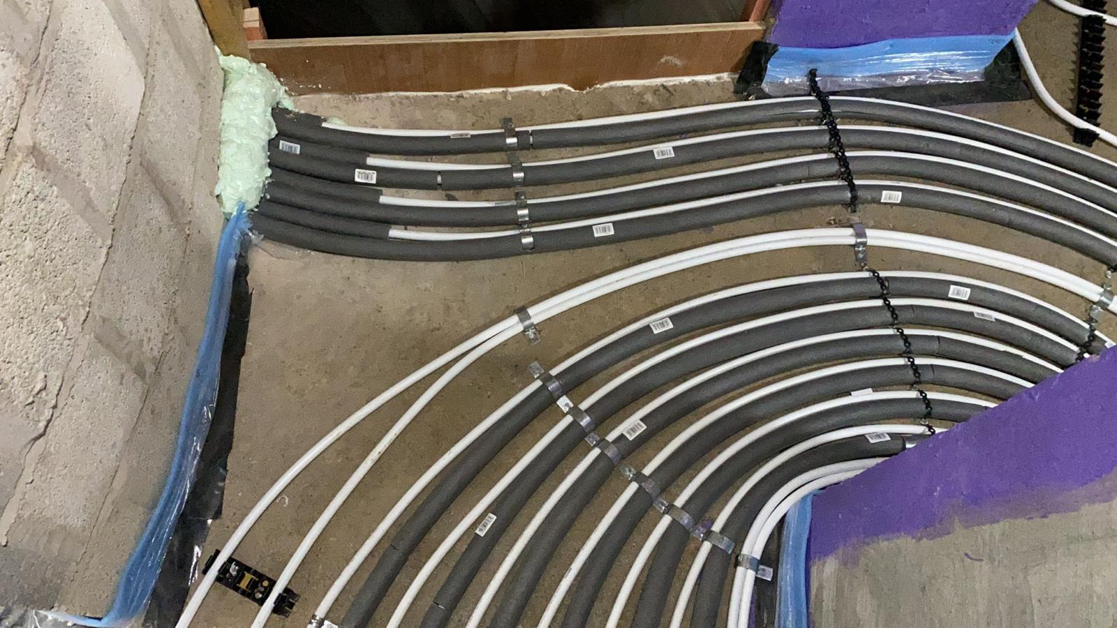

Nickfromwales Posted May 29, 2023 Posted May 29, 2023 On 29/05/2023 at 08:39, SteamyTea said: The problems start when designers just put in standard UFH pipework spacing Expand The exact reason that on my current project (a fully certified Passivhaus) I am designing this issue out; manipulation of where flow goes first, selecting which pipes get insulated before reaching their target 'zones' and also by selecting different o/c's in different spaces according to discipline. One thermostat planned per floor but with a very tight hysteresis so the second there is fluctuation (up or down) the systems can respond quickly (as quickly as a PH can) and mitigate against over / under shoot. Solar gain over shoot is the offender that my efforts will be largely focussed on, heating is a doddle to deal with. 1

Shaun McD Posted May 29, 2023 Author Posted May 29, 2023 On 29/05/2023 at 10:27, Nickfromwales said: The exact reason that on my current project (a fully certified Passivhaus) I am designing this issue out; manipulation of where flow goes first, selecting which pipes get insulated before reaching their target 'zones' and also by selecting different o/c's in different spaces according to discipline. One thermostat planned per floor but with a very tight hysteresis so the second there is fluctuation (up or down) the systems can respond quickly (as quickly as a PH can) and mitigate against over / under shoot. Solar gain over shoot is the offender that my efforts will be largely focussed on, heating is a doddle to deal with. Expand Nice point on insulating loop feed lines, would never think on these things! Is handling which area gets flow first just position on manifold? On 29/05/2023 at 11:09, Nickfromwales said: Surface contact (cross sectional area of the pipe > surrounding concrete) determines how effectively the transfer of energy is, and if you want to effect cooling this becomes a valid point of consideration. Heating is barely worth talking about and almost manages itself; just look at examples of folk on here at all ends of the spectrum, some at 100mm o/c and other at 400mm o/c, some with a buffer / some without, and so on. Nobody has yet yelled for help as their system is 'out of control' for heating. Closer o/c means the slab will be more reactive and pipe is cheap as chips, but I also cannot experiment in my clients homes! Belt & braces (for the cost difference vs risk) will always be my choice. Cooling is the 'enemy' as the input flow temps need to avoid condensation risks, ergo you can only effect a certain amount of 'change' over x period of time, and the less CSA and volume, the worse (more elongated) that becomes. Further to this, the dwelling type has further effects which need to be factored in, and then you also need to understand if auxiliary cooling via AHU's can bolster the effect and manage the times between the slab coming into useful play. Cooling likely needs injecting at the small hours, so as to have some kind of momentum for the sunny morning to midday, and the kick in the knackers there is only some of it can be dealt with from PV then. One client uses the cooling 'long & low' (so nigh-on constant flow of "cold-ish" water through the UFH)but I also specified an intelligent AHU which speeds up the MVHR fan speeds when it detects cold water input into the heat exchanger, eg to increase the volume of cooled air (heat energy) conveyed, and I'm still gathering feedback / data as to how that works out in an occupied dwelling but controls seem to be the bug bear with this type of flip/flop setting. Trying to get something simple and recognisable to hand over to Joe Public is a challenge! I am very impressed with the Steibel Eltron ASHP we installed recently, but more so with the controls. DHW goes direct off the ASHP and cooling / heating of the UFH goes through a digital blending set (fed from buffer when either warm or cold) which then goes direct to AHU. The advantage here is that I can send 7oC water to the AHU to max out its cooling capabilities vs minimising air flow speed rates, and the blended sum goes to the UFH so I can decide that to be 16oC, simultaneously. I think a few of the more boffin-like members on here have come up with the same solution, but this one is out of the box and more 'fit for human consumption'. I just wish there were more hours in the day so I could read everything written on here about the subject! In the meantime, I may just go on to recommend and employ the (very expensive) Steibel setup, as it actually works out as being value for money when you look at it as a holistic and comprehensive turnkey heating and cooling arrangement. Expand all very interesting, I have yet to get into too much detail on the cooling side! Main factors so far are the solar gain redistribution and opting for a heat pump (if possible) with a cooling function. On that note, again on pipe spacings, using flow rates and pipe spacing to help not over heat areas with higher solar gain seems clear, but on the flip side, when it comes to cooling the slab by pumping around 13-16deg C water, would it not be a plus point to have more pipe, i.e. less spacing? The principle that the more water in the slab will allow for more heat extracted? Having pipes at 300 centers are bound to be less efficient at cooling the slab than at 100mm? I am sure there is maths that can be done on how much heat can be extracted by volume of water i guess
SteamyTea Posted May 29, 2023 Posted May 29, 2023 On 29/05/2023 at 12:22, Shaun McD said: I am sure there is maths that can be done on how much heat can be extracted by volume of water i guess Expand There is, but it is based on mass flow rates. Luckily in the case if water, mass and volume are equal mathematically. On 29/05/2023 at 11:09, Nickfromwales said: Nobody has yet yelled for help as their system is 'out of control' for heating. Expand They have in here, frequently.
Nickfromwales Posted May 29, 2023 Posted May 29, 2023 On 29/05/2023 at 12:22, Shaun McD said: Nice point on insulating loop feed lines, would never think on these things! Is handling which area gets flow first just position on manifold? Expand One pipe leaving will be flow at the manifold temp, and the return loop will obvs be at the lower temp. Deciding which pipe runs where offers some minimal but additional manipulation of this distribution. In a PH or thereabouts it does become almost moot as the slab will almost completely uniformly acclimatise and there will be very little difference between the two. I only insulate the pipes going to the far side of the dwelling from the manifold, mostly to keep whatever is in the pipe, in the pipe, until I want it 'out'. 1
