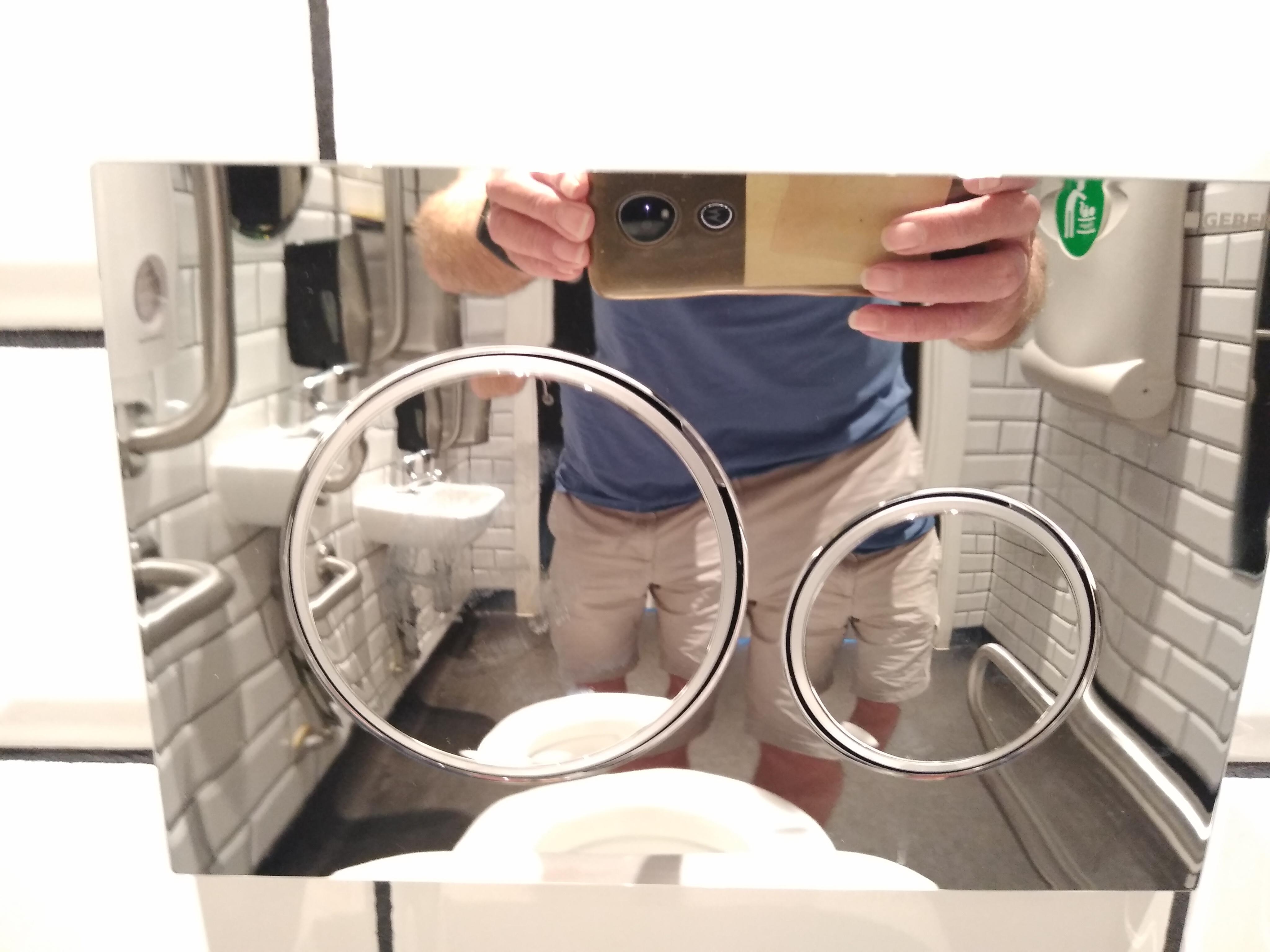

SteamyTea Posted May 27, 2023 Share Posted May 27, 2023 Get the angle right makes me bigger, or twice as handsome. Did manage to get 3 'images', but just made a mess. (expletive deleted)ing brilliant Link to comment Share on other sites More sharing options...

ToughButterCup Posted May 27, 2023 Share Posted May 27, 2023 A little rant. Are you sitting comfortably? Then I'll begin. This particular design of Geberit flush plate uses levers - not buttons. It's round - so it's a button isn't it ? No it's not. The visual lie is the roundness of the lever. How do I know? One of the two Geberit flush plates we installed broke. So I had to take the flushplate assembly off the wall. The lever is made of a very thin, springy piece of stainless steel, it's stuck to the back of the so-called button. In normal use, pressing the 'button' means people press the middle of the circle. So less than half of the potential power of the lever is used - and the resultant water flush weak. With obvious results - or lack of result if you like. The only way to make the flush work as it should is to press and hold the bottom of the lever while the flush takes place. For the priviledge of being allowed to buy two flush plates, I spent £160. And the ones we bought were the cheapest available at the time. "Oh, yes, they have been known to fail " said the Geberit Tech support guy. And promptly sent me another flush pate assembly of exactly the same design. One word for it ..... Shite. 1 Link to comment Share on other sites More sharing options...

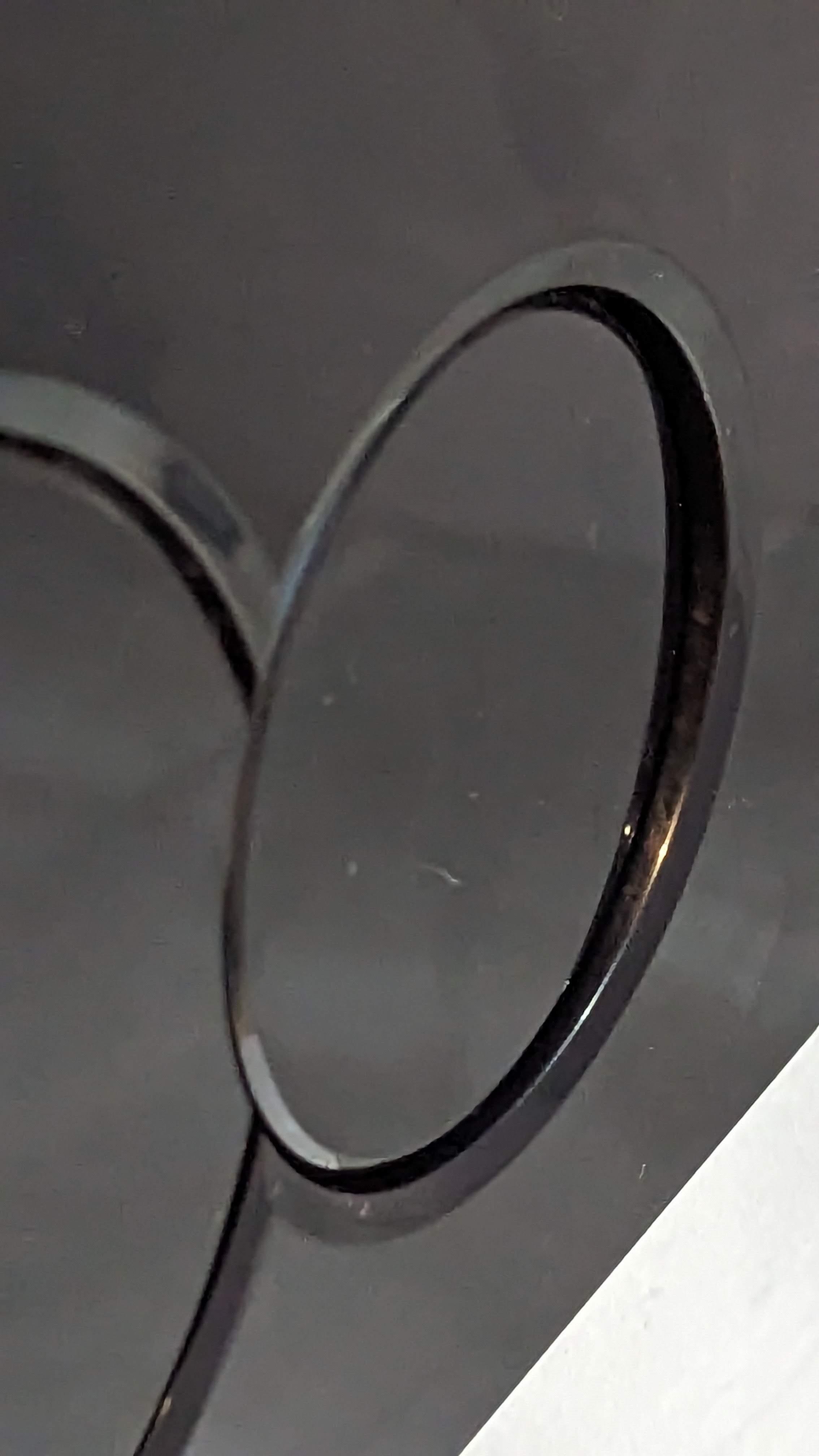

ToughButterCup Posted May 29, 2023 Share Posted May 29, 2023 Here's what the flush-plate looks like when it fails..... Link to comment Share on other sites More sharing options...
SteamyTea Posted May 29, 2023 Author Share Posted May 29, 2023 17 minutes ago, ToughButterCup said: Here's what the flush-plate looks like when it fails..... Not where I was, the smaller button how fallen off, leaving a white lever will a ball on the end, I was too scared to touch it, I saw the mess on the seat rim. One can never trust anything that bleeds for a week and does not die. Link to comment Share on other sites More sharing options...
