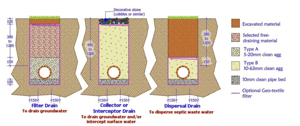

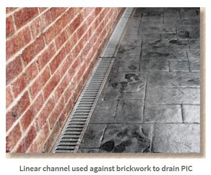

Adsibob Posted July 16, 2021 Posted July 16, 2021 The minimum recommended depth on pavingexpert.com for a french drain is 550mm (450mm to the bed, then a 100mm bed): We are trying to fit the drain along the outer perimeter of the house, to keep the base of the walls dry. We realised today that we hit the first corbel at about 250mm below ground level. So the options are to either have a much shallower french drain (which I think will really be too shallow given it will be less than half the recommended minimum of 550mm) or to locate the pipe about 180mm or possibly 250mm further away from the house, which will allow us to go deeper (but probably still not as deep as 550mm) and for the bottom of the trench on the side of the house to be stepped to accommodate the corbels. Any ideas on which option will work best? Or should I give up on a french drain altogether and fit something more shallow, like a linear channel drain shown here?
markc Posted July 16, 2021 Posted July 16, 2021 If you have shallow brick strip foundations, why do you want or feel you need to add a french drain? - the drain excavations can/will compromise the foundation and removing water will affect the soil underneath
Adsibob Posted July 16, 2021 Posted July 16, 2021 34 minutes ago, markc said: If you have shallow brick strip foundations, why do you want or feel you need to add a french drain? - the drain excavations can/will compromise the foundation and removing water will affect the soil underneath it's okay, we have just spend a small fortune underpinning those foundations. The wall is damp and the damp surveyor (who is a RICS surveyor) recommended that part of the damp mitigation strategy was to improve the drainage of the walls. For the last 20 years or so, it's effectively had no drainage because the previous owners messed about so much). But maybe a shallow trench filled with pea shingle is sufficient for these purposes. 1
joe90 Posted July 16, 2021 Posted July 16, 2021 26 minutes ago, Adsibob said: But maybe a shallow trench filled with pea shingle is sufficient for these purposes. As long as you can get any water away from the stone/drain.
