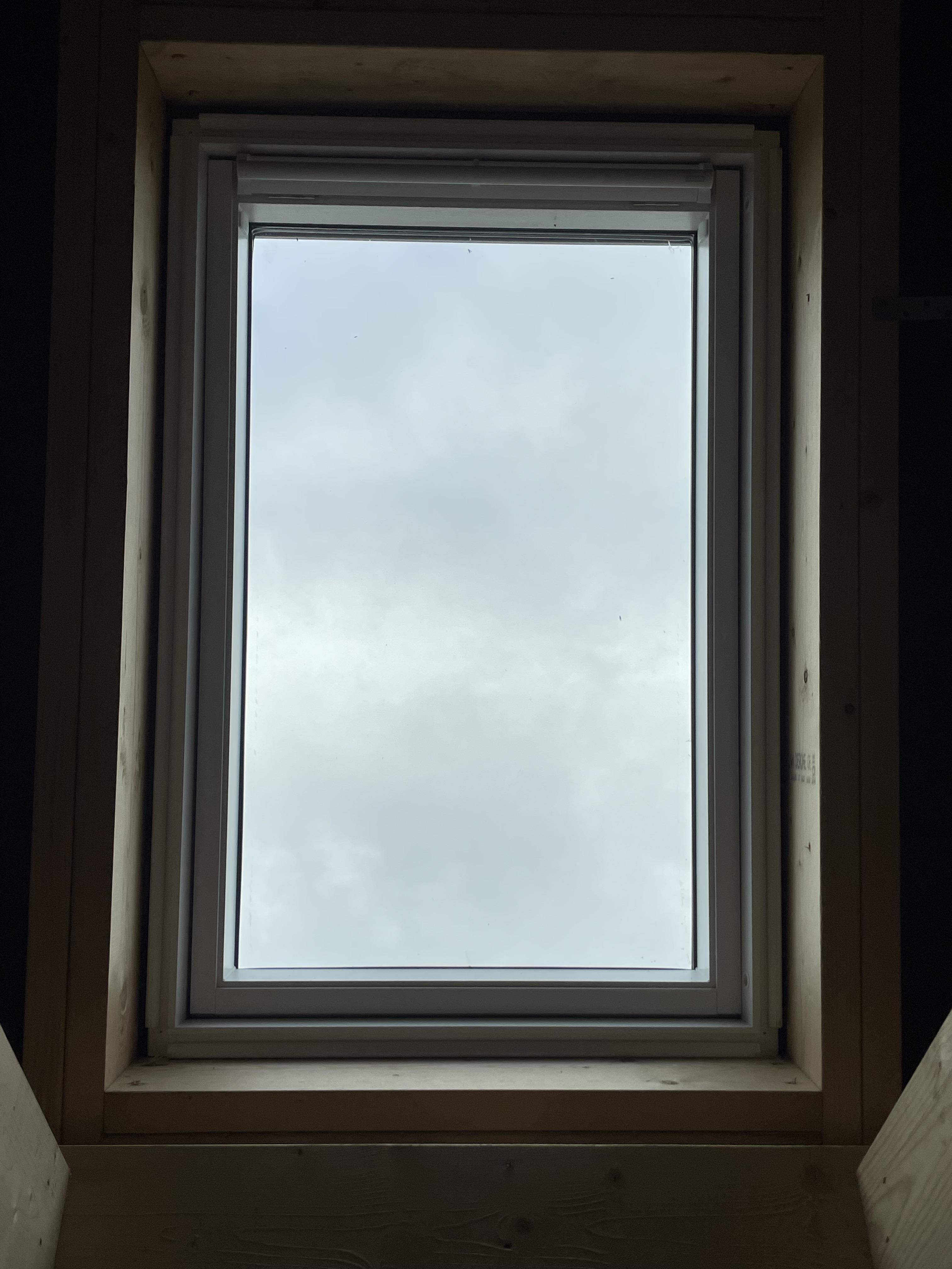

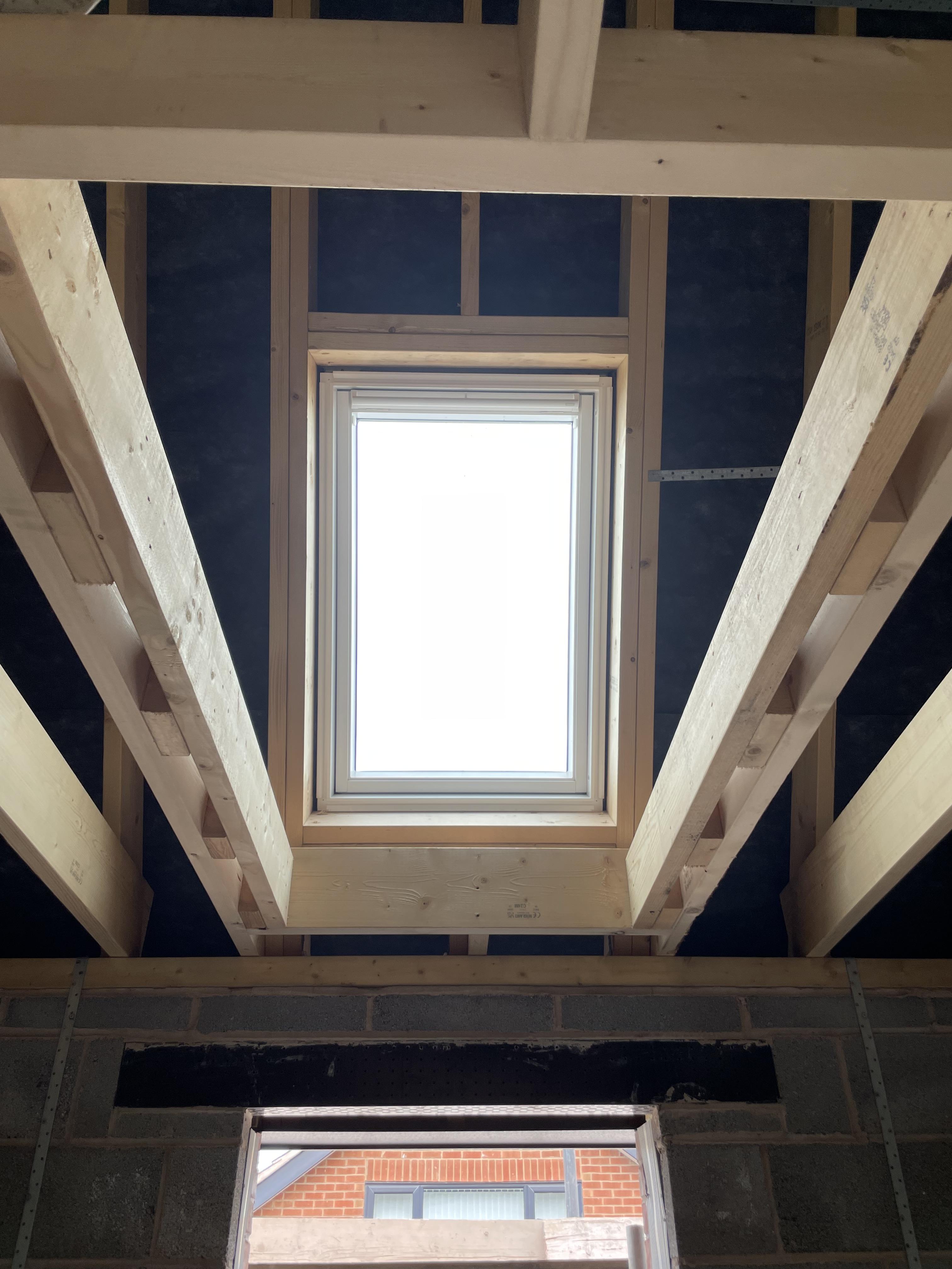

richo106 Posted May 16, 2023 Posted May 16, 2023 In our bathrooms we have had velux’s installed but the bathroom ceiling is flat so creating like a light tunnel etc I am going to have vcl at first floor ceiling level, would it just be the case of continuing this up to the window? Do I need to air tight tape the velux to the wood at all? I have attached pictures to show what I mean
eandg Posted May 16, 2023 Posted May 16, 2023 No idea if I've done it right or not but I put 20mm Kooltherm in attached to the structural timber, airtight taped the Velux plasterboard groove to it and then boarded. About an hour a window once I had the hang of it and only a few quid in the scheme of things.

richo106 Posted May 17, 2023 Author Posted May 17, 2023 Does it have to be 20mm Kooltherm? Could it be 25mm PIR or is that different completely? Also sorry for my naivety...where does the velux need to be boarded and plastered up to?
eandg Posted May 17, 2023 Posted May 17, 2023 13 hours ago, richo106 said: Does it have to be 20mm Kooltherm? Could it be 25mm PIR or is that different completely? Also sorry for my naivety...where does the velux need to be boarded and plastered up to? There's a groove in the Veluxes approximately 22mm or thereabouts from the edge of the window unit. I think 25mm insulation would leave it too tight to fit the plasterboard. I had Kooltherm kicking about but if I had 20mm PIR could have used that too (Kooltherm has better performance though - so 20mm Kooltherm is like 40mm bogstandard PIR - and it's really robust, but I don't think there's any issues just screwing plasterboard straight onto PIR either). We got our Kooltherm from Seconds and Co and the price was not much different to buying PIR from a merchant.
