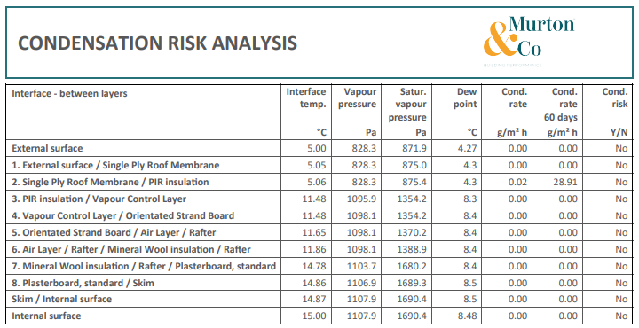

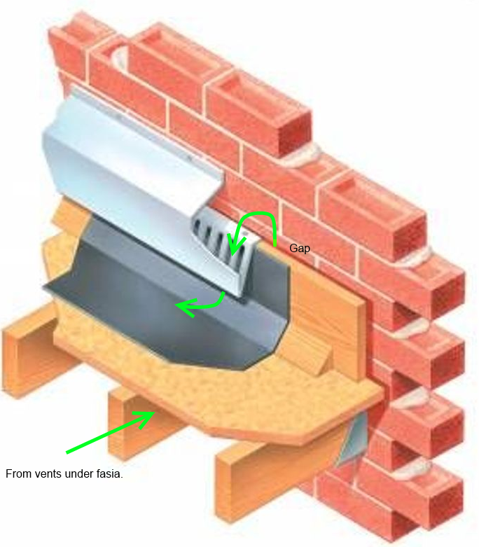

Temp Posted May 14, 2023 Share Posted May 14, 2023 On 12/05/2023 at 06:47, jamoritch said: One person who came to quote advised as we’ve got no insulation in our kitchen we won’t see the benefit of a warm roof really and spending the extra money for it to be a warm roof. However a builder who lives next door thinks cold roofs may become abit obsolete due to having to be a certain energy efficient standard. Your builder next door is correct. Cold roofs need ventilation between the waterproof layer and the insulation. This can be difficult to achieve if the rafters run perpendicular to the wall of the house (which they normally do. You should really fit a special vents all along where the roof meets the wall of the house under the flashing. Many roofers don't bother to do this. The only real disadvantage of a warm roof construction is that the overall thickness of the roof is normally greater. You can mitigate this by putting some insulation between the rafters as well as above but not too much. The normal rule of thumb is no more than 1/3rd between and 2/3rds above, but you should really get a condensation risk analysis done to check the exact make up. National Federation of Roofing Contractors.. https://www.nfrc.co.uk/docs/default-source/form-protected-documents/homeowners/householders-guide-to-flat-roofing-2015.pdf Quote In Britain as a whole, the WARM ROOF is strongly recommended. LABC Guide.. https://www.tendringdc.gov.uk/sites/default/files/documents/planning/building control/Flat roof guide for website PDF V2.pdf Link to comment Share on other sites More sharing options...

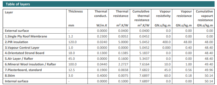

Temp Posted May 14, 2023 Share Posted May 14, 2023 Google found a condensation risk analysis for a warm flat roof using 120mm PIR above and 100mm Mineral wool between the rafters. Hope they don't mind me posting a llink and extracts here.. https://bmdevelopments.net/wp-content/uploads/2016/10/Condensation-Risk-Analysis-Flat-Roof-120mm-PIR-100mm-Wool-17Sep2020.pdf Link to comment Share on other sites More sharing options...

Temp Posted May 14, 2023 Share Posted May 14, 2023 These are the sort of vents that should really be used on a cold roof construction. Note the OSB deck doesn't go right up to the wall. There is a gap for air flow. 2 1 Link to comment Share on other sites More sharing options...
