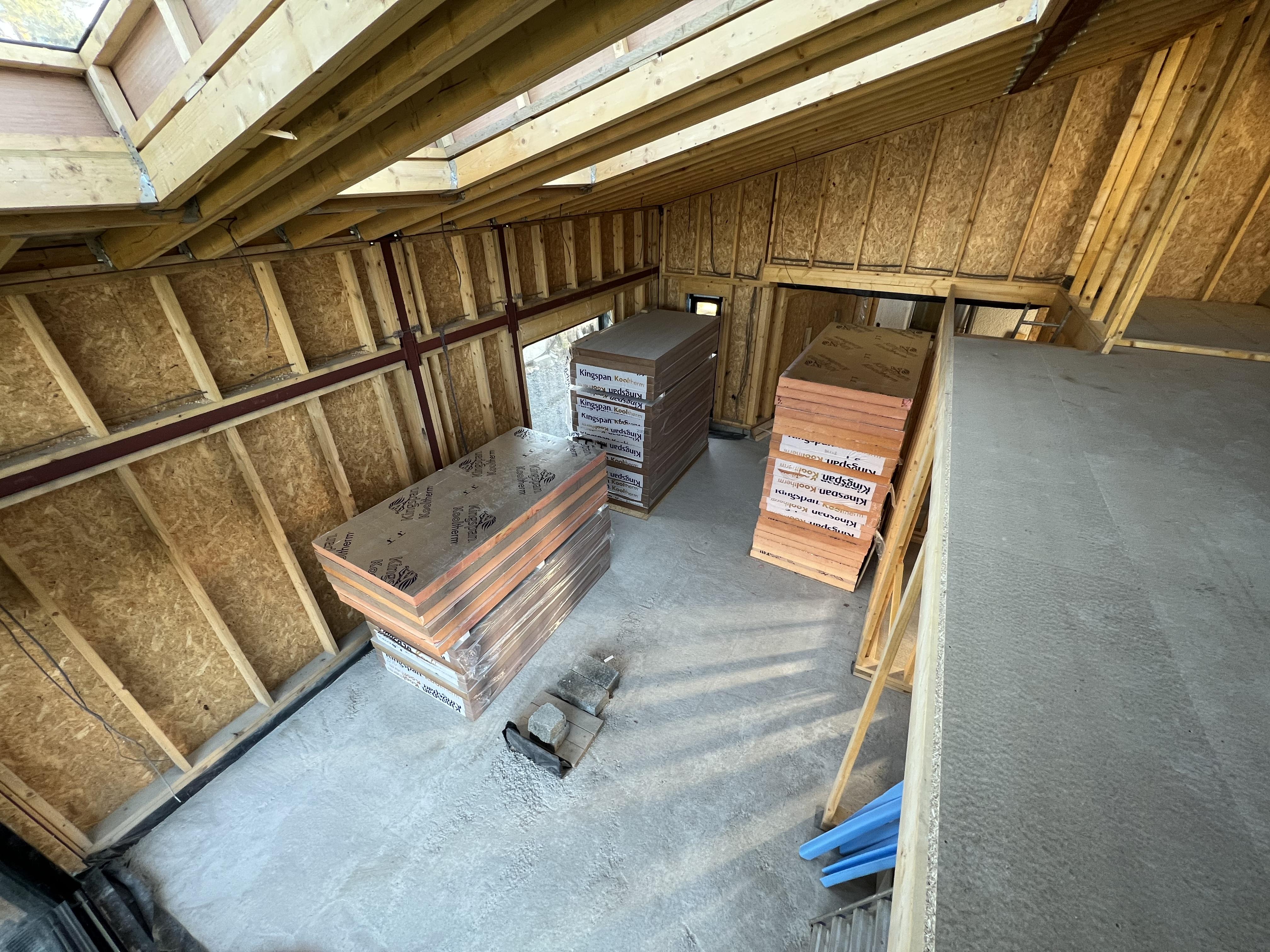

I think we are now pretty much ready to start the arduous task of installing our wall insulation.
What I was wanting to ask is regarding the placement of the insulation between the timbers please….
Our timbers are 140mm wide, and we have to fit 100mm Kingspan
Should our insulation be right at the back, almost touching the boards?
Or further out, sitting just behind the plasterboard (when fitted) ?
Many thanks

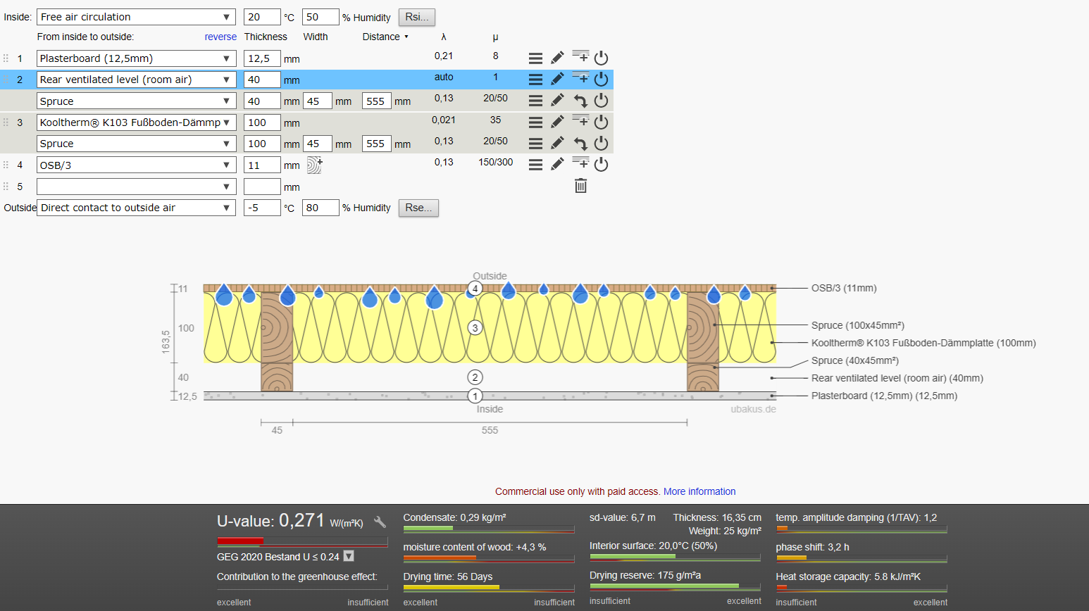

The kooltherm is an unusual choice as it is very very expensive. Normally it would only make sense where you had absolutely no extra space to work with and it was vital you hit a specific U value.
In this case you have a U Value of about 0.27 w/m2K.
I would take the Kooltherm back to the shop . Fit mineral wool batts between the studs. Then a vapour barrier. Then 50x50 battens perpendicularly with mineral wool infill as a service cavity and then some 15mm plasterboard.

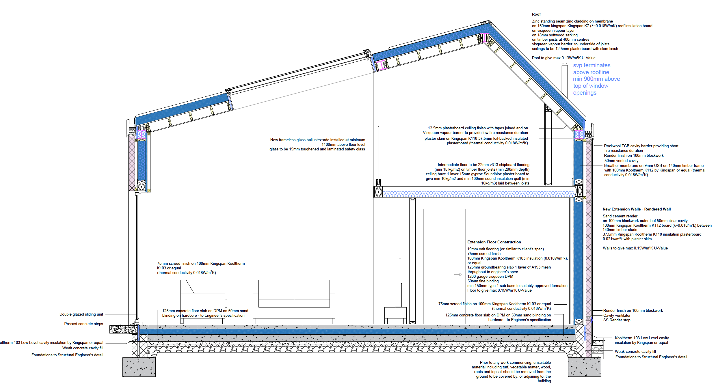

Thanks everyone for your input, makes for interesting reading, but my brain is well and truly hoovered out!

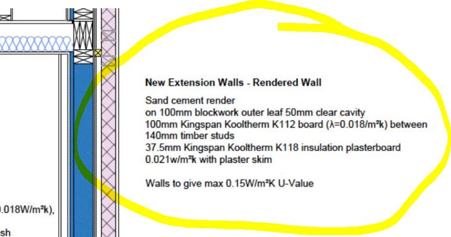

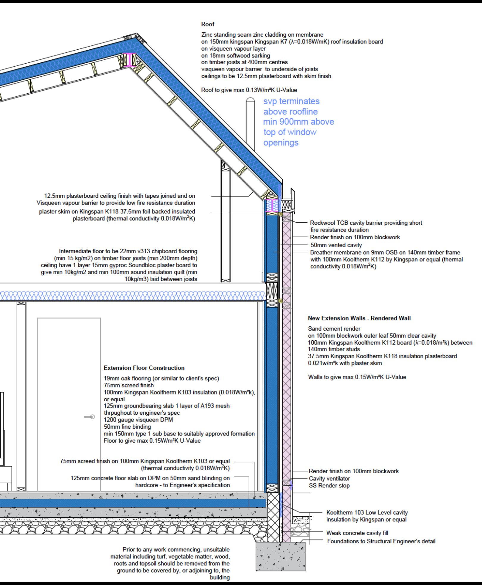

For clarity, this is what we are working to………
Our SE and Architect have specified:
100mm Kooltherm
Between 140mm studs/timbers
In my layman’s mind, the electrics would run on the inside face of the insulation? (Reason for the 40mm cavity before the 37.5mm insulated plasterboard goes on)
Edited by ggc
Clearer image
Your Architect has been taken out for lunch by the Kingspan salesman I think.

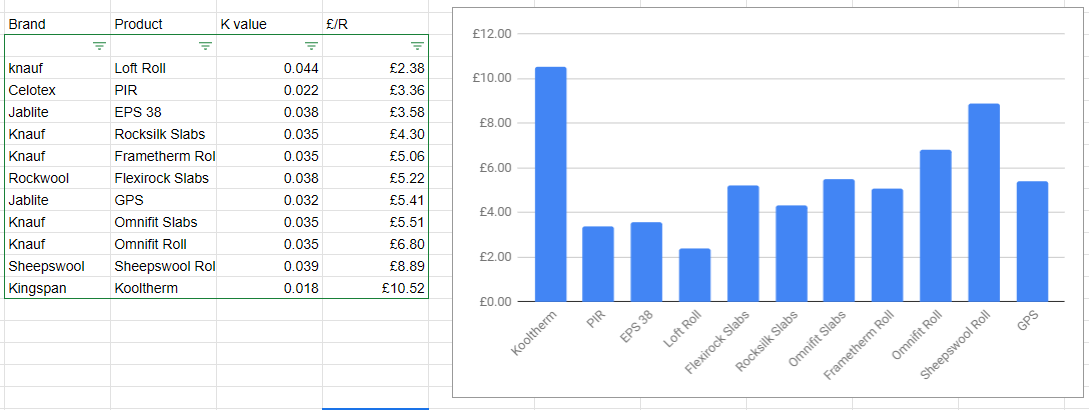

To get a sense of what I mean lets look at some £/R Values or how much insulation costs for a given heat blocking ability.  All prices from insulation4less. Please feel free to check my sums but I think it's accurate.
Lets take the k112 and something like the Flexirock slabs.
So what I hear...... its only £5. What s that between friends!?
For your walls of a u value 0.15W/m2K or R 6.6. However that rises to an R value required of 8.25 by the time you account for 10% timber framing. Its a £5.46 hike from the Rocksilk to the Kooltherm per R per m2.
So £5.46 X 8.25 x say 100m2 of wall area = £4005 more expensive.
Now there are less costs with reduced thickness but nothing like this. We haven't even considered the substantial waste with fitting boards between studs. I think the salesman might have had a week in the Algarve too.
Find out if you can return/exchange the K112 would be my first port of call.

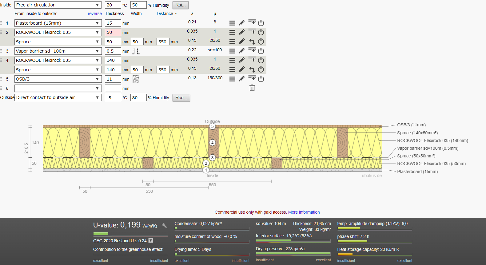

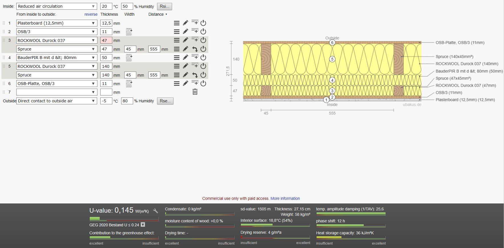

Given you have a U value target of 0.15 I'd do something like the following.
Rocksilk 140mm £16.78/m2
50mm PIR with taped joints as VCL £9.05/m2
50mm Rocksilk £5.50/m2
With 50x50 battens £1/m2
15mm plasterboard £5.25
Total £37.58/m2
Or use a layer of 11mm OSB £4.71/m2 and 12.5mm plasterboard instead of 15mm plasterboard. Nice and solid to fix to vs PB alone.
Total £40.76/m2
Compare that to the current buildup.
100mm Kooltherm k112 £58.40/m2
37.5mm Kooltherm Insulated plasterboard K118. £ 29.58
Total £87.98.
Less labour but twice the price.

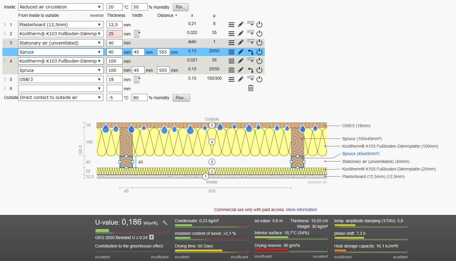

The free german website Ubakus makes Kooltherma poorer K value of 0.021 than the UK kingspan declaration . I don't know why, but I trust them about as far as I could throw them. Even with a K value of 0.018 you'd be optimistic to hit 0.15 and that assumes perfectly still air in the cavity which would be almost impossible to achieve.
