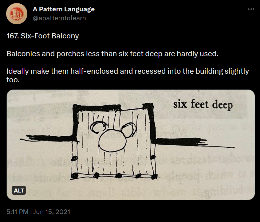

jack Posted April 26, 2023 Share Posted April 26, 2023 43 minutes ago, Furnace said: That's my thinking, but the partner believes otherwise.....I'm building up my evidence to make the case for eliminating them. Particularly since the non-balcony version of the design is what has been submitted for planning. There's an old book about designing homes called "A Pattern Language". A lot of it tends to the esoteric and it can be a bit new-age airy-fairy at times, but there're also some useful (and often research-based) observations. One of those is that balconies less than a certain depth (about 6", from memory) will rarely if ever be used. Edited to add: I found this: One more link: https://archive.curbed.com/2019/7/11/20686495/pattern-language-christopher-alexander 1 1 Link to comment Share on other sites More sharing options...
Furnace Posted April 26, 2023 Author Share Posted April 26, 2023 2 hours ago, jack said: One of those is that balconies less than a certain depth (about 6", from memory) will rarely if ever be used. My proposed one was only 3 feet so falls well short. With the potential cold bridging issues and the likely cost, I think my mind is now made up. Many thanks 1 Link to comment Share on other sites More sharing options...
