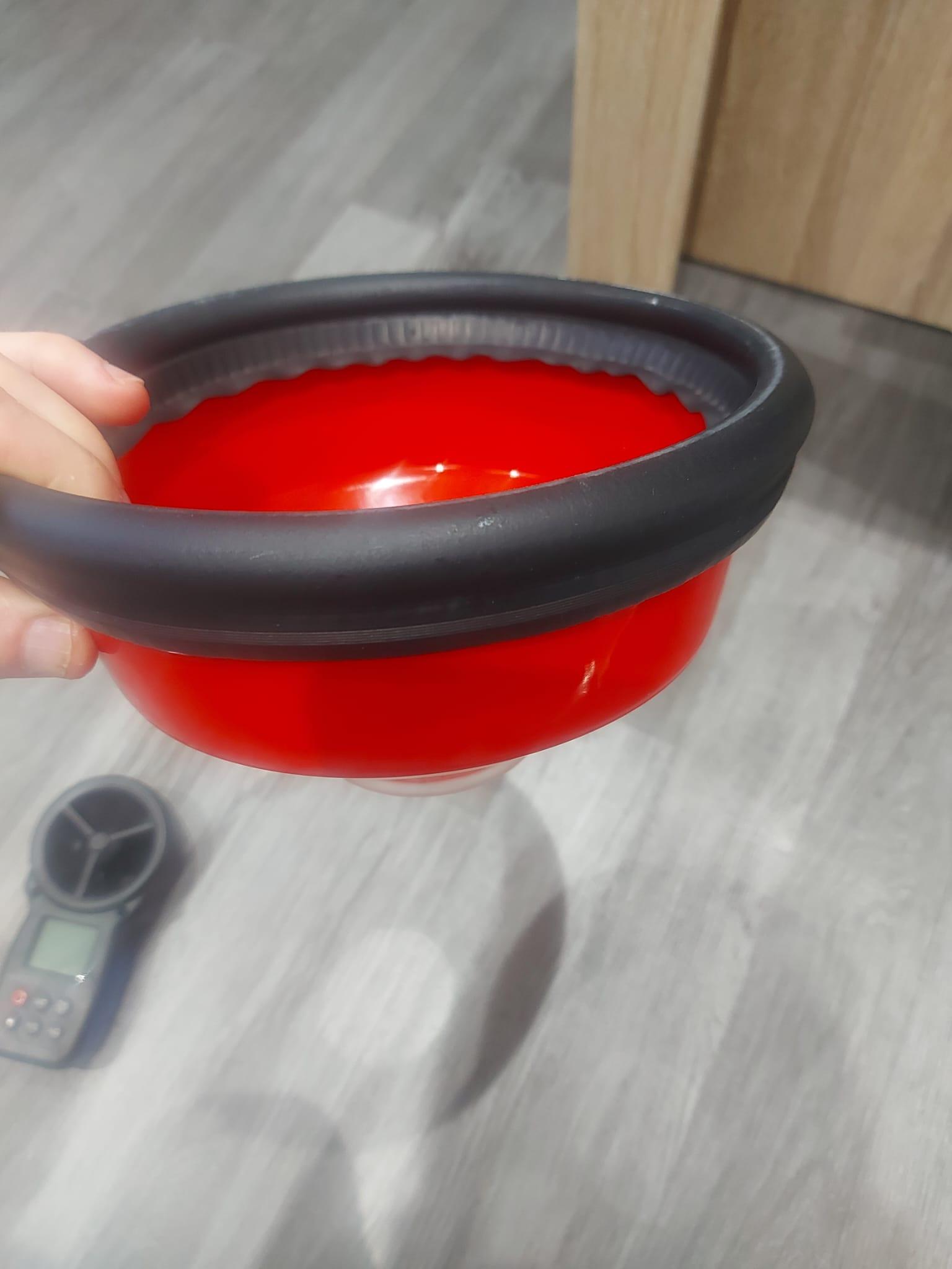

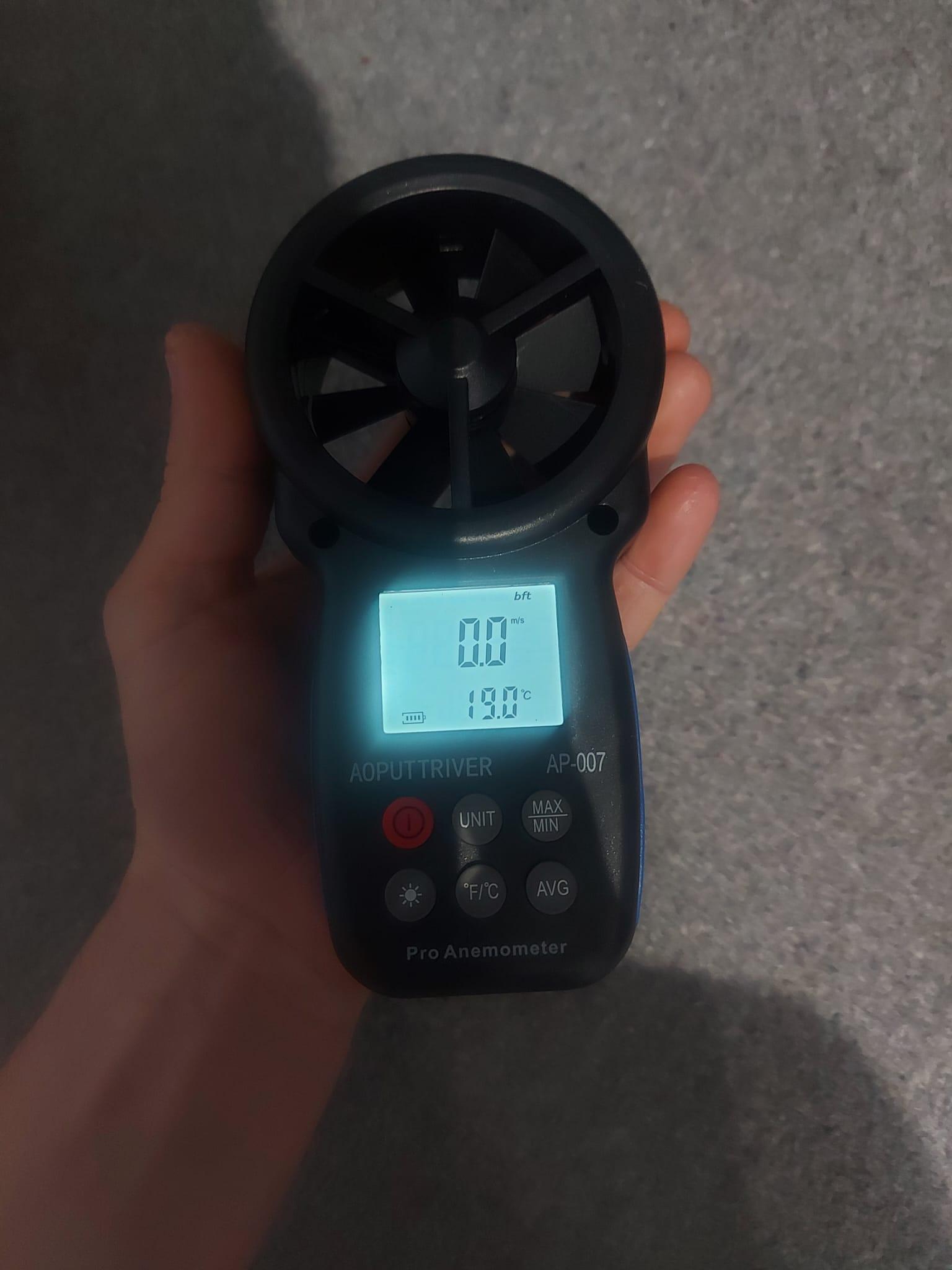

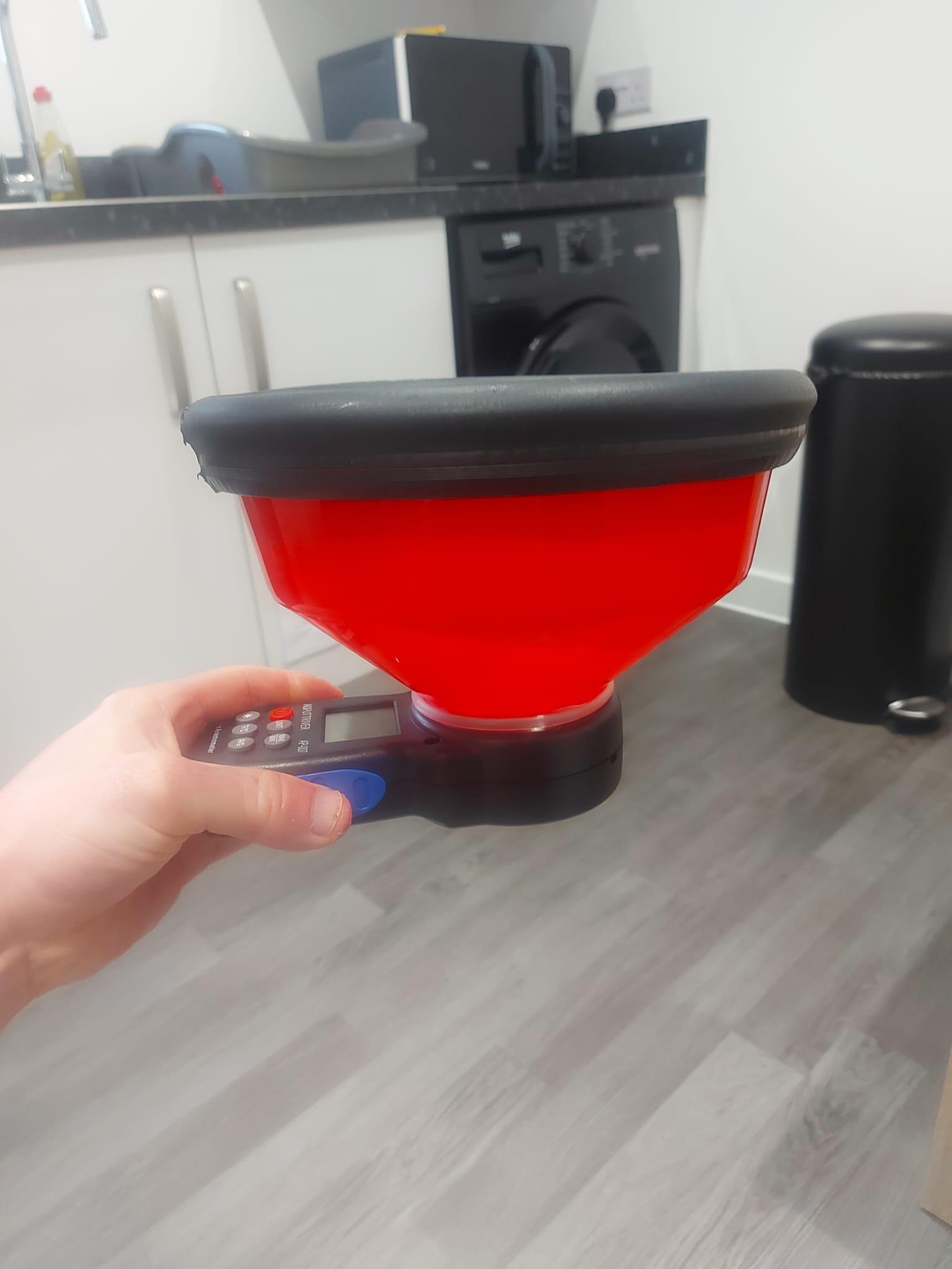

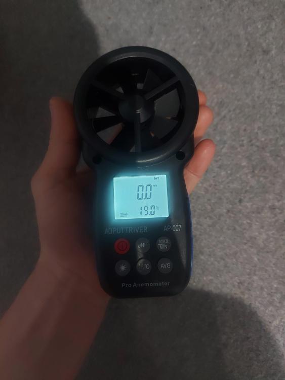

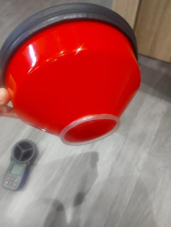

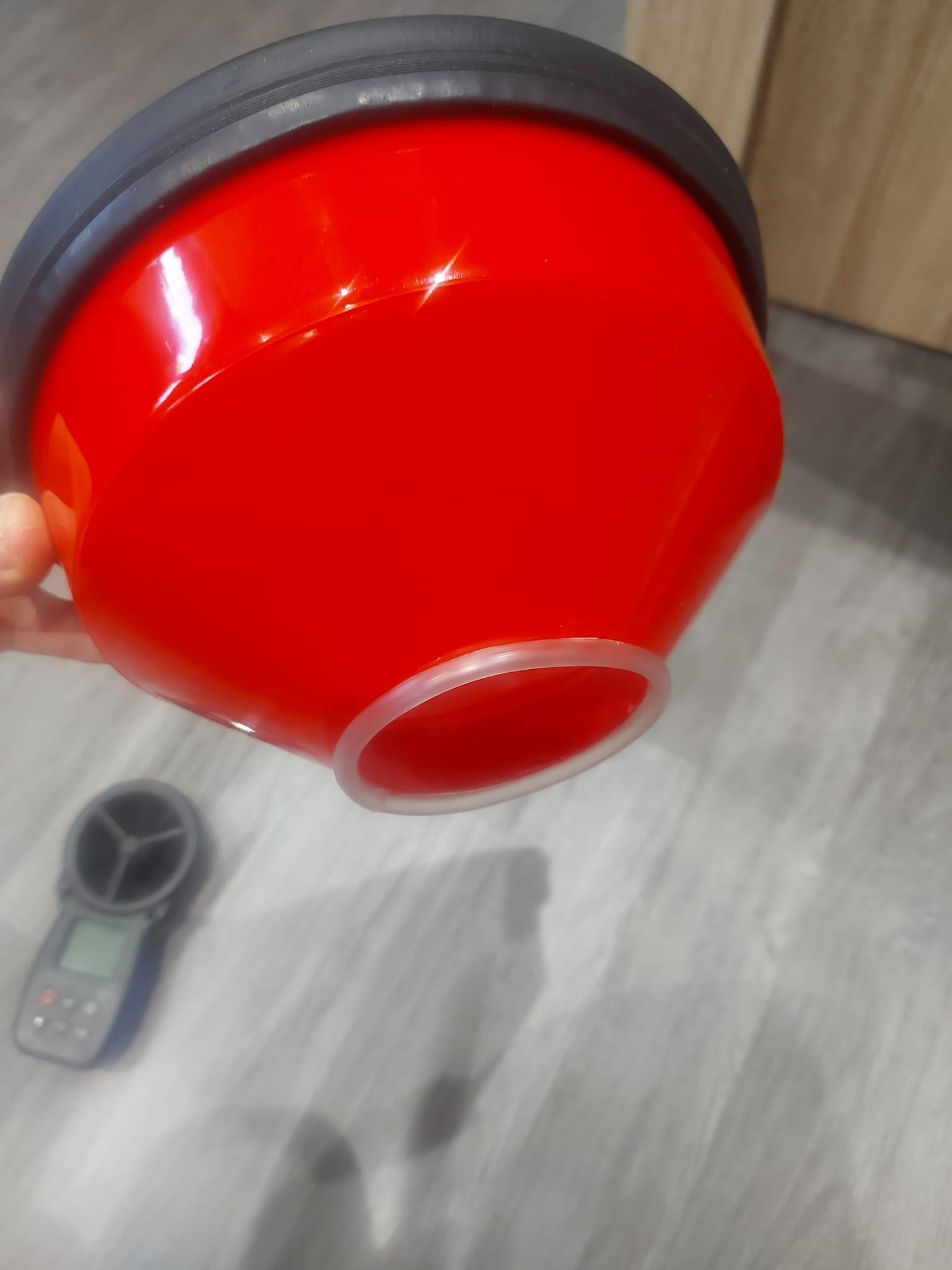

jimbob12345 Posted April 14, 2023 Share Posted April 14, 2023 Hi everyone, new to the forum, looking for some advice. Trying to commission my MVHR using my cheaply made anemometer using a funnel, car door seals and an aquarium pipe to make a good seal on the ceiling and anemometer . My Issue is that the device measures in M/S and I need L/S. Ive had a scroll through the forum and have seen that most people have posted on graphs that they use about 1 M/S as around 7 L/S. The issue is my anemometer has an internal radius of around 3.25 cm and 6.5cm diameter. Every online calculation i use is no where near 1 M/S per 7L/S. I was just wondering where to go with this and how people came to there conclusions and calculations. Surely the calculation should be done on the anemometer internal hole and not the ducting size. Thanks in advance Link to comment Share on other sites More sharing options...
jimbob12345 Posted April 15, 2023 Author Share Posted April 15, 2023 Just to add if i use the calculation of 3.3 l/s per 1 m/s I struggle to get near where I should be when the fans are on full flow, but I can feel alot of flow of air, hence why I'm curious about the calculation of the wind speed. Link to comment Share on other sites More sharing options...

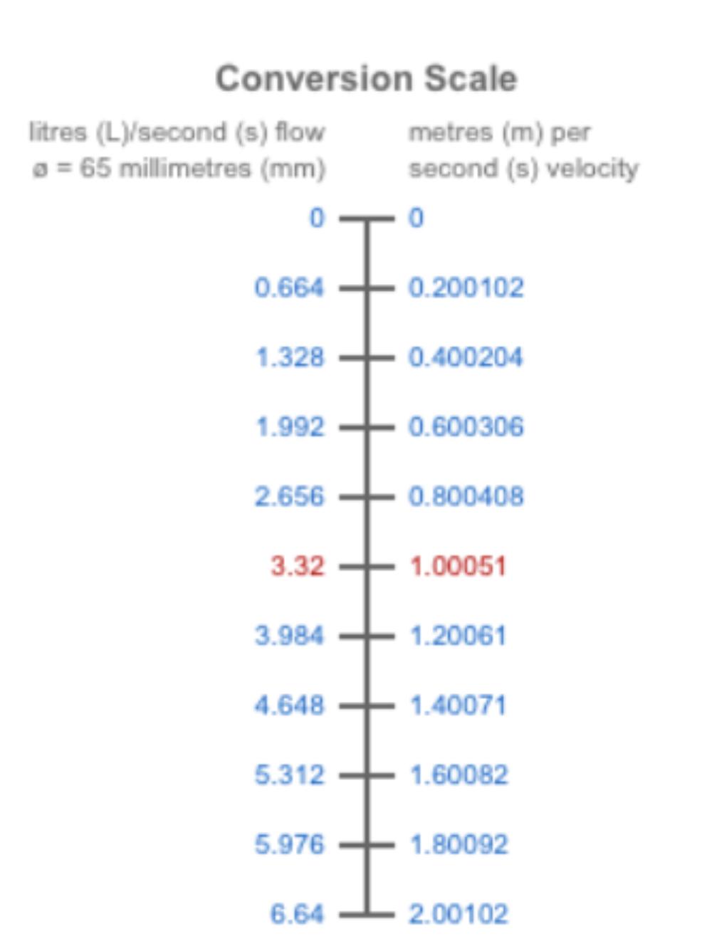

jack Posted April 15, 2023 Share Posted April 15, 2023 I can't help much beyond agreeing with your 3.3 L/s calculation. Can you give some examples of the numbers you're trying to meet? Link to comment Share on other sites More sharing options...
PeterW Posted April 15, 2023 Share Posted April 15, 2023 Vane anemometers are not reliable for low flows - they can’t really get over the initial start up “flow” required to get a good reading. Your calcs are correct though - 3.3l/s in a 65mm dia duct is ~1m/s Decent calculator here Link to comment Share on other sites More sharing options...

Temp Posted April 15, 2023 Share Posted April 15, 2023 (edited) 22 hours ago, jimbob12345 said: My Issue is that the device measures in M/S and I need L/S. Ive had a scroll through the forum and have seen that most people have posted on graphs that they use about 1 M/S as around 7 L/S. The issue is my anemometer has an internal radius of around 3.25 cm and 6.5cm diameter. Every online calculation i use is no where near 1 M/S per 7L/S. m/s is a linear velocity. L/s is a volume flow rate. To convert between the two you first need to know the cross sectional area in m^2 (aka sqm) where you are measuring the velocity. In your case you are funnelling all of the air through the anemometer so that's the area you need. The radius is 3.25 cm = 3.25 * 10^-2m. So the area = Pi * (3.25 * 10^-2)^2 = 3.32 * 10^-3 m^2 The flow rate in cubic meters per second is then the velocity (in m/s) * the area (in m^2) So let's say the velocity was 1 m/s... The flow rate in cubic meters per second would be.. 1 * 3.32 * 10^-3 = 3.32 * 10^-3 m^3/s To convert that to L/s multiply by 1000 because 1m^3 = 1000L So in your case with the funnel .. 1m/s = 3.32 L/s Edited April 15, 2023 by Temp Link to comment Share on other sites More sharing options...
Temp Posted April 15, 2023 Share Posted April 15, 2023 If measuring the flow out of a pipe without the funnel take several velocity readings over the area of the pipe outlet and average them to give an average velocity. Then use the cross sectional area of the pipe in the calculation instead of the area of the anemometer. This is a little inaccurate because of the way you calculate the average velicity should be area weighted. There is more slow speed air around the edge than high speed air in the middle of the duct. Link to comment Share on other sites More sharing options...

jimbob12345 Posted April 20, 2023 Author Share Posted April 20, 2023 (edited) Hi thanks for all the replies, yes ive changed the filters. I have commissioned the unit now, i did use the internal radius of the anemometer in the end for my calculations. The fans, in particular the outlet seems to run at alot higher % than the inlet to balance the system, but ive tried to stop over thinking about it as there is nothing i can do about it. Im not going to start playing with the pipe work or replacing motors, as long as i have the correct flow rate and its balanced im happy. Thank you very much for the filter link, i will buy another caged set first so i can use the cage, gutted i only through it away a last week. Doh! I would like to drop the fan speeds for the idle setting as they are abit noisy, but i dont want to go too low and cause an issue again. Edited April 20, 2023 by jimbob12345 Link to comment Share on other sites More sharing options...
