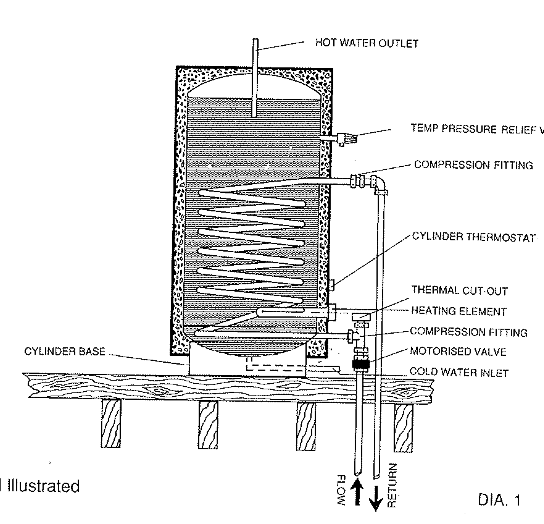

AliG Posted April 13, 2023 Posted April 13, 2023 Manual here - https://mediacdn.heatraesadia.com/-/media/themes/heatrae/literature/discontinued-literature/megaflo-cl-installation-manual.pdf?v=1&d=20170629T112101Z The heating element is at the bottom behind the cover.

MrTWales Posted April 13, 2023 Author Posted April 13, 2023 13 minutes ago, AliG said: This is an indirect tank. The boiler does not send hot water into it. It sends it into a coil that heats up the water in the tank. However, the coil is around half the height of the tank so will heat up most of the tank. The warmer water will take a while to rise inside the tank so the immersion will cut out when only some of the tank is hot. A 210L tank is not very large. It could conceivably be cooled considerably by two showers. 2 showers could be 150ish litres of hot water and the tank would be filling up with cold water and cooling down. What you may be noticing is that the immersion can only heat up 50l of water an hour, but the boiler can heat up 400l. If you spent 10 minutes in the shower and used 75l of hot water, the boiler could almost heat the water as fast as you were using it. Thus the water will not cool down anywhere near as much when two people have a shower and the boiler is on versus the immersion. Damn I really had no idea. I assumed that the water just flowed through a copper pipe in the boiler and this was sent into the tank via a loop!
AliG Posted April 13, 2023 Posted April 13, 2023 Instructions for your newer model- https://irp-cdn.multiscreensite.com/7d2b88c7/files/uploaded/megaflo he manual.pdf The red arrow is the main thermostat and the black one is the immersion. I would set the immersion to maximum and the red arrow to 55. Was the red arrow really set to the position in the pic you posted? That would be less than 40C. 1

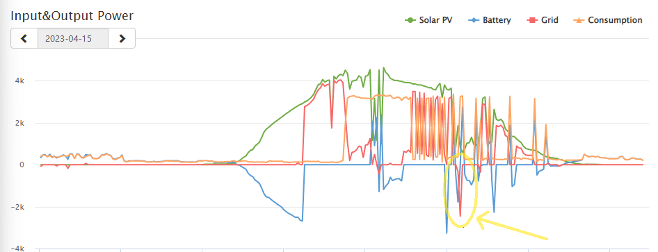

MrTWales Posted April 17, 2023 Author Posted April 17, 2023 I did wind up to 70, and I think it did make a big difference. Just checked and I've imported 4.0kWh for the whole month, and hardly any of it on the day of the chart. I was on my own that day and the immersion was the only thing with a large draw, so consumption was never high at any point.
Radian Posted April 17, 2023 Posted April 17, 2023 8 minutes ago, MrTWales said: I was on my own that day and the immersion was the only thing with a large draw, so consumption was never high at any point. Just wondered about the import spike at 5PMish. Nosey ain't I 🤣 Maybe an induction hob?
MrTWales Posted April 17, 2023 Author Posted April 17, 2023 19 minutes ago, Radian said: Just wondered about the import spike at 5PMish. Nosey ain't I 🤣 Maybe an induction hob? I can't see the spike on the chart but I do have an induction hob! I thought it was only 1kw though. It's something I never ever use in the winter but it may be worth using now, so long as the import spike is only small.
Radian Posted April 17, 2023 Posted April 17, 2023 14 minutes ago, MrTWales said: I can't see the spike on the chart but I do have an induction hob! I thought it was only 1kw though. It's something I never ever use in the winter but it may be worth using now, so long as the import spike is only small. You had cropped off the time axis legends so it may have been earlier than my guess of 5PM
MrTWales Posted April 17, 2023 Author Posted April 17, 2023 If it was consumption of 6kw I think the orange line would be at 6kw, with the solar/battery/grid making this up. That spike looks like those random (to me!) spikes that I see sometimes. What you say about the induction hob seems right in that this does cause some spikes, but I seem to get them anyway. I think the import as per the app slightly overstates the actual draw though, when I look at the actual meter readings. All I did that day was heat up my take away in the microwave!
