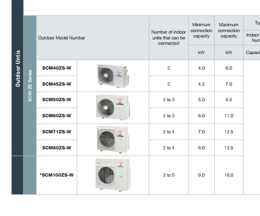

crispy_wafer Posted April 12, 2023 Share Posted April 12, 2023 Just to add my 2p for what it's worth, I've 2*2.5 (1 ducted,1 wall mount), and 2*3.5 ducted units going into the 3 bedrooms and 1 open plan kitchen/diner area, as mentioned above, once you settle on an installer and a chosen manufacturer you can download the brochures and see the condenser unit specs/and connection limitations. This is from MHI, but shows you the capacity limitations, there is also a page which shows acceptable combinations of indoor units too. My installer is happy for me to have an 8kW condenser installed as the maximum connection capacity is 13.5kW, though he did suggest a 10kW unit may be a better fit. Reason being that my use case will probably not involve running all units at full whack all at once, if that does happen then the indoor unit capacities are downrated (even downrated, I suspect they'll be fine on all but the most extreme of days, when it may just take a little longer to heat, or cool), the condenser isn't purchased yet, so still time to change my mind on this... My use case is that this is for supplemental heating for downstairs if needed, but primarily installed for cooling during the summer, & autumn, and upstairs will be primarily used for background heating in the winter & spring when required, but cooling in the summer, autumn. We'll have an ASHP for UFH downstairs, but no heating other than towel rads in the 2 bathroom spaces upstairs. Link to comment Share on other sites More sharing options...
