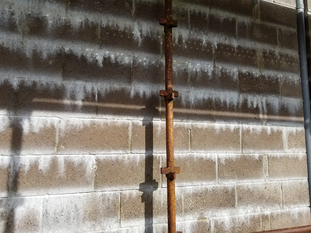

GrantMcscott Posted April 3, 2023 Share Posted April 3, 2023 Hi Can anyone advise what is the best way to remove efflorescence from block work before I put stone cladding on and get the house rendered? It is very thick and there is a lot of it what is the best thing to clean it off with have tried vingar with liitle effect except it started to make a fizling noise Link to comment Share on other sites More sharing options...
Mr Punter Posted April 3, 2023 Share Posted April 3, 2023 Stiff brush, jetwash. Link to comment Share on other sites More sharing options...
Canski Posted April 3, 2023 Share Posted April 3, 2023 Ok I meant to post this the other day but forgot. It comes from a professional brick cleaning company and they swear it works if carried out correctly. Link to comment Share on other sites More sharing options...
Temp Posted April 3, 2023 Share Posted April 3, 2023 (edited) Bond It Brick Acid says its 16% Hydrochloric acid. https://www.mgnbm.co.uk/bond-it-brick-acid-5-litres-bdh085/?srsltid=AfAwrE7vK1Ef8OIpidl1uLMnnFYdlaTwQGXqZfWfrOBEV9fPgfHS_PCgL8E Edited April 3, 2023 by Temp 1 Link to comment Share on other sites More sharing options...
GrantMcscott Posted April 3, 2023 Author Share Posted April 3, 2023 (edited) 2 hours ago, Canski said: Ok I meant to post this the other day but forgot. It comes from a professional brick cleaning company and they swear it works if carried out correctly. Hi Just interpreting you notes So I get hydrochloric acid 16% the one @Temp gave a link to. Spray it on wait until the fizzing stops - spray on again wait until fizzing stops this process should not take more than 2 minutes then presure washer off Is that correct not sure why you note has 2 references to hydrochloric acid at the top thanks Edited April 3, 2023 by GrantMcscott Link to comment Share on other sites More sharing options...
Canski Posted April 3, 2023 Share Posted April 3, 2023 (edited) 3 hours ago, GrantMcscott said: Is that correct not sure why you note has 2 references to hydrochloric acid at the top thanks I just passed it on but I looked and it seems to refer to hydrohalic acid and hydrocloric acid Edited April 3, 2023 by Canski Link to comment Share on other sites More sharing options...
