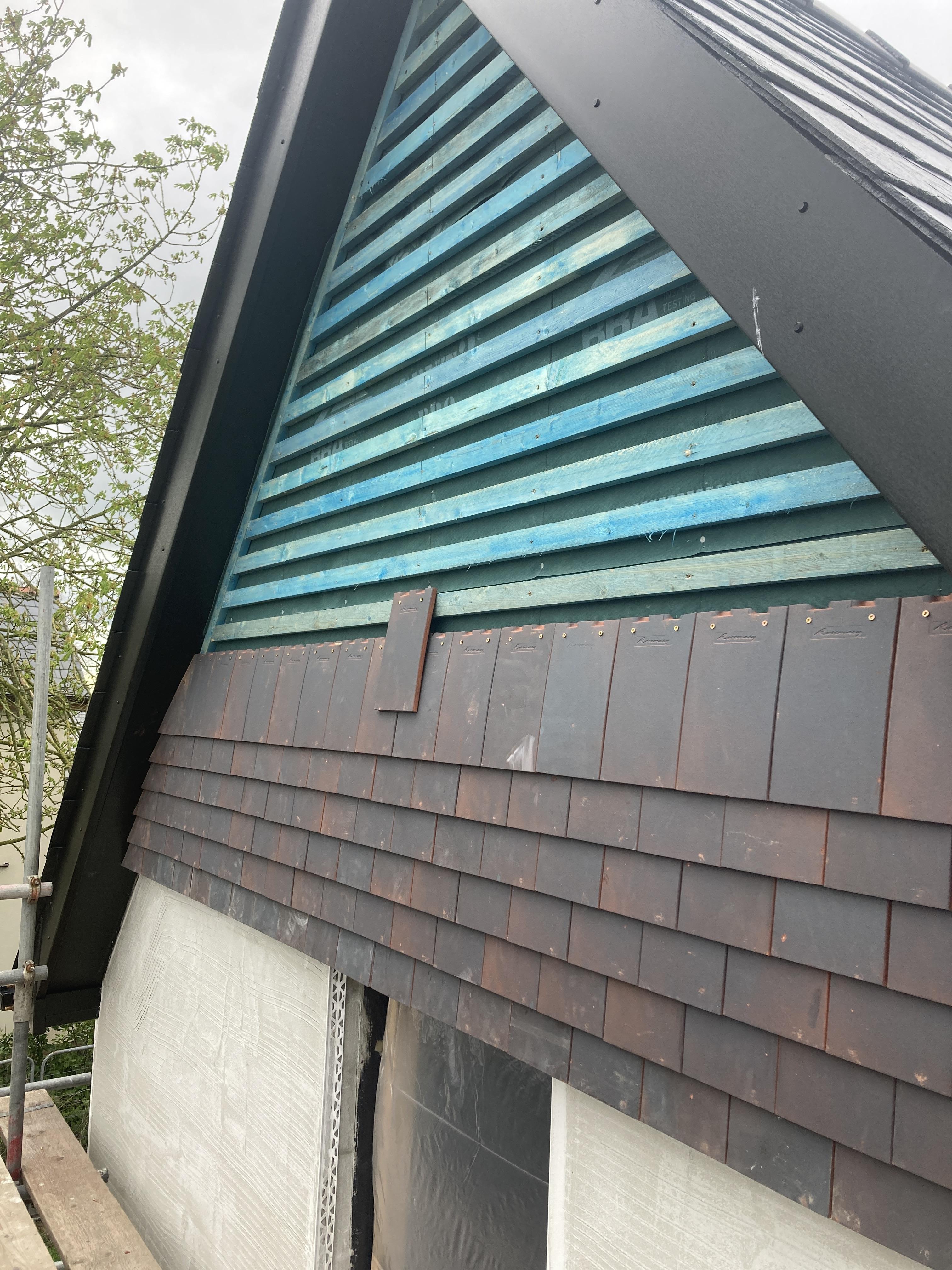

nod Posted April 1, 2023 Posted April 1, 2023 I’m just batoning out two pikes for hanging tiles I’m on to masonry so no choice but to use screws Using rings nails would be far quicker and better Also much cheaper than SS screws
Thorfun Posted April 1, 2023 Posted April 1, 2023 I used 90mm ring nails for ours. Was really quick and I used the battens as a climbing frame to reach other areas at points and they didn’t budge. I’d be asking for specifics as to why you’ve been told screws.
nod Posted April 1, 2023 Posted April 1, 2023 It’s taken me all day to baton and counter this small pike Very slow with screws 1

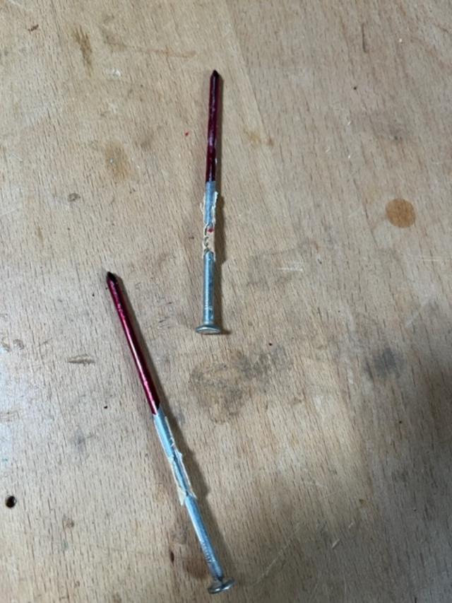

markharro Posted April 4, 2023 Author Posted April 4, 2023 On 01/04/2023 at 08:23, Thorfun said: I’d be asking for specifics as to why you’ve been told screws. Just said 4mm diameter screws with no mention of whether they are to be SS or otherwise. I have a box of smooth shank 90mm nailgun nails so had hoped to use those. I know they are not annular but I had read somewhere that the tips have a glue covering that heats up on insertion to glue to the wood fibres. No idea if thats correct? If I do use screws I have read guidance elsewhere thats states 6mm! Also what length do I need for a 50mm batten. And I am totally confused by all the various designs of single and double threads and other more subtle variations.
Mr Punter Posted April 5, 2023 Posted April 5, 2023 50 x 50 is quite big. Maybe 38 x 50 would still be OK. I would go with heavy duty galv nails 90mm. Either ring shank or smooth with the glue. There is still enough room for embedment for your nails on the (25 x 50?) horizontal battens. I would use 63mm stainless ring shanks for the horizontals.
markharro Posted April 5, 2023 Author Posted April 5, 2023 Hi @Mr Punter are these nails glue coated ie is the red colour glue?
Mr Punter Posted April 5, 2023 Posted April 5, 2023 The actual Paslode ones are blue but expensive. Make sure they are hot dipped galv. When you pull one out a load of timber fragments stay stuck to the nail.
markharro Posted April 5, 2023 Author Posted April 5, 2023 Thanks - will these have as much holding power as annular nails of the same length?
Mr Punter Posted April 5, 2023 Posted April 5, 2023 I think they are similar. The ones in your pic will be fine.
