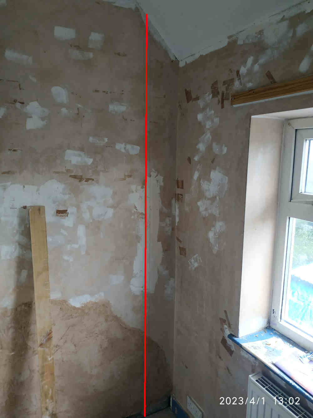

JohnBishop Posted March 31, 2023 Posted March 31, 2023 Hi All, I am in the process of installing an electric shower but I have to run a 10mil cable from the consumer unit to upstairs bedroom then along the wall to the loft and from there to run it to the bathroom. Where or can I get a capping for a 10mil cable? By capping I mean this plastic cover thing that goes over the wire. I am going to chisel away some plaster to make space for this wire but I think I need to further protect it from accidental drill damage or nails. Please advise.
SteamyTea Posted March 31, 2023 Posted March 31, 2023 Do you mean this stuff https://www.screwfix.com/p/tower-upvc-white-mini-trunking-25mm-x-16mm-x-2m/81974 1
ProDave Posted March 31, 2023 Posted March 31, 2023 Top hat capping is not to provide any protection against people drilling into it. It is just something to hold it in place to make it easier to plaster over. You must route the cable in safe zones, so in theory at least people know a cable might be there and avoid drilling into it. You talk of running it horizontally (along the wall) hints that you are not aware of safe zones. A much better route up to a loft is up through a cupboard or built in wardrobe where it can be run in conduit like @SteamyTea post above without being an eyesore. 1

JohnBishop Posted April 1, 2023 Author Posted April 1, 2023 On 31/03/2023 at 08:12, ProDave said: Top hat capping is not to provide any protection against people drilling into it. It is just something to hold it in place to make it easier to plaster over. You must route the cable in safe zones, so in theory at least people know a cable might be there and avoid drilling into it. You talk of running it horizontally (along the wall) hints that you are not aware of safe zones. A much better route up to a loft is up through a cupboard or built in wardrobe where it can be run in conduit like @SteamyTea post above without being an eyesore. not horizontally but straight up. I wish there were some conduits or cupboards but there is none. I mark it on the skirting and on the ceiling. I don't know
ProDave Posted April 1, 2023 Posted April 1, 2023 to be in a safe zone it must be within 150mm of the corner of the room. http://wiki.diyfaq.org.uk/index.php/Safe_zones_for_electric_cables 1
JohnBishop Posted April 1, 2023 Author Posted April 1, 2023 (edited) I get some uT reading around 1/3 distance from the floor which tells me there could be some wire in there but I does not go vertically or horizontally anywhere just a spot closer to the corner. There are no sockets in the loft so the it could only be some cable for lighting. Perhaps I will have to resort to using trunking. Edited April 1, 2023 by JohnBishop
