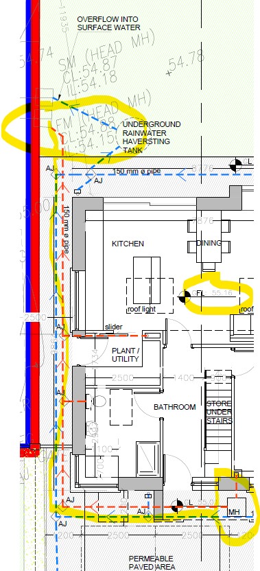

My Finished Floor Height is 55.16 and my invert level is 54.15 so I have a meter fall to play with. The Foundation buildup is 550mm to the hardcore where the pipes will be laid so a 150mm sewer pipe would have an invert level 300mm above the drain it will ultimately connect to. The longest run would be 5m + 10m + 5m (Front of house, side of house, to foul drain) so 20m. With a 1:60 fall that should work ok shouldn't it? I can decrease the foundation depth to get more drop but wanted to sanity check if this looks ok here before I commit to the foundation design in a couple of weeks time. Thank you!
Why are you using 150mm pipe. 110mm is standard, it might connect to a larger pipe but the one from the house will be 110, that might give you a bit more wiggle room.
ok, my bad, let's call it 4" ?!! But overall my sh*t won't congeal to a halt with a fall of 350mm over 20 m?

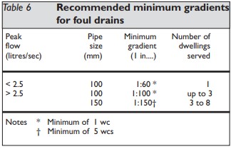

1:60 is fine. Just make sure it goes in to that all the way and doesn't have flatter areas.
As the table shows, flatter is ok for heavier flow which you will probably have occasionally.
110mm will flow better than 150mm because the flow is more concentrated/deeper.
1 in 60 is fine on paper but if you are slightly off when laying the pipes then you've hardly any margin for error. I'd be decreasing the cover on your pipes where they leave the house to get you the little bit more fall. You can have the pipes come though the wall at any depth really, just need sufficient build over the pipe.
