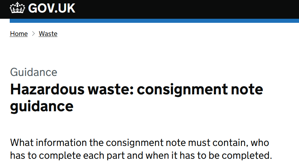

Furnace Posted March 28, 2023 Author Share Posted March 28, 2023 I've made it clear, and the written quotation confirms, the requirement for a pukka consignment note 1 Link to comment Share on other sites More sharing options...

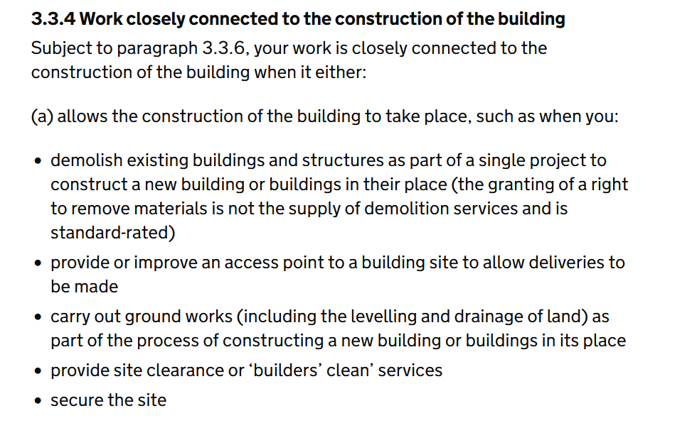

Furnace Posted March 29, 2023 Author Share Posted March 29, 2023 12 hours ago, saveasteading said: Looks to me like you have a lot more than 400m2m though, esp including the walls It's only the 2 barns nearest the camera, but I'll add 20% on to the area to allow for sheet overlap. Dunno about the VAT. Are demolition and ground works zero VAT for new-build? It's possible I could reclaim it through the farm accounts, as I'll be putting a new building up elsewhere, but I always err on the side of caution with this sort of thing. Thoughts? Link to comment Share on other sites More sharing options...
Furnace Posted March 29, 2023 Author Share Posted March 29, 2023 I just found these: https://community.hmrc.gov.uk/customerforums/vat/7572b7b5-e2dc-ec11-b5cf-00155d9c7b3a And demolition is specifically mentioned in the guidance notes for HMRC 708: Looks quite hopeful that the demolition would be zero-rated. I'll need to discuss with the demo company. Link to comment Share on other sites More sharing options...
saveasteading Posted March 29, 2023 Share Posted March 29, 2023 Vat reclaim has to be for works as on the PP. Perhaps that requires you holding off until the permission you need is confirmed. Link to comment Share on other sites More sharing options...
Furnace Posted March 29, 2023 Author Share Posted March 29, 2023 Yup, I won't be doing anything until the application is determined. The demo chap confirmed that he is happy to zero rate the invoice as along as he has a copy of the planning permission. Link to comment Share on other sites More sharing options...
