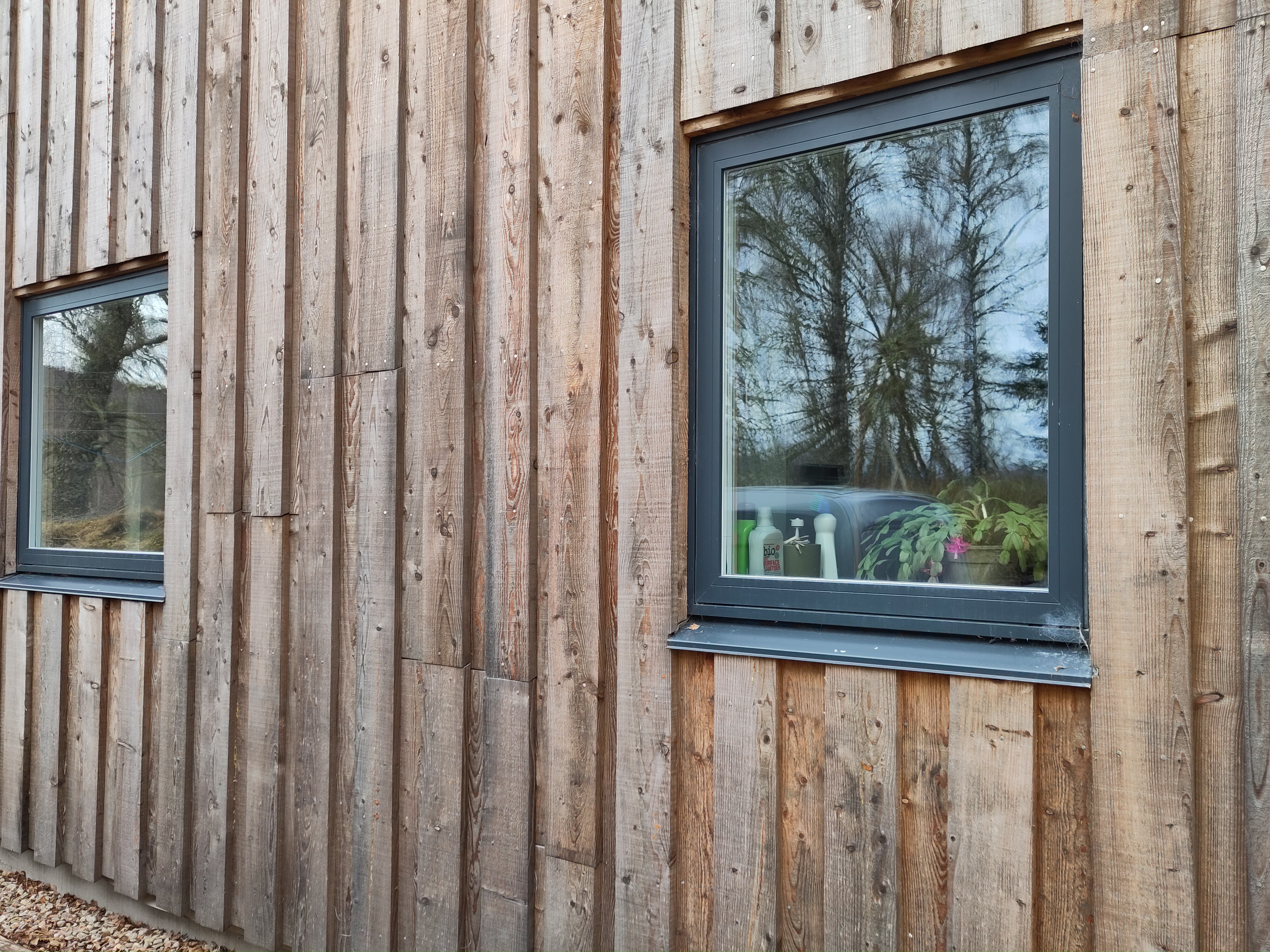

Jenki Posted March 19, 2023 Share Posted March 19, 2023 43 minutes ago, jamieled said: We reduced the gap between boards with boards beside windows and doors butting up with the reveal cladding. Needs relatively careful calculation to ensure you get the gaps right and so theres no obvious visible difference when viewed against the rest of the walls. @jamieled do you have any photo's of this detail? Link to comment Share on other sites More sharing options...

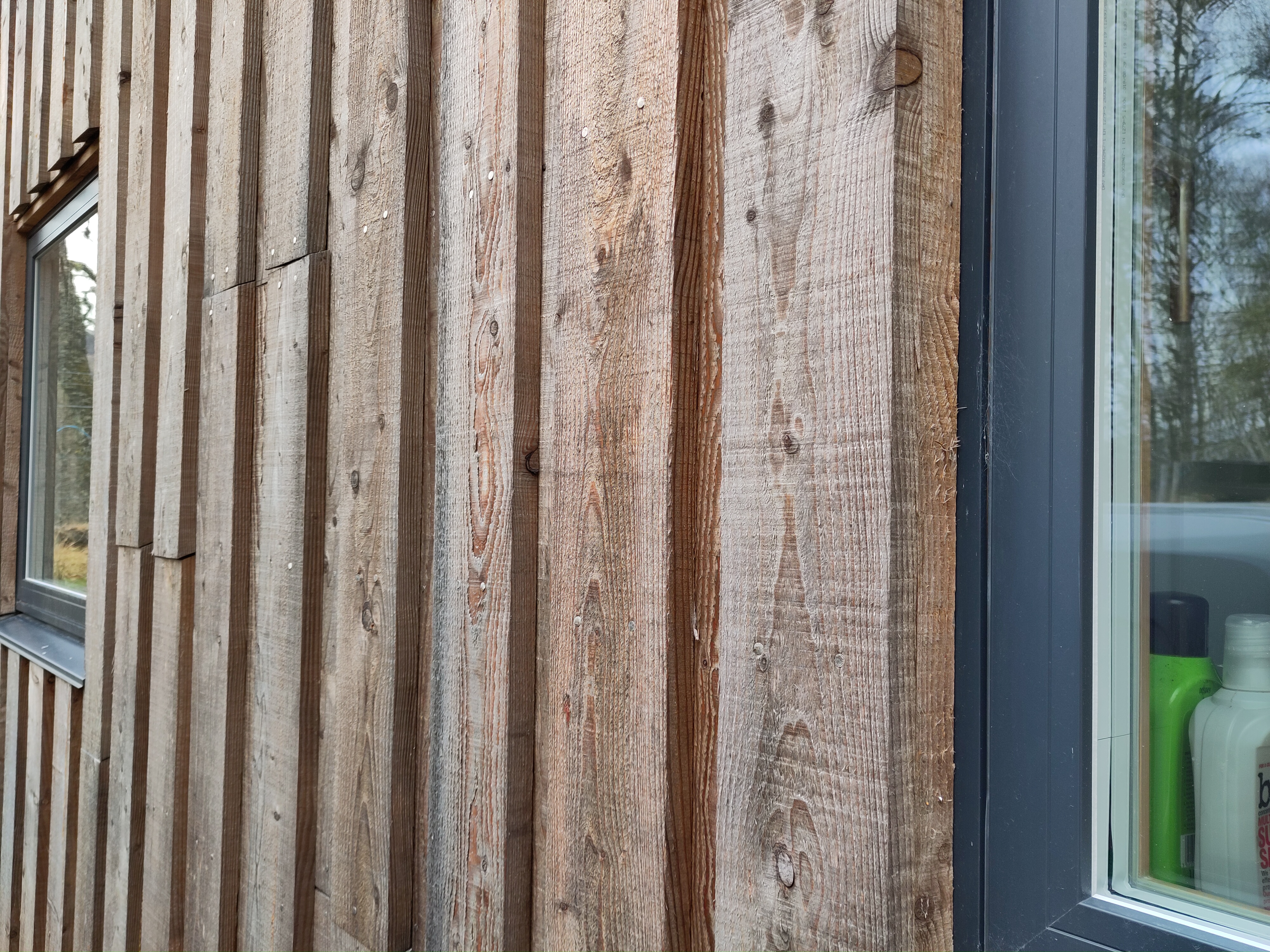

jamieled Posted March 19, 2023 Share Posted March 19, 2023 @eandg, yes, but our design was simpler as our windows were similar sizes between ground and first floor so butting the 'on board' sections up to the reveals wasn't so difficult. You sound like you might have a trickier situation, but I'd imagine with some careful planning you should be able to get it to look ok. Differences in the spacing are only really visible if you look hard enough, at a distance I think it looks pretty consistent, even when it isn't. @Jenkisee if these help you. The change in spacing is quite clear if you look hard enough, but it doesn't bother us, functions fine and nobody mentions it! 1 Link to comment Share on other sites More sharing options...
Jenki Posted March 19, 2023 Share Posted March 19, 2023 26 minutes ago, jamieled said: @eandg @Jenkisee if these help you. The change in spacing is quite clear if you look hard enough, but it doesn't bother us. @jamieled Thanks, looks great👍 Link to comment Share on other sites More sharing options...
eandg Posted March 20, 2023 Author Share Posted March 20, 2023 23 hours ago, jamieled said: @eandg, yes, but our design was simpler as our windows were similar sizes between ground and first floor so butting the 'on board' sections up to the reveals wasn't so difficult. You sound like you might have a trickier situation, but I'd imagine with some careful planning you should be able to get it to look ok. Differences in the spacing are only really visible if you look hard enough, at a distance I think it looks pretty consistent, even when it isn't. @Jenkisee if these help you. The change in spacing is quite clear if you look hard enough, but it doesn't bother us, functions fine and nobody mentions it! The TTF guidance says you should never nail/screw through an underside board - did you manage to avoid doing so in that arrangement or did it prove impossible to avoid? Not sure if it's much to get worried about. Link to comment Share on other sites More sharing options...
jamieled Posted March 21, 2023 Share Posted March 21, 2023 @eandg in general yes, because we had a 'typical' overlap, it was generally possible to avoid the situation you describe. However, I reckon there are probably a few areas where we reduced the board spacing which resulted in nailing through the underboards - if you don't then the surface nails need to be really close together which risks cupping the outer board. Link to comment Share on other sites More sharing options...
