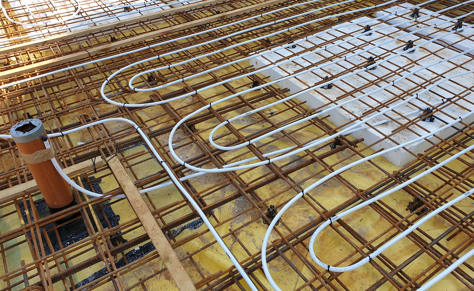

Temperature/humidity sensors for concrete slab for when ASHP run in cooling mode - what do I need?
On 17/03/2023 at 17:37, Dan F said:
Assuming you can use 1-wire sensors, get a pack of DS18B20 sensors.
Hi @Dan F I am thinking I may aim to instal 2 or 3 of these sensors. I see the chat about there being a lot of counterfeits around. Do you have a link to where I can buy the real deal - ideally with a long enough wire to stretch to above slab level?
What is the logic behind putting them in plastic pipe - to be able to replace easily if they ever break? WHat is the minimum kit I would need to connect them to a display on the wall to show the temps? thanks
I bought some overpriced Loxone ones with 2.5m lead.  There are packs on amazon with 5-star reviews and 3m leads.  In terms of buying the real deal, I guess the best you could do is buy from somewhere like RS instead of Amazon.
Putting them in UFH pipe is easy and then you can just push sensors into the pipes once the concrete is down and you don't risk the sensor lead ending up in the concrete or the sensor getting squashed or stepped on.  I can't easily change my sensors as they all come up, and are connected, inside stud work and behind plasterboard, but I guess if I needed to I could get to them vs. them being concreted in.
Thanks - so actually all I need to do atm is to bury some sections of tube - any recommendations on how deep into the slab to fit the tube - right down to the bottom for example? Ours will be a 150mm slab?
I used UFH pipe off-cuts and formed them into L shapes with a fairly shallow bed.  One else I squashed to close and the other end I left open and then I taped both ends. I then attached the horizontal section to mesh with cable ties and the vertical portions I had sticking up clear of the final slab level.  Where possible I brought these up next to SVP pipes which was quite convenient, but otherwise, they come up in locations which I knew would be within stud walls.

I have done the same @Dan F now so will have the option to fit temp probes down the line. Is there any cheap and easy to set up digital display I can get to wire the probes to so I can observe the temps visually?
thermopro tp25, I know the probes are for meat but I don't see they cannot be modified/replaced/thinker with.
