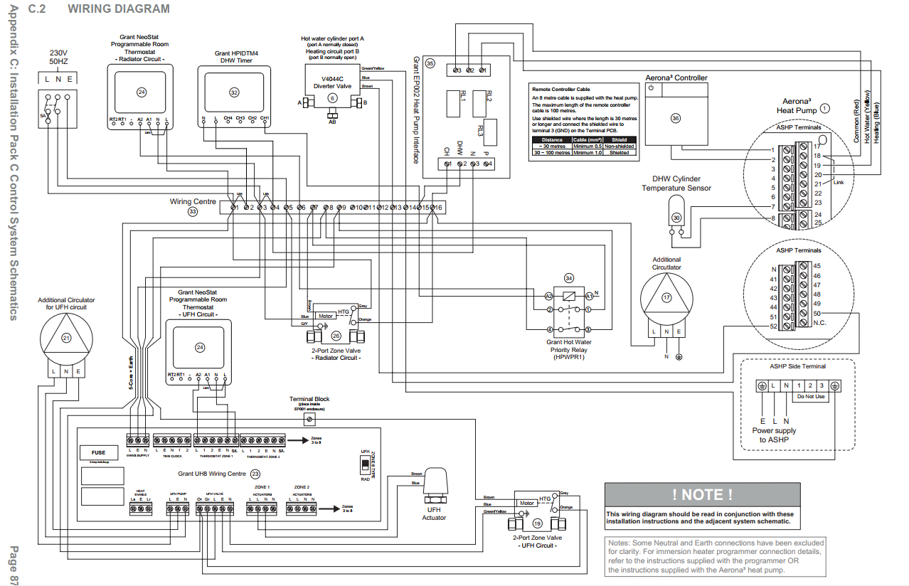

Just looking at the electrical schematic for my Grant HP, as I'm trying to work out how many cables I need run out to the heatpump (All in the name of making penetrations and sealing up), I need a bit of help, could someone give a once over for me please?
So excluding the electric supply.
1*3 core from Grant EP002 Interface
1*3 Core from Wiring centre
1*2 Core from Controller
1*2 core from HW Cylinder
Does that seem right?
That looks right.
The cable entry detail on the outside ASHP unit is not the best and getting multiple cables in is not easy.  It is better if you can get a length of say 12 core control cable and run one length of that from the ASHP unit to the inside wiring centre.
