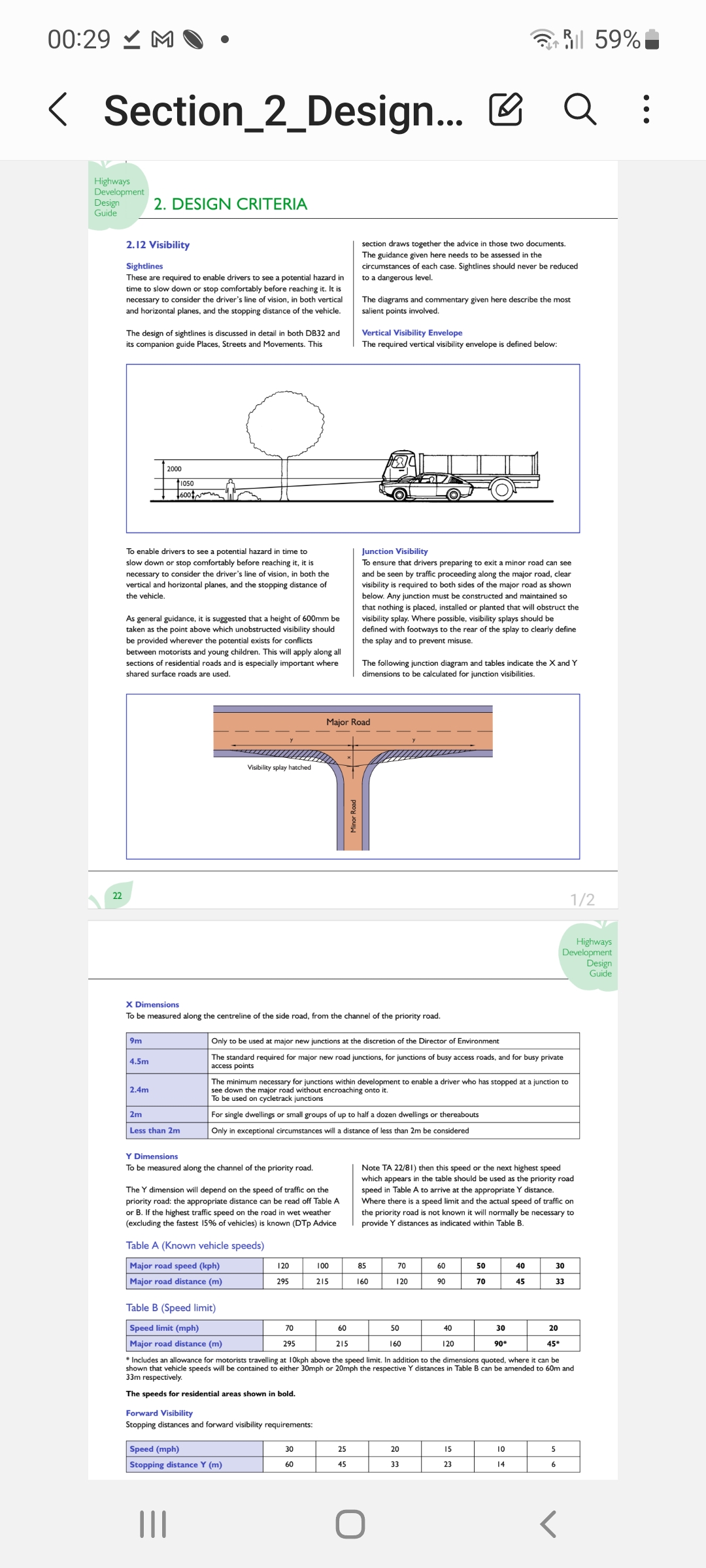

fiaraziqbal Posted March 11, 2023 Share Posted March 11, 2023 HI all, I am creating new access to my croft and submitting more plans, now the access has to conform to Planning Authority legislation and i just cannot seem to find this? I have Googled, and read through a stack of legislation but to no avail. Any guidance would be helpful as i just need the legislation and a few curves on my site map. Thanks all Link to comment Share on other sites More sharing options...
ProDave Posted March 11, 2023 Share Posted March 11, 2023 Visibility Splay is the term you need to search your councils planning website for their requirements. Link to comment Share on other sites More sharing options...

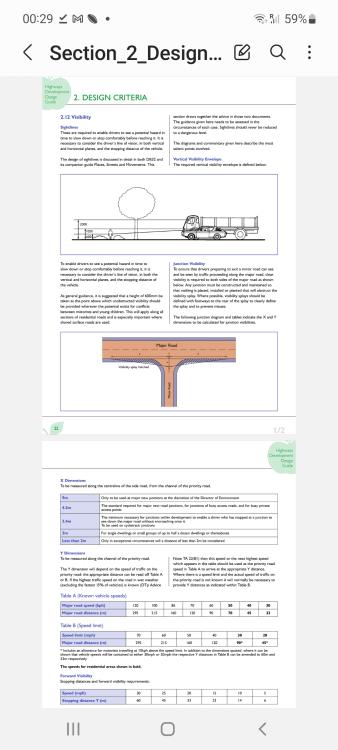

saveasteading Posted March 11, 2023 Share Posted March 11, 2023 Easy to find. Google Highways, sightlines. 1 page attached. The principle is that you are sitting in your car, so you are low down and back from the road. How far can you see each way? It depends on the road speed, but you could make a special case if the road could not be driven at that speed. 1 Link to comment Share on other sites More sharing options...
Jenki Posted March 12, 2023 Share Posted March 12, 2023 This is the Scottish one I used. Looks different the the post above. trbo-advice-on-planning-for-small-development-march-2016 (1).pdf Link to comment Share on other sites More sharing options...
saveasteading Posted March 12, 2023 Share Posted March 12, 2023 28 minutes ago, Jenki said: Looks different the the post above. From a quick look, the fundamentals are the same, both referring to the same document. 1 Link to comment Share on other sites More sharing options...
Kelvin Posted March 12, 2023 Share Posted March 12, 2023 44 minutes ago, Jenki said: This is the Scottish one I used. Looks different the the post above. trbo-advice-on-planning-for-small-development-march-2016 (1).pdf 397.07 kB · 4 downloads The one I used. Search the local planning portal to see some examples. However, if you follow that document it’s straightforward. 1 Link to comment Share on other sites More sharing options...
