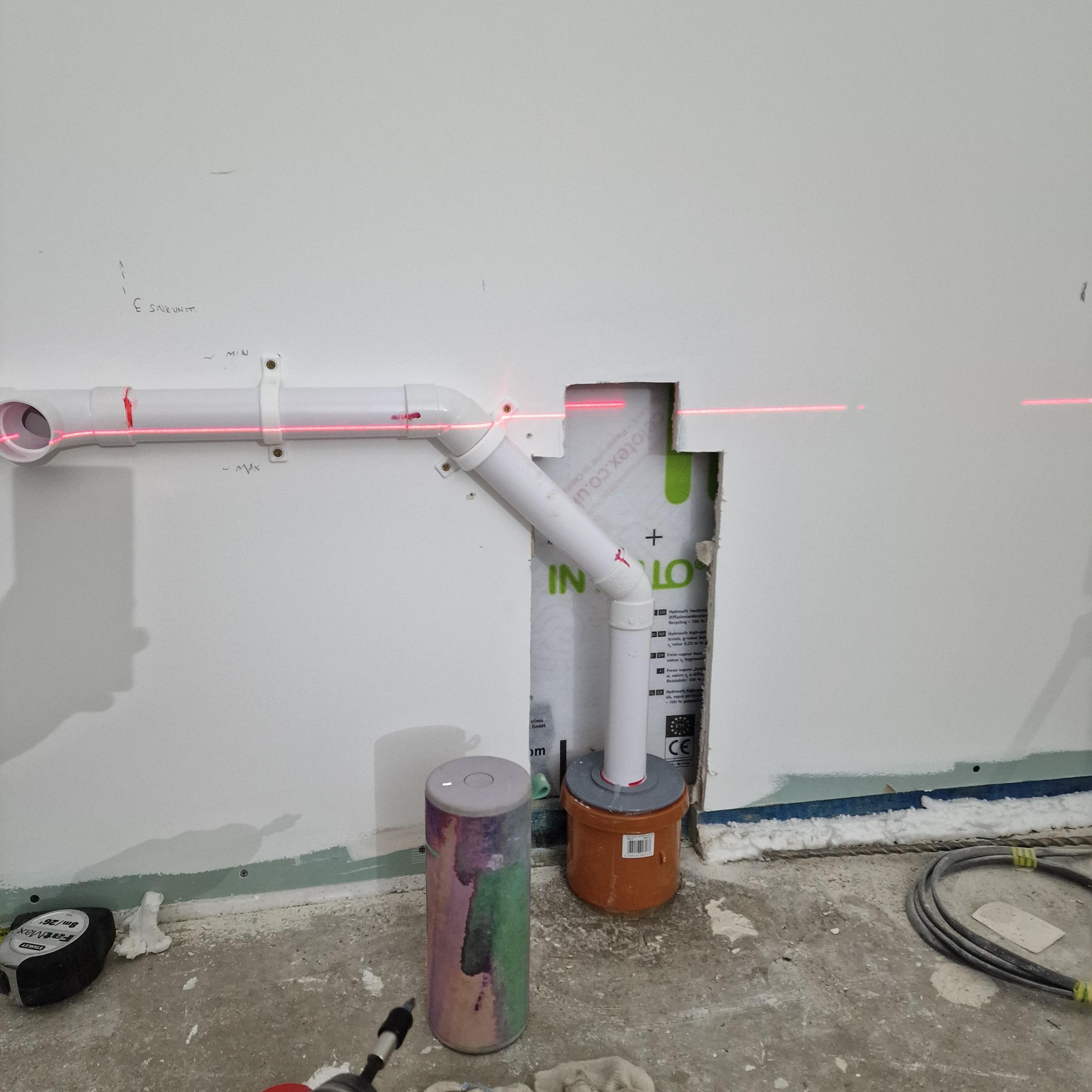

I've got a kore insulated foundation.
I just popped 110mm pipes up where I needed them. You can then run kitchen wastes or toilets into them.
You get 110mm to 40mm reducers and solvent weld boss adapters. Like picture as shown.
  • Thanks 2
