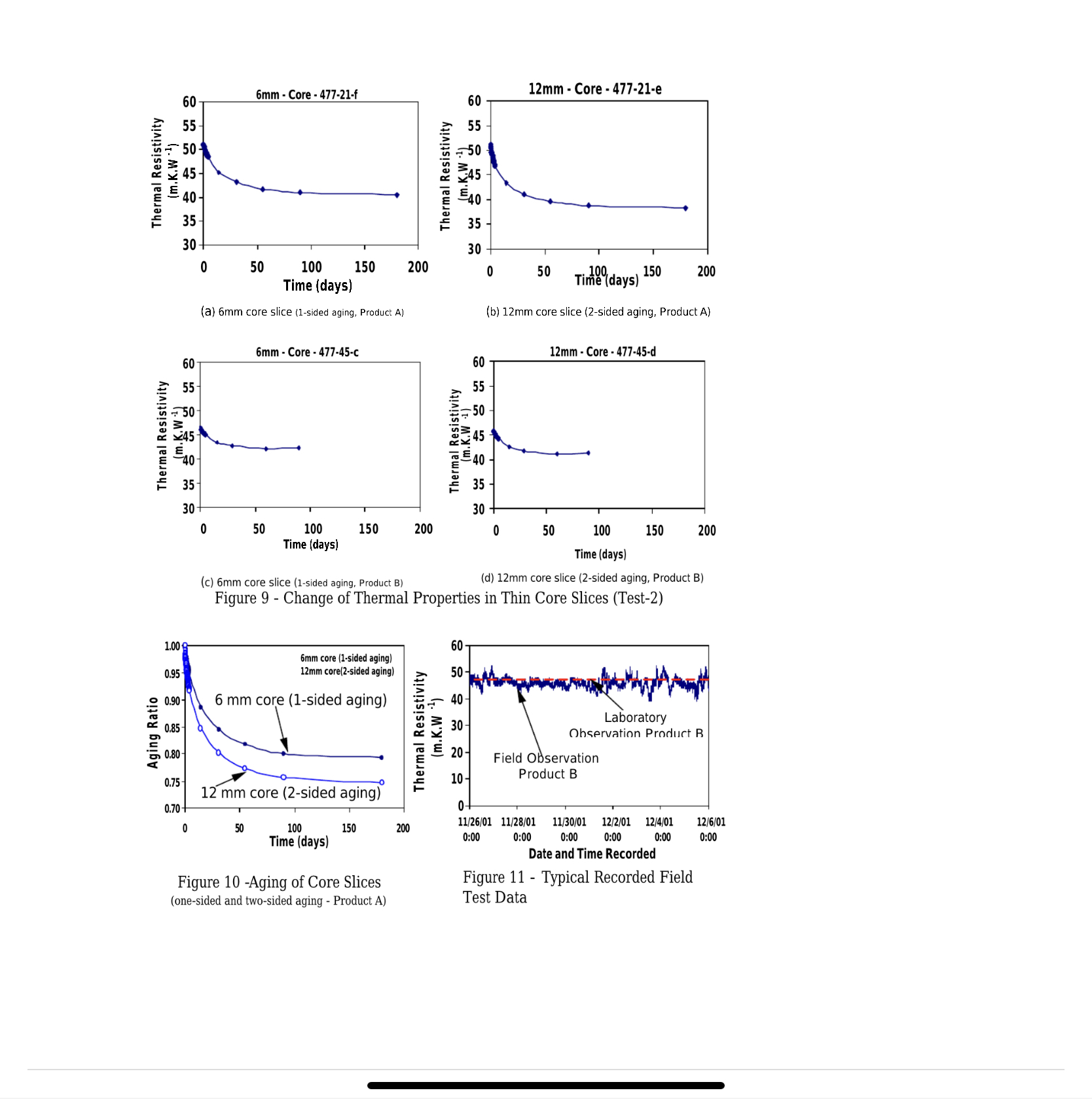

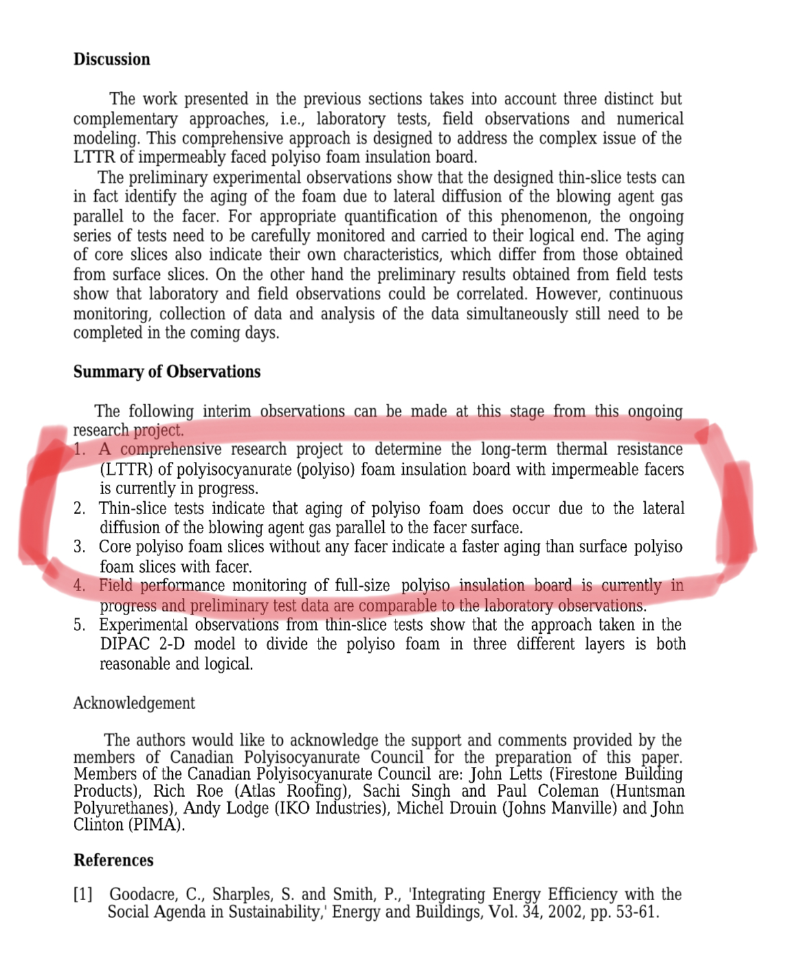

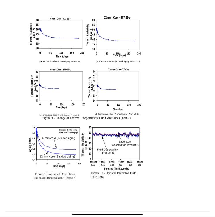

Iceverge Posted March 9, 2023 Share Posted March 9, 2023 Technically he may be right. One of the reasons I prefer EPS. I'm not sure if the products have improved since this test but it shows with no facer the insulation degrades faster. https://www.researchgate.net/publication/44073583_Long-term_thermal_resistance_of_Polyisocyanurate_foam_insulation_with_impermeable_facers Link to comment Share on other sites More sharing options...
ADLIan Posted March 9, 2023 Share Posted March 9, 2023 18 minutes ago, Iceverge said: Technically he may be right. One of the reasons I prefer EPS. I'm not sure if the products have improved since this test but it shows with no facer the insulation degrades faster. https://www.researchgate.net/publication/44073583_Long-term_thermal_resistance_of_Polyisocyanurate_foam_insulation_with_impermeable_facers Most of the blowing agent loss, hence loss in thermal performance, is through the top and bottom faces and is accounted for in the declared lambda value. The foil facings slow this process hence foil faced PUR has a lower lambda than product with glass tissue or bituminous facings. Edge losses are minimal. The foil-facing is a complex laminate of al foil, kraft paper and polyethylene and is adhered to the uncured, liquid foam in the manufacturing process. Adding a self adhesive foil tape to the edges would not be gas tight and would make no difference. Link to comment Share on other sites More sharing options...
Iceverge Posted March 9, 2023 Share Posted March 9, 2023 1 hour ago, ADLIan said: Edge losses are minimal. Any more info on the edge leakage for further reading? Link to comment Share on other sites More sharing options...
