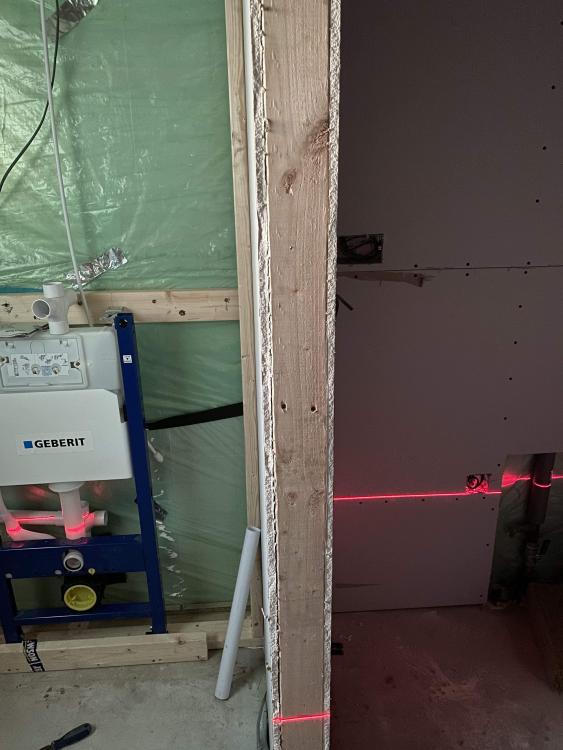

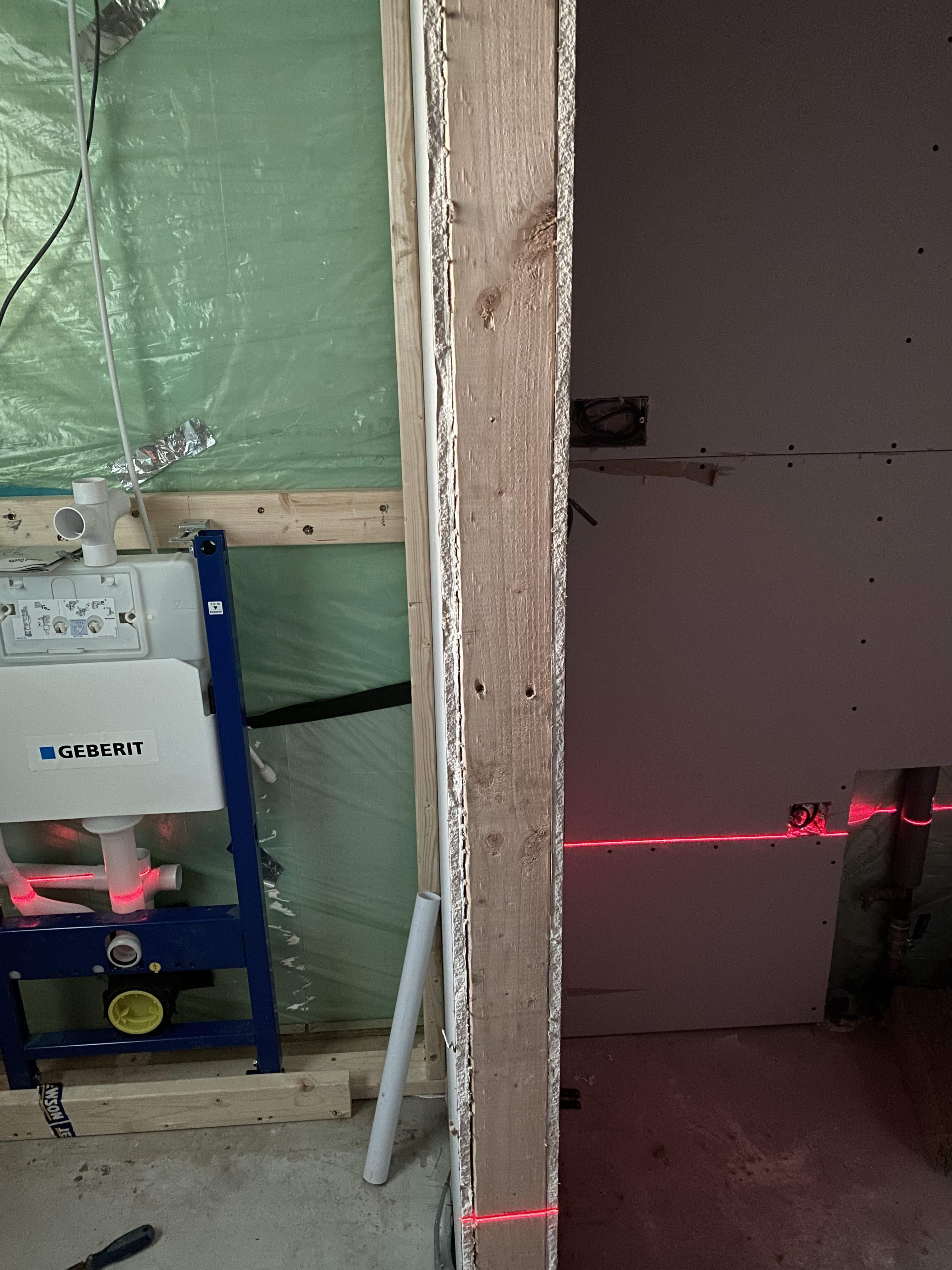

jayc89 Posted April 19, 2023 Author Posted April 19, 2023 Think I might have balls'd up on my levels I need to run a length of 40mm from behind the W/C frame, through the stud wall across to where the water mains comes up (insulated pipe on the right hand side of the pic). It's bang on the bottom of the single socket. I can drop the tee behind the w/c 2cm max, what's the minimum fall I can get away with for a Utility sink/washing machine waste?
ProDave Posted April 19, 2023 Posted April 19, 2023 If it's just the socket that is the issue, move the socket.
jayc89 Posted April 19, 2023 Author Posted April 19, 2023 20 minutes ago, ProDave said: If it's just the socket that is the issue, move the socket. My OCD's getting the better of me as there's another single socket out of shot to the right at the same height as the one in question, so I'd be tempted to move that one as well. Even if I can get the pipe in below the sockets current location, it's going to make plugging anything in a PITA.
ProDave Posted April 19, 2023 Posted April 19, 2023 2 minutes ago, jayc89 said: Even if I can get the pipe in below the sockets current location, it's going to make plugging anything in a PITA. I thought the pipe was going IN the wall.
jayc89 Posted April 19, 2023 Author Posted April 19, 2023 2 minutes ago, ProDave said: I thought the pipe was going IN the wall. It'll be in the wall on the left, behind the W/C frame, surface mounted on the right, as that will be behind utility units (washing machine, sink etc).
ProDave Posted April 19, 2023 Posted April 19, 2023 4 minutes ago, jayc89 said: It'll be in the wall on the left, behind the W/C frame, surface mounted on the right, as that will be behind utility units (washing machine, sink etc). So sockets are for WM etc so will not be on view. Stand down the OCD and put the sockets wherever fits once the pipe is in.
jayc89 Posted April 20, 2023 Author Posted April 20, 2023 9 hours ago, ProDave said: So sockets are for WM etc so will not be on view. Stand down the OCD and put the sockets wherever fits once the pipe is in. What's the best way to patch the old hole? Screw a couple of strips of PB behind the wallboard, glue and screw a new piece of PB to that followed by FibaTape?
ProDave Posted April 20, 2023 Posted April 20, 2023 A wooden batten slotted behind and screwed either side then a square of plasterboard screwed or glued to the batten. Joint filler to make good the gap. the square cut for the new socket location should be just the right size to fill the old hole. 1
