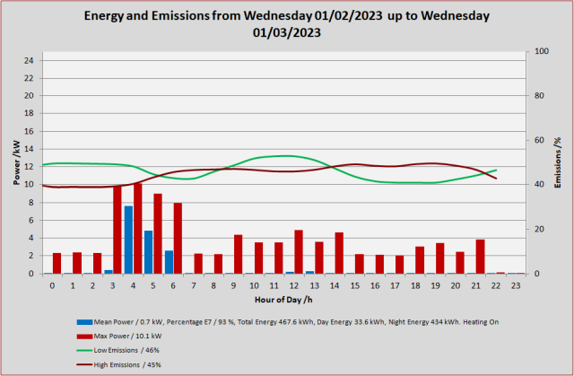

SteamyTea Posted March 6, 2023 Share Posted March 6, 2023 8 hours ago, markharro said: crazy amount of cost for the storage capacity compared to the cost of a car battery. Does a different job. A car battery has to deliver a huge amount of power for a second or two, then has a long time to be recharged. It also has to work in extreme temperatures i.e. -20°C to + 80°C. If I take my mean usage profile, and exclude the space and DHW heating period, my mean power usage is 80W over 21 remaining hours, with a maximum power draw of 10.1 kW. I am not sure what size battery system would be needed for this, 5 kWh?, and an inverter that can reliably deliver say 12 kWp. It would also have to be able to cope with the 16.3 hours a day when the house is drawing zero power (well less than a watt). Some inverters need a minimum power draw to work reliably (have read that this is 200 W). I don't think that battery storage is financially, technically or environmentally worth while at the moment. I also suspect that the generation companies, who are already investing £millions in storage, are going to have a lower £/kWh than any domestic installation. Link to comment Share on other sites More sharing options...
