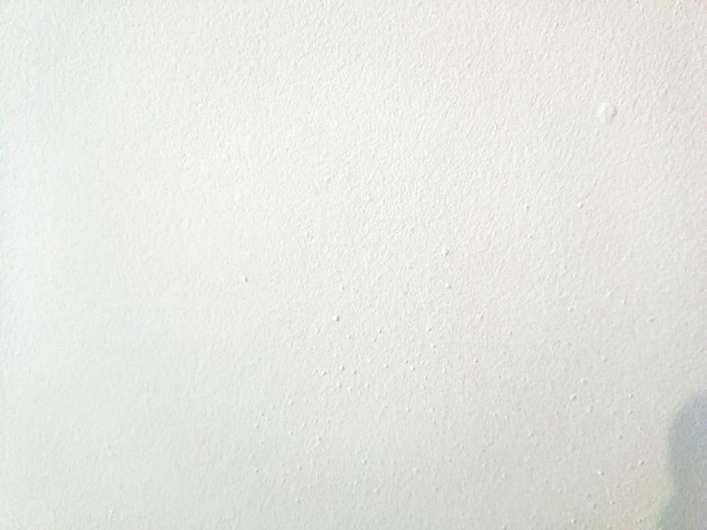

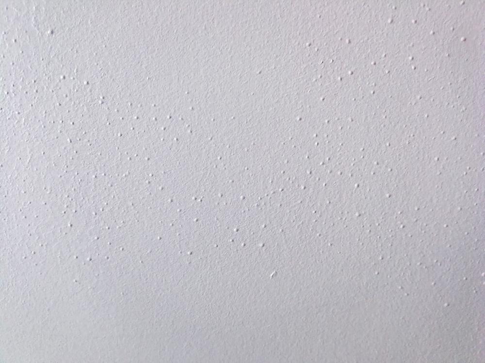

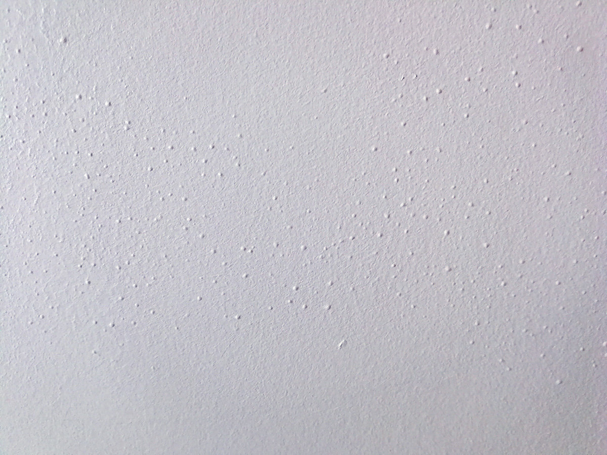

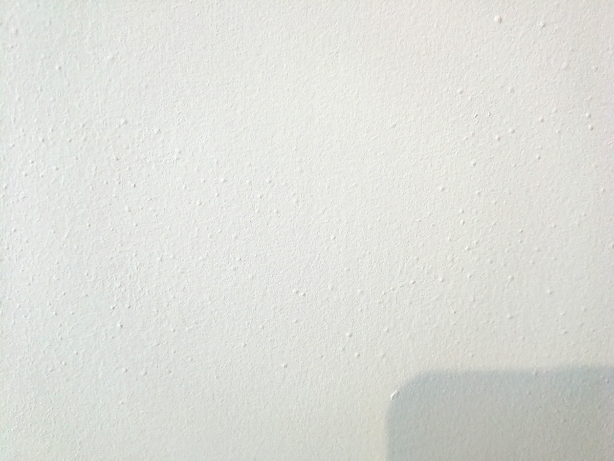

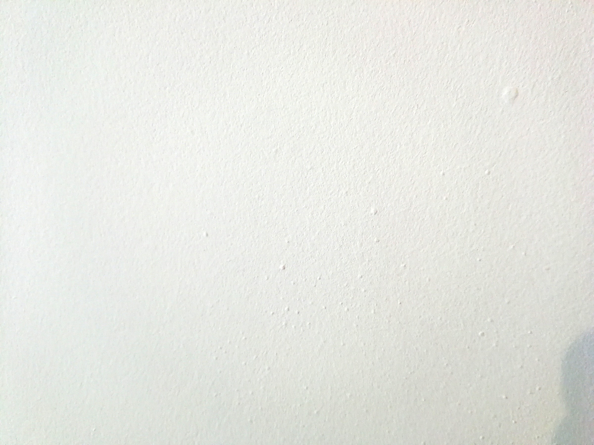

First time I've had this issue so hoping someone knows what's going on.
I've skimmed two rooms with jointing compound to get rid of orange peel finish, sanded smooth and primed Leyland acrylic primer undercoat.
In one room 3 walls are fine, and 1 wall has this issue. In the other room 2 walls are having problems.
For the room with one wall having issues:
I applied a diluted coat of Leyland acrylic primer to seal the plaster, sanded with 240 grit, and then one coat of Tikkurila Optiva 3
The colour was far too strong so I sanded and put on a coat of Leyland acrylic primer with a roller to start neutralising it (hoping for better coverage than a standard white emulsion).
And randomly across the wall I'm getting blisters, from under 0.5mm to 3mm+ across. Sometimes singly, but the smaller ones in groups.
They flatten a bit as the paint dries but don't go flat. If I sand them off it blisters in the same place the next time.
I've tried thinning the primer, to see if that helps (it doesn't)
I've applied multiple coats and the bubbles keep happening in the same spots.
I'm ready to blame the paint as the walls I did with Tikkurila didn't have this problem. But neither did other walls I painted with primer.
What do you think?
Photos while it's still wet
And once dried:

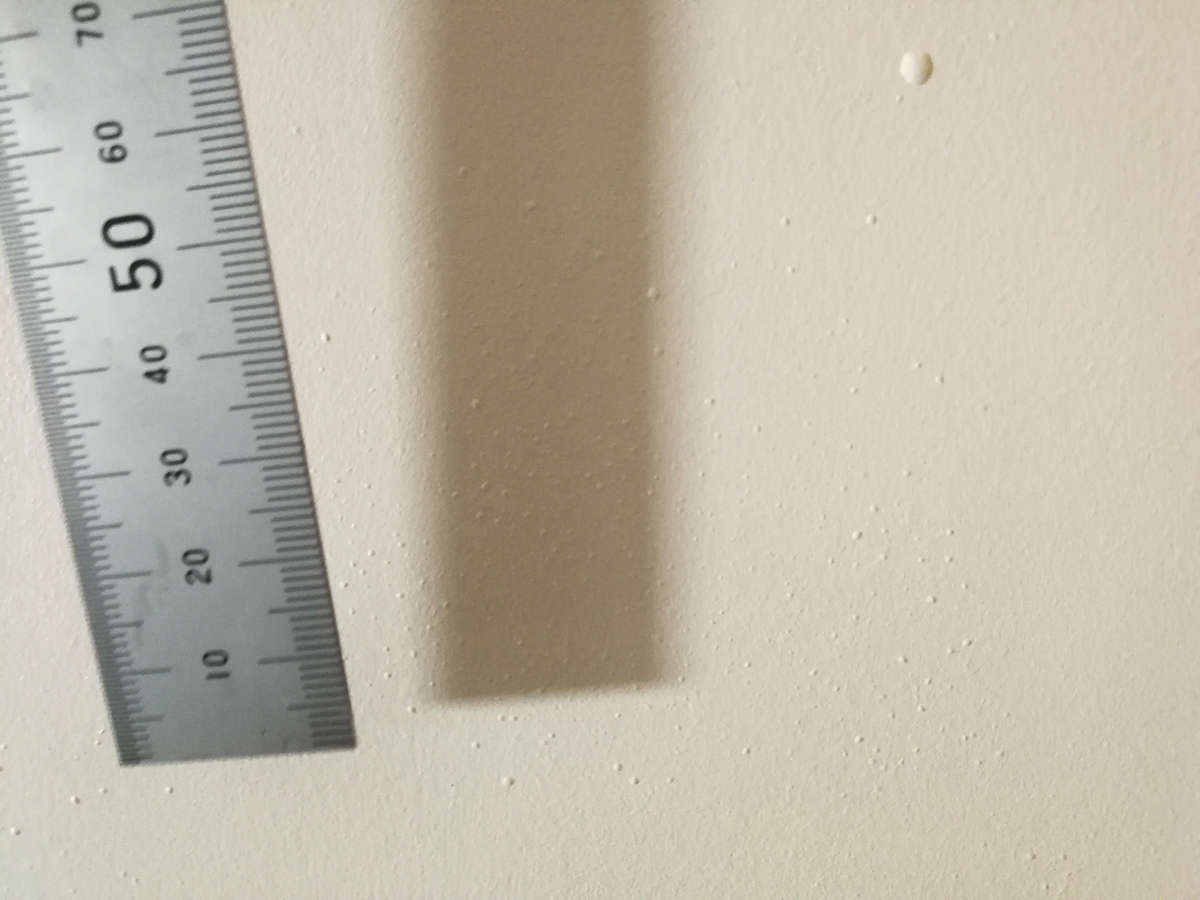

Room 2 was the primer undercoat directly onto a mix of skim & original emulsion. Same issue.

We just had a similar-ish problem where the previous owners had slapped a coat of blue satin kitchen paint over original satin paint. Anything we did over the top (including a coat of Zinsser bullseye123+) caused bubbling when further coats were added as the blue wasn’t properly stuck and moisture penetrated through it and made it lift.
The only solution was to manually wet and scrape as much of the blue satin off as would come and then coat it all with Zinsser cover-stain which is solvent based. This worked and we could then paint normally over the top.
  • 4 weeks later...
Thanks @gaz_moose and @Spreadsheetman. My situation turns out to be identical to yours @Spreadsheetman. Some kind of contamination on/in the wall and yes I tried bullseye123+ first and it still bubbled.
Zinsser cover-stain has sorted it - save I missed two areas and have to redo them! I ended up thinning it by 30-50% with white spirit as it was impossible to spread smoothly otherwise; at a guess because the wall is porous and absorbing liquid.
