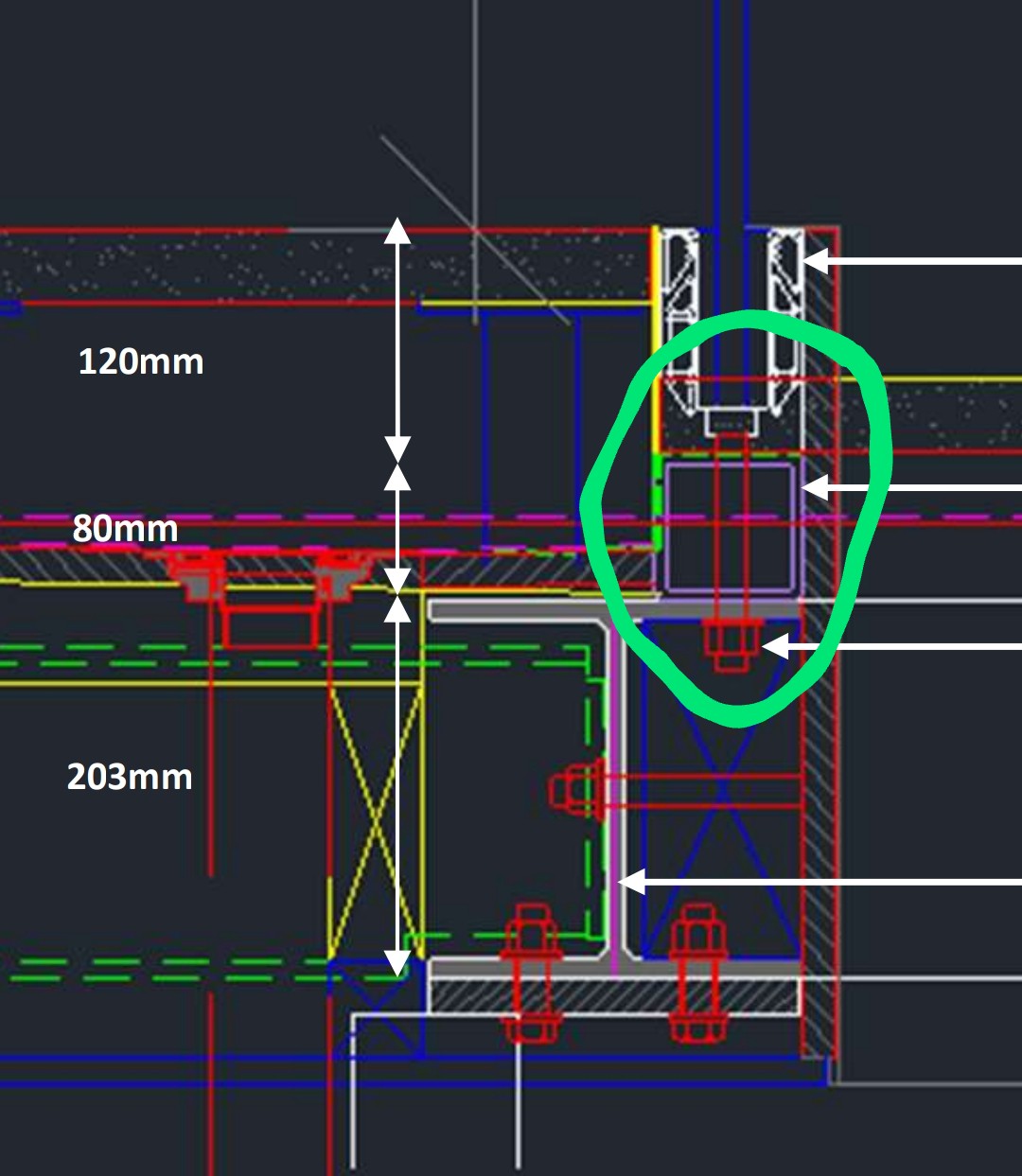

Conor Posted February 26, 2023 Share Posted February 26, 2023 I've three 18mm holes to drill through a beam with 7mm web. Obvious choice is a mag drill but I cannot justify the cost (drill hire, transformer, annular bit) for just three holes. So, 18mm HSS twist drill, TCT holwsaw or traditional bimetal holwsaw? Thinking this: https://amzn.eu/d/h48Y2ur I'd thought of a HSS bit, but then I'd need to buy a 12, 14 and 16 as well ideally. Also, I've approx 80(!!!) 9mm holes to drill, as per below. The 80mm SHS is already welded to the 203UC. Don't see any other option other than using extra long HSS bits (4, 6, then 9mm) in a normal drill. I doubt I could drill the flange from below. I do have a portable stand/press that I can clamp. Any other smart thoughts? Link to comment Share on other sites More sharing options...

SiBee Posted February 27, 2023 Share Posted February 27, 2023 Try the cutter you linked. The one Miek linked also looks good but expensive like he said. Twist or jobber drill could do you an injury by throwing you around the drill! Apologies if you have skills👍 I wouldn’t fancy a Starret holesaw tbh, just seem to blunt very quickly. However, I drill Unistrut regularly and these fly through and seem to last: https://www.cef.co.uk/catalogue/products/4335977-18mm-sheet-steel-holesaw Not ideal for a 7mm web but with cutting fluid and taking it easy,I wouldn’t think twice about using this method. I sold a 240v mag drill the other year on a well known auction site. Had no interest for weeks until a self builder offered me £40. He was drilling beams. Link to comment Share on other sites More sharing options...
Gus Potter Posted February 28, 2023 Share Posted February 28, 2023 On 26/02/2023 at 06:52, Conor said: I've three 18mm holes to drill through a beam with 7mm web. Hi @Conor If that is glass above the small detail you have posted.. it looks a bit suspect.. the method of connection.. Post more detail.. if you want to avoid disappointment and want to keep folk safe. It looks to me like neither your SER Engineer or the glass folk will take responsibility for this.. so it is down to you to understand the issues of what is quite complex to design. To put it in a nut shell the glass folk test on a stiff test rig to verify the safe loads... what you have detailed is a mile off so you glazing won't pass muster and you SER Engineer will bail out.. read their fine print! I recommend that you nut this out before drilling any holes. It may be that you can regig the detail to make it better and for less work! If you want fesse up and provide the manufactures' connection details and load tables for the track I'll chip in to give you a bit of advice on how you sort this out., not just for you but for all on BH. Also your detailing.. bolt clashes and buildability.. it may be that you are using say Tekla or Revit where you are getting a depth of view rather than a true section.. it all looks a bit crap on the screen shot you have posted! Link to comment Share on other sites More sharing options...
