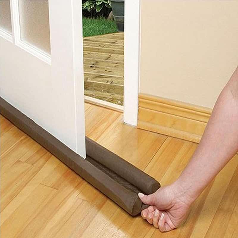

Hi and Welcome
I also live in a listed building in North Cornwall over 150 years old.
Being listed is both lovely and difficult I get you completely.
We are not allowed solar on the roof, no ASHP allowed, and have to keep the windows wooden.....
I started with the basics which you have probably already done. All lightbulbs low energy, draft excluder around doors, old fashioned sausage dog type at main doors, rugs and blankets, heavy curtains etc
Are you on LPG?  I find filling the tank up in August is often cheaper and don't forget you can shop around your not tied to one supplier, unless you have just got a new tank, after the minimum your still free to move.  Calor installed a new large underground tank £250 ish we dug the hole and filled back in.  We left them after the minimum term and found cheaper supplier who took over the tank.
Are you on Economy 7?  Make the most of the cheaper hours.
Once you have the basics sorted move onto slightly bigger things like insulating pipework, Hot water cylinders extra insulation.
Finally save up and get permission if necessary for the other things.  We need new windows but at over £1000 per small window supply only its too expensive for now.
If you already have ideas you will find lots of help on the forum.
