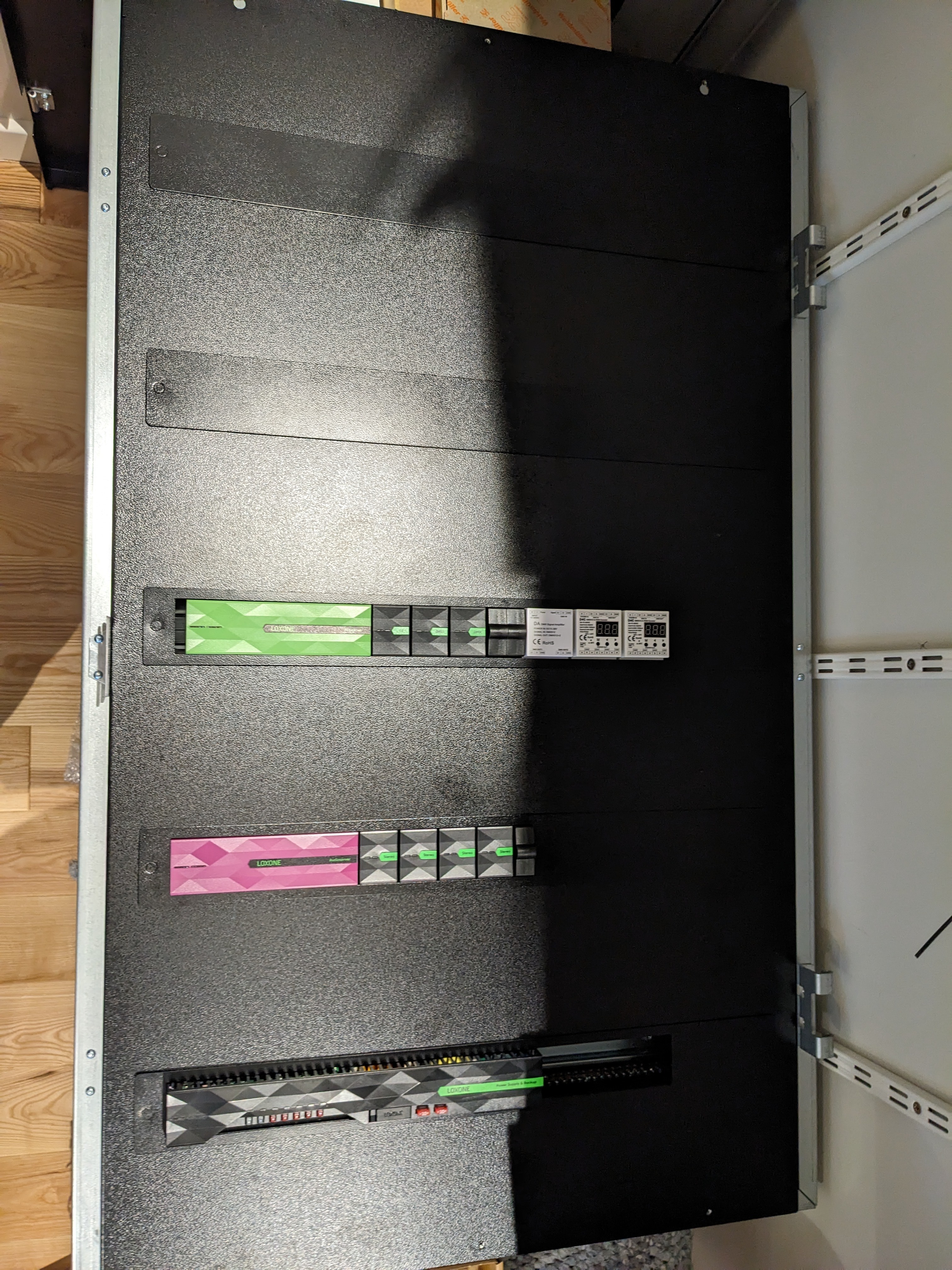

joth Posted February 25, 2023 Posted February 25, 2023 5 hours ago, BartW said: is there any software out there to help visualise / configure all gear that I need to be able to squeeze in? Google Sheets is my current go-to for this 😐 It's worked well, parts arrived for my second build this week and the trim plates all fit just as expected 🙂 The top two blank rows hide terminal blocks and whitewing dimmers respectively. Terminal blocks make onsite installation much quicker, if you lace the cabinet before install, and slightly more flexible over time. and also solves things like what to do with all the dangling neutrals and earths. Top tip is to layout terminals in an order logical for the cables coming in from the building rather than grouping by function within the cabinet (while keeping low voltage and mains segregated). Everything works out much neater and easier to trace this way.
