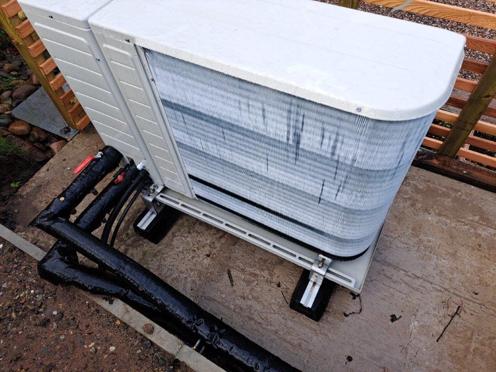

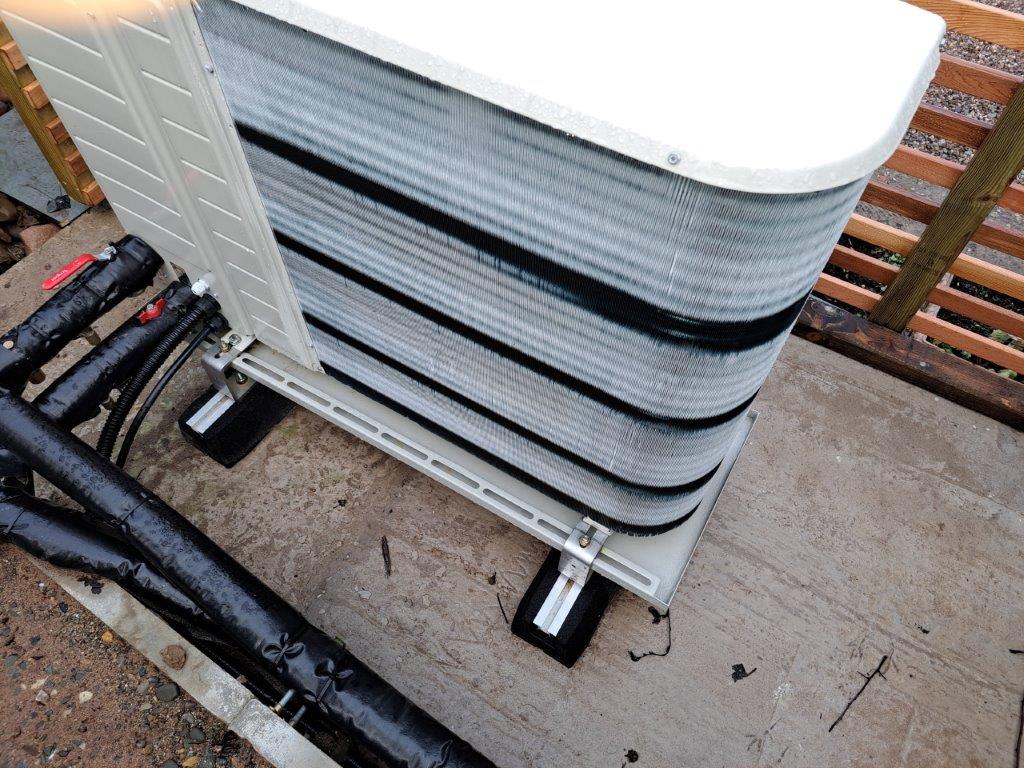

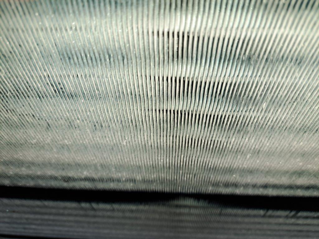

Steve W Posted February 24, 2023 Author Posted February 24, 2023 The unit has an external sensor on the North wall of the house to ensure that it shaded from the sun. I have attached the pictures from the 27th January - 9 p.m. (this was the fourth cycle of the morning). The temperature was 2.5C and sunny - the humidity was probably greater than 95% (this was before I bought my weather station). The frost started to be apparent after approximately 8 minutes and by 25 minutes the unit was labouring just before it went into its next defrost cycle.

dpmiller Posted February 26, 2023 Posted February 26, 2023 they defrost when they need to. If it's iced up sufficiently that the fan can't pull fresh air through, it needs a defrost. Simples. You absolutely *can* get your LWT over 45c, but you'll need to reduce your energy demand to allow it to happen... / I can make mine ice up and need defrosts at around the same intervals, yes. But only by starting it from a cold house, in DHW mode, but leaving the CH circuits open too.

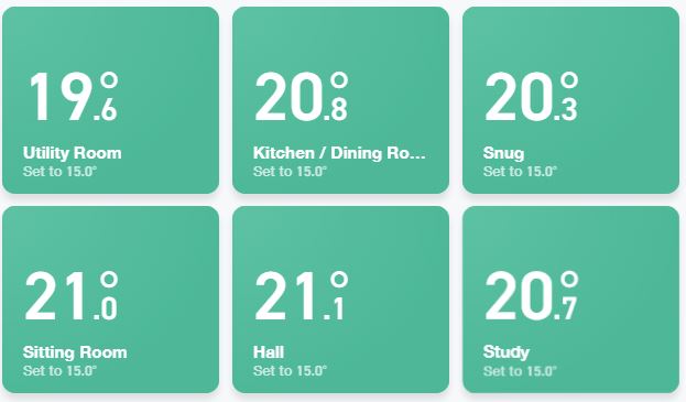

Steve W Posted March 10, 2023 Author Posted March 10, 2023 Both Daikin and the installer are coming out next week. On a day with 75% humidity, and -2C the house is 21 C in the morning, defrost cycle greater than 60minutes. At 94% humidity and -0.5C the temperature is the same as when it started and the defrost cycle is every 25minutes. The area is about 75sqm and the temperature ask is about 1.5C as in the starting temperature is 19.5C. The temperature here at, 6.30pm 10th March, is -2C and the humidity 85% and the defrost cycle is more than an hour, room temperature is 20.5C. Tonight I am expecting -10C so should be interesting.
