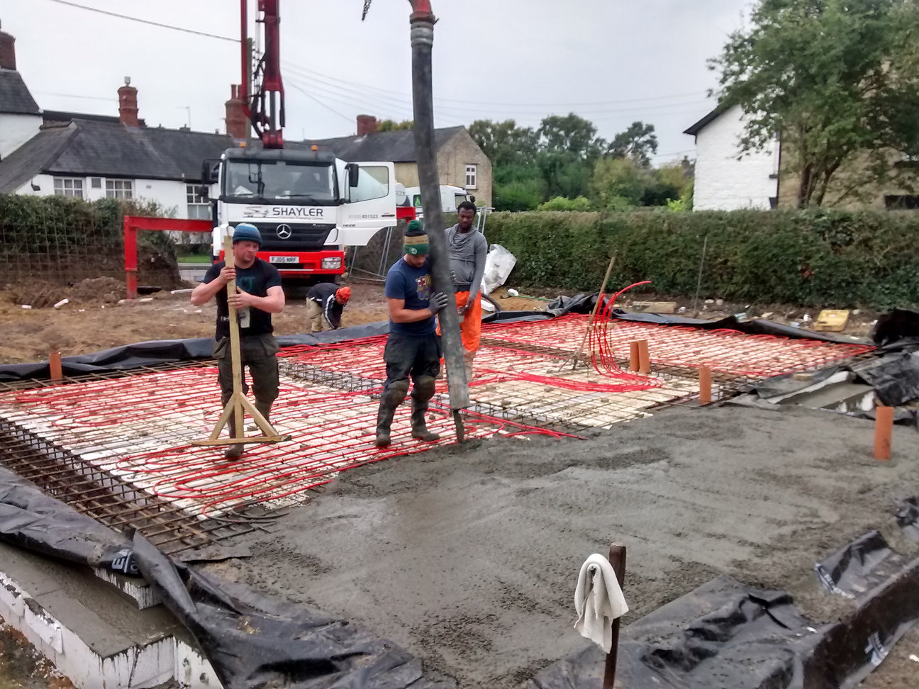

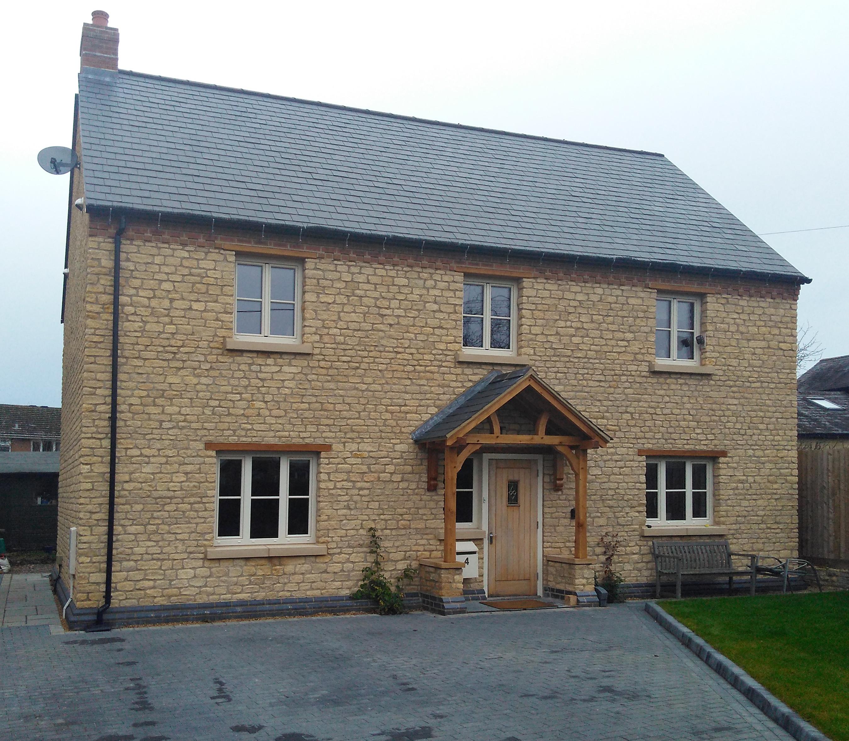

TerryE Posted February 28, 2023 Share Posted February 28, 2023 (edited) @Shaun McD, As @jack says at 20,000 ft, our warm slabs used a broadly similar approach albeit with some difference because specs and BRed variations, e.g. MBC wacks down the subbase in 5cm layers to guarantee compaction; EPS thickness is typically 30cm; the upstand section are factory pre-cut; the rebar is typically a lot heavier for 2 and 3-storey houses; and most UK BCOs would be unhappy about burying 25mm MDPE in the slab, even if rebated into the EPC. Here is our slab being poured, but we have a 2½ storey Larsen-strut TF proving the structure (hence the heavy load-bearing ring foundation) with a stone cladding for weather-proofing and looks. and as finished: One of the other posters was questioning about pipe pressures, etc., so a couple of useful references from one of blog posts on plumbing design: ... such reference works as this excellent intro into pipework calculations: John Heartfield, Water Flowing in Pipes I – The Theory and useful sites like the Pipe Pressure Drop Online Calculator. The first is worth a scan if you want to get a handle on some of the sizing issues. Edited February 28, 2023 by TerryE 1 Link to comment Share on other sites More sharing options...
