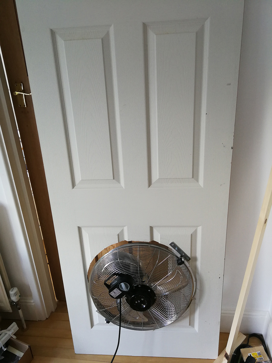

I'm now going to get myself a DIY rig as suggested by others here, so I can perform my own "day of plugging / testing" on my clients behalf, eg before employing a 4rd party to come and test and issue a cert. Seems the best money my clients could spend, and is already going down well when I suggest it.
1 hour ago, Shaun McD said:
What type of DIY rig are you thinking? Your own blower?
This is my blower door that's awaiting commissioning. My house has 4 5 different doorway sizes so plan is to tape plastic sheet at the sides/tops to seal it in.
I am frustrated how oval the hole I cut in the door is. Am thinking of filling the gap or putting the fan in a tunnel (don't know what the technical term is) to guide the airflow.
Just tape it.
Use a builders flexi-tub bucket? Wedge that into the hole and tape, then push the fan into the bucket until snug.
Cut the bottom completely flush / out of the bucket, of course!
This is super interesting and seems right up my street ha! I was only ever involved in a test once, and the tester was more keen to get job done and out rather than answer any questions. I remember he had smoke candles to see leakage points, is this still the method? Im guessing it is easiest to pressurize the room to test on this kind of level?
Pretty sure I have an old radiator fan and a washing machine motor kicking about to rig something up!
My house is so draughty that yes I'm planning to depressurise a room at a time to start with. I do have a second fan so if I need more oomph I can mount two in the door.
Why a door? This was free and wood's expensive at the moment. Old doors are also cheap on FB Marketplace.
I believe you only install the "blower" into a front, side / rear doorway and thus pressurise the whole house. Are you thinking of doing room by room?
So depressurize instead of pressurize? The previous one I seen done must have been pressurized as we walked around with the candles and you could see the junctions in which air was getting forced out as that is where the smoke was pulled to. I suppose in a depressurized test you do the same thing but the air will be blowing away from the leakage point, so maybe its no difference.
A door makes sense yeah, fan needs to be securely mounted for obvious reasons. I am a few months away from having rooms to test but for sure this will be something to do, provided i dont get a great result from the TF company first time ha!
I was thinking on a room by room approach too, would reduce the volume of air to move through the fan, and would think it be more manageable sizes for a novice tester? My better half reminds me my time is not worth much so...
You still test room by room, but with the whole house pressurised.
You're not looking to replicate Michael Jackson's "oxygen tent of eternity", so going full bore in each room may be a bit OTT?
All I need now is somebody cleverer than me to tell me how to gauge the ACH from the DIY rig.
The winner gets a half-eaten Greggs steak bake. Only been in the van for 2 days, still good.

Just FYI, the formal test involves taking an average of pressurisation and depressurisation.
If I depressurise I can feel the draughts with my hands. If using smoke I might pressurise.
Yes that is the million dollar question.
I've found https://www.builditsolar.com/Projects/Conservation/BlowerDoor/FlowRates.htm but not gone into the details yet.
Checking if I reach 50Pa should be simple(!) with a U-shaped tube through the door, fill it with coloured water and measure the height change.
Volume of air shifted - well Screfix are out by a factor of 10 in their quoted l/s for this fan so no idea.
Not easy, but an inclined manometer and a flow meter will be needed.
All the things that a plumber probably has already.
