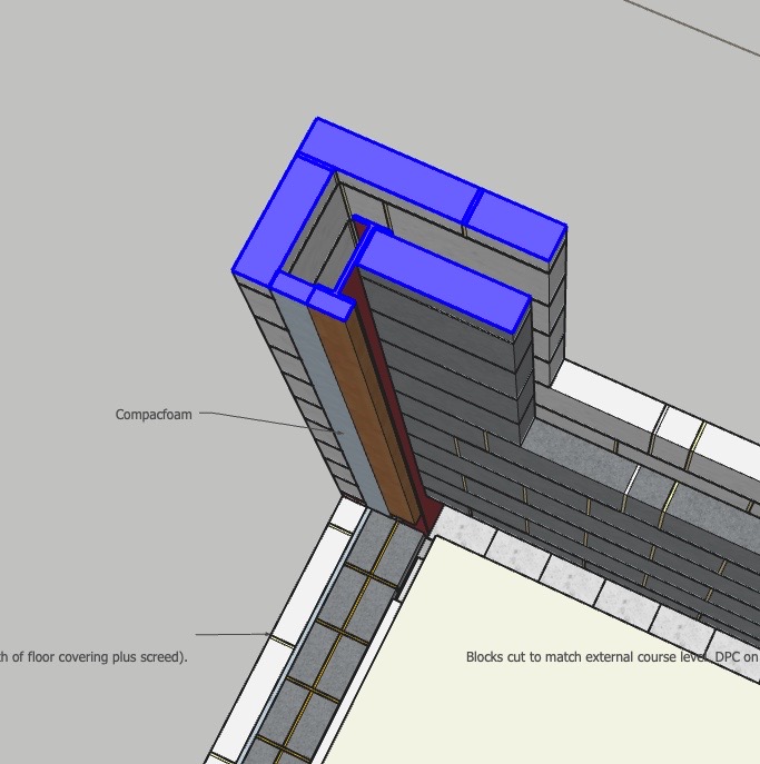

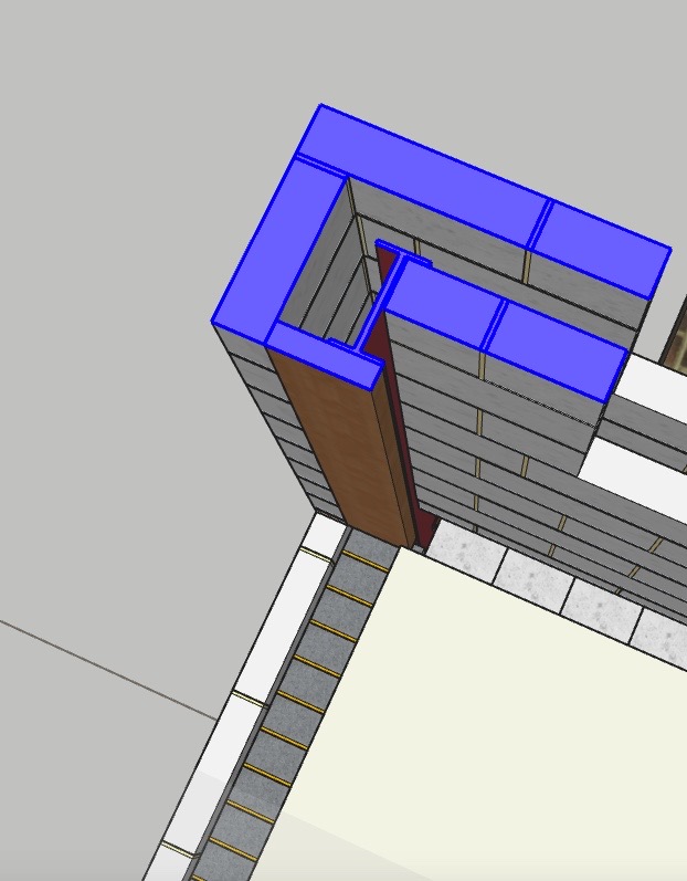

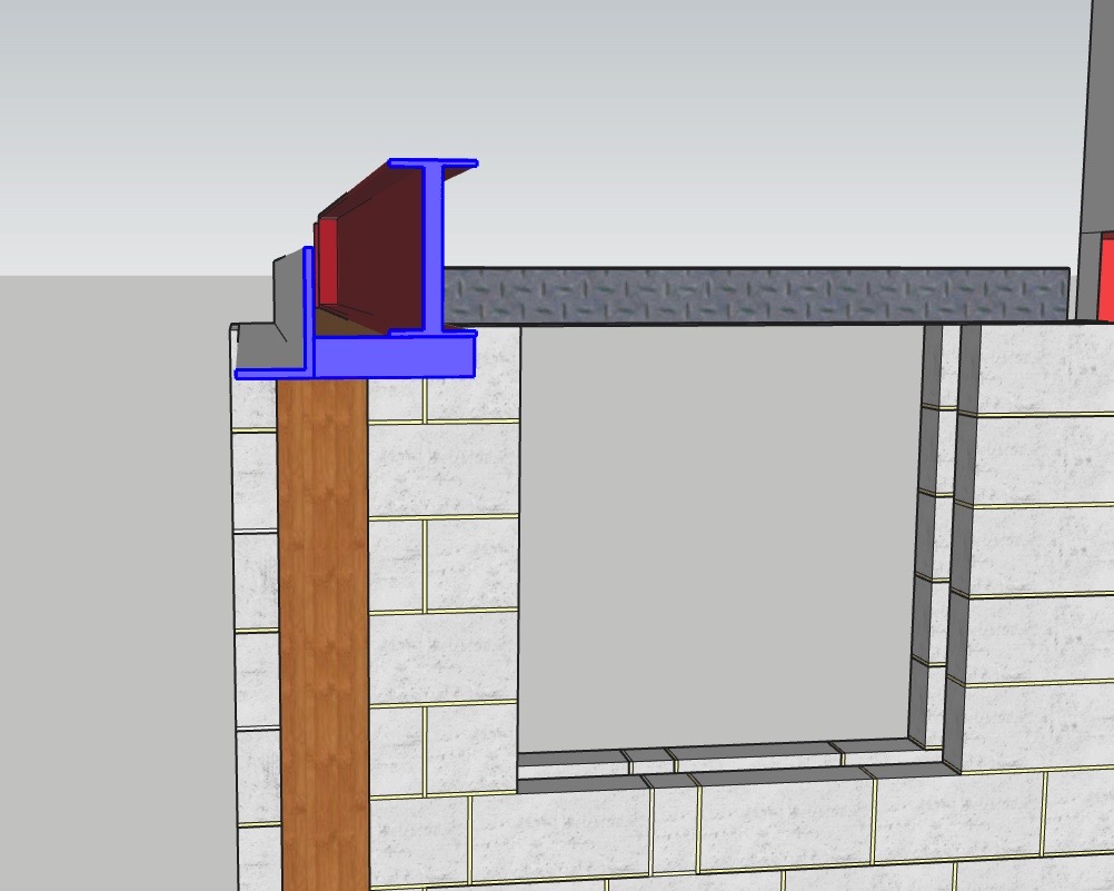

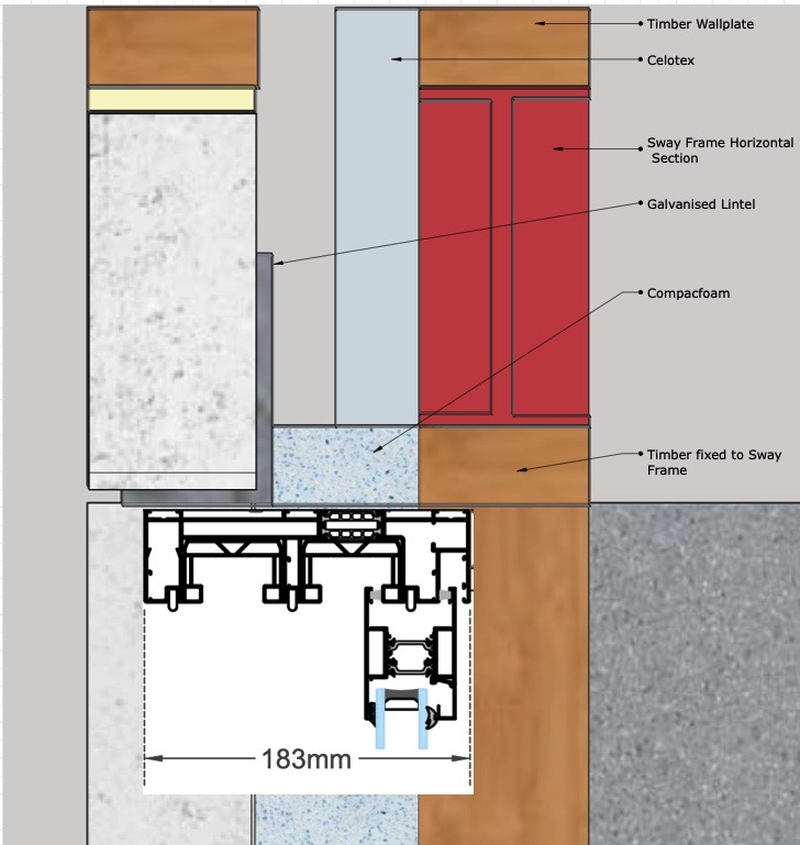

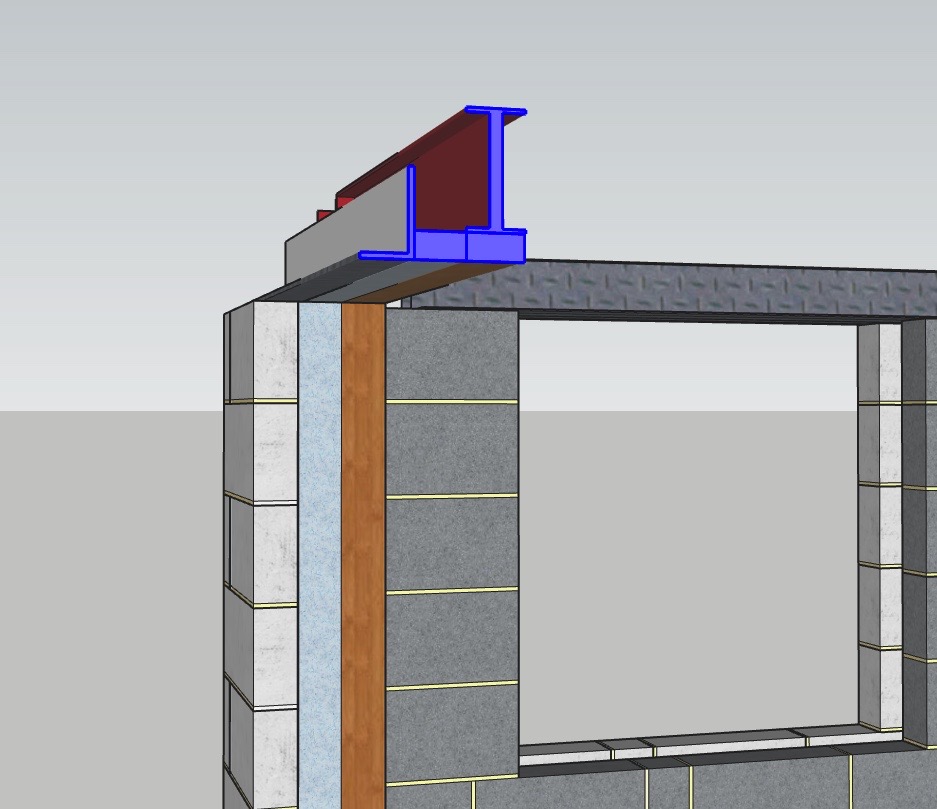

Lift span Posted February 21, 2023 Posted February 21, 2023 Hello! I'm looking at two options for closing the vertical (jamb) and overhead cavity in the extension design below: Timber or Compacfoam 200. Has anyone any experience of doing either? The triple track sliding door frame is over 180mm wide and needs fixing all round so a standard cavity closer won't work. The timber is cheap and easy and I was thinking of wrapping it in DPC to avoid rot from condensation in the cavity. Compacfoam is expensive and I have no experience of using it. Timber Vertical: Overhead: (Angle Lintel is a separate galvanised section): Compacfoam 200:

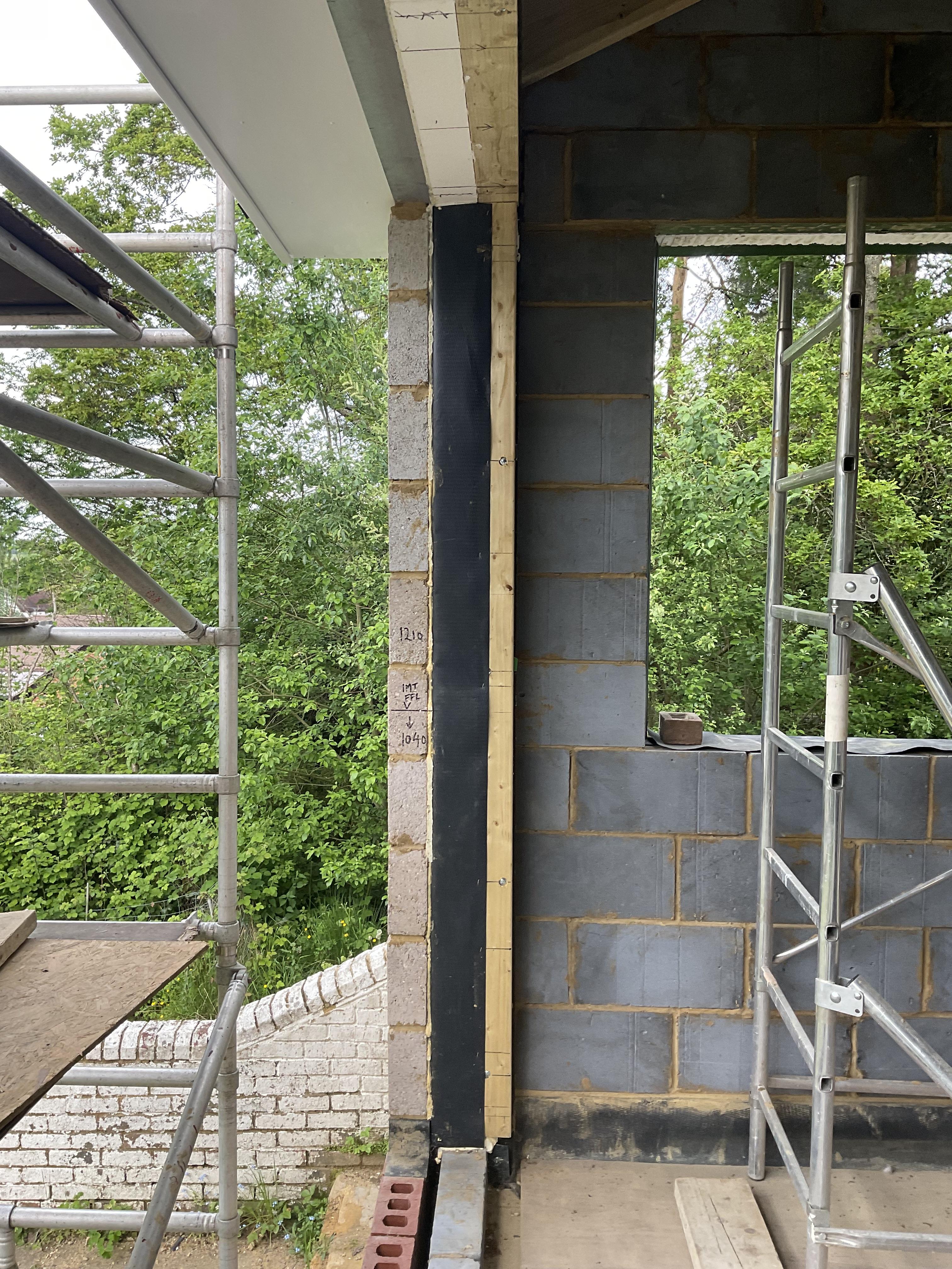

Lift span Posted May 18, 2023 Author Posted May 18, 2023 (edited) Just to update this, I went with the Compacfoam in the end. In the jambs and overhead (see picture below). I've wrapped DPC around the jambs so you can't see it! I'm now deciding what to use under the threshold to sit the doors on. I was thinking of compacfoam again but I found out about Bosig Phonotherm 200. Has anyone used it? It seems similar to compacfoam but it's available in bigger wider sheets: Edited May 18, 2023 by Lift span

Lift span Posted May 18, 2023 Author Posted May 18, 2023 They can fix into the compacfoam. They've been around and surveyed it already. It's solid stuff!
