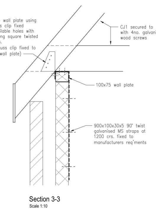

richo106 Posted February 20, 2023 Posted February 20, 2023 I am just looking to buy some wall plate straps and was looking at my SE drawing. I have a scoured the internet tonight but can’t seem to find when they detail (please see attached) It looks like it goes over the top of the wall plate and then back over it like a hook? It also says twist The ones I’ve seen before are just a long strap with a 90 degree flat that fix’s into top of wall plate and secured into the wall If anyone could point me in the right direction it would be very helpful as I am slightly confused and I am planning on fitting these next week. Many Thanks

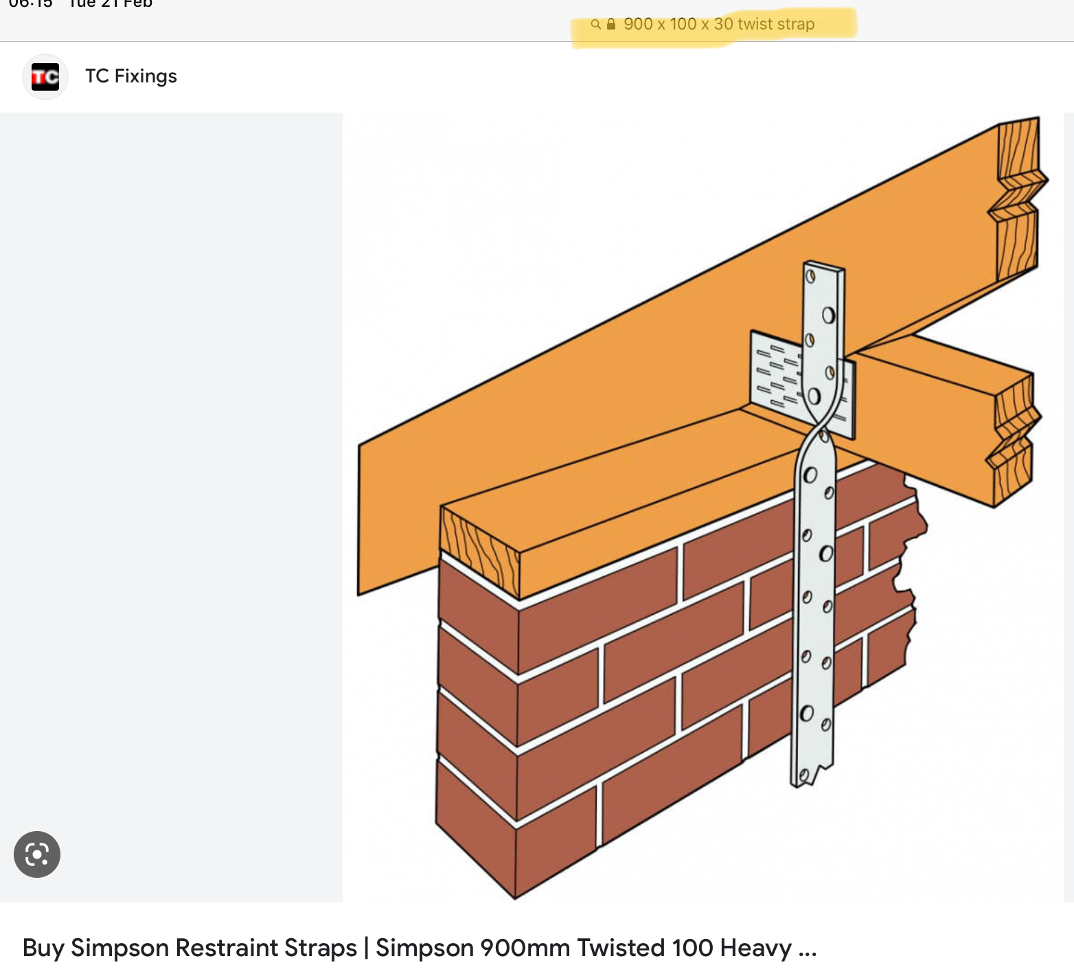

Bonner Posted February 21, 2023 Posted February 21, 2023 If you Google 900*100*30 twist strap you will find the right product. Designed to strap the truss to the wall, not fastening the wall plate which is what the angle straps do.
Dave Jones Posted February 21, 2023 Posted February 21, 2023 cant see the login for not using normal wall plate straps. The trusses are held by clips to the wall plate already. Any builders merchant stock them.
richo106 Posted February 21, 2023 Author Posted February 21, 2023 1 hour ago, Bonner said: If you Google 900*100*30 twist strap you will find the right product. Designed to strap the truss to the wall, not fastening the wall plate which is what the angle straps do. The bit that is confusing me is that it mentions 90 degrees and the dashed black show that I think shows the strap goes up and over the wall plate

Dave Jones Posted February 21, 2023 Posted February 21, 2023 maybe the SE has designed to resist uplift if you are in an exposed position ? same effort to use wither so it doesnt really matter.
markc Posted February 21, 2023 Posted February 21, 2023 Think it’s a copy and paste detail, twist straps always go from wall direct to truss to resist uplift? Wall plate straps come with a single 90 bend and you bend them over the wall plate forming the U shape after fixing .. one strap covers many wall plate widths. if you use twisted ones from wall to truss you will be ok
Bonner Posted February 21, 2023 Posted February 21, 2023 27 minutes ago, richo106 said: The bit that is confusing me is that it mentions 90 degrees and the dashed black show that I think shows the strap goes up and over the wall plate I agree the drawing is not clear but the note states twist strap. It has 90 deg. twist whereas the other type has 90 deg. bend
Dave Jones Posted February 21, 2023 Posted February 21, 2023 one is specified to resist wind uplift one isnt. quite important to get right if its been specified.
Canski Posted February 21, 2023 Posted February 21, 2023 13 minutes ago, Bonner said: I agree the drawing is not clear but the note states twist strap. It has 90 deg. twist whereas the other type has 90 deg. bend The drawing is clear. The confusion comes from the writing. 1
Kelvin Posted February 21, 2023 Posted February 21, 2023 2 minutes ago, Canski said: The drawing is clear. The confusion comes from the writing. My SE drawings have several errors like this where the text doesn’t match the drawing.
Canski Posted February 21, 2023 Posted February 21, 2023 1 minute ago, Kelvin said: My SE drawings have several errors like this where the text doesn’t match the drawing. Cut and paste techniques. The root of many f$@k ups. 1
richo106 Posted February 21, 2023 Author Posted February 21, 2023 Thanks all for the comments I am not in an exposed condition Think it might be worth double checking with SE
