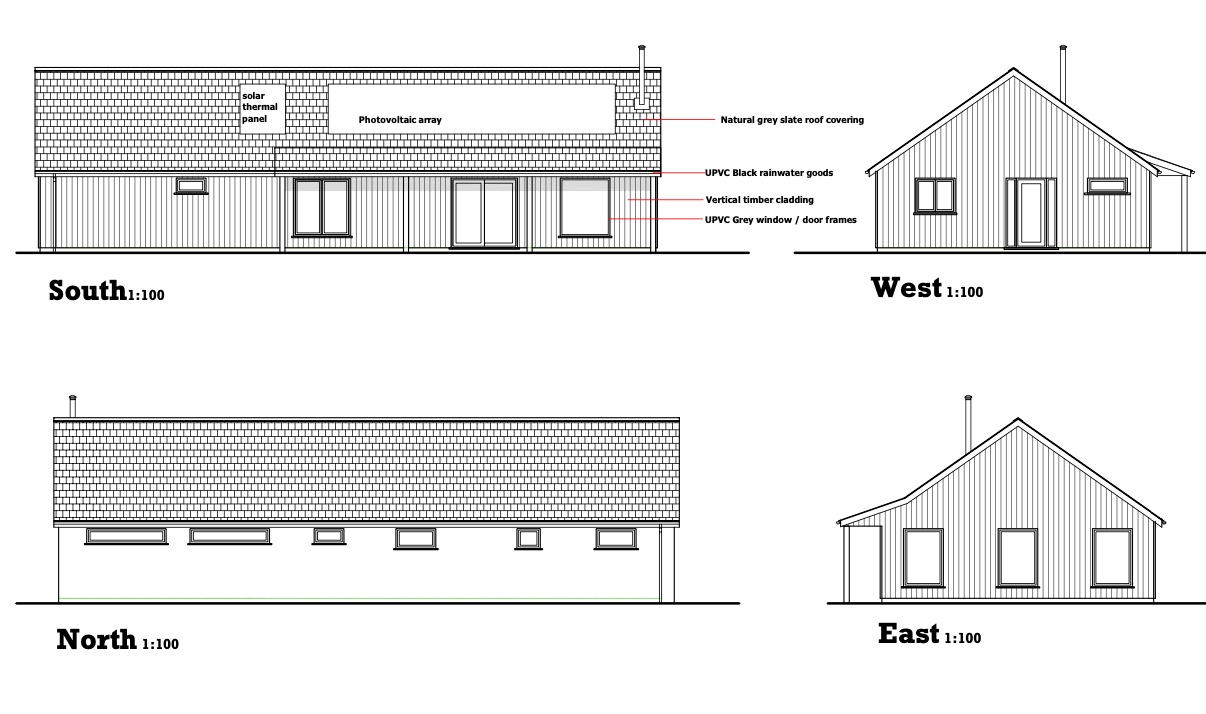

Susie Posted February 18, 2023 Share Posted February 18, 2023 We have our planning permission but fall under the new regs so for Part O Overheating we have to pass either the simplified model or the dynamic model. I have created my own spreadsheet and by changing nearly all my windows to opening and to opening inwards to get round the arms reach criteria and a few minor size changes to increase ventilation we have just scraped through as a pass. My architect has given me my sketchup file and this weekend I plan to start looking at the Thermal Dynamic modelling TM59 with Part O adjustments using TAS software. The simplified model does not take into account the MVHR or the overhang shading so I am hoping by spending a bit of time and money on the software I can keep some of my fixed windows. As this is a new reg if any one wants to look at my spreadsheet I have attached it below. I’m a Mac user so if you run into any problems on Microsoft excel let me know and I can amend it. Thanks @craigfor your help so far. It’s been a steep learning curve to get this far so if I can help any one else on their journey that would be nice. So I’m off to start another steep learning curve using the software, just preparing with a big breakfast and lots of coffee. Any tips on the software welcome. https://kb.goodhomes.org.uk/wp-content/uploads/2022/07/220720_FHH-Part-O-guidance-Final-LT.pdf#page44 https://www.edsl.net/tas-engineering-downloads/ Part O Calculations Simplified method.xlsx 3 Link to comment Share on other sites More sharing options...

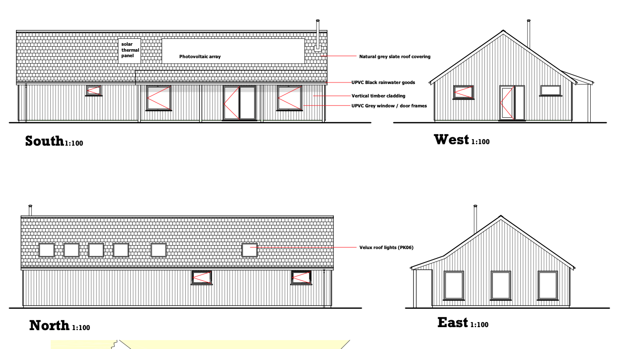

Alan Ambrose Posted February 23, 2023 Share Posted February 23, 2023 @Susie - thanks is it possible to add an image of the elevations so we can get an idea of what that % of glazing looks like in practice? TIA, Alan Link to comment Share on other sites More sharing options...
Susie Posted February 23, 2023 Author Share Posted February 23, 2023 1 hour ago, Alan Ambrose said: @Susie - thanks is it possible to add an image of the elevations so we can get an idea of what that % of glazing looks like in practice? TIA, Alan The architect is adding some roof windows, as soon as the drawings are updated I can upload an image. Link to comment Share on other sites More sharing options...
Alan Ambrose Posted February 23, 2023 Share Posted February 23, 2023 Ah, thanks I see you have an image in this thread: https://forum.buildhub.org.uk/topic/31617-ideas-wanted-to-pass-part-o-simplified-modelling-or-to-use-dynamic-modelling/#comment-467880 FYI another couple of things I couldn't get a clear steer from the 'regs' (in the Part O Guidance) are: + there doesn't seem to be any sense of angle to the sun in the Simple Method - so roof lights are a bit problematical. Which compass direction are they facing - well often mostly 'up' of course. + in a similar vein, if you have roof lights over a 1+ storey void, then do they 'belong' to the ground floor or to the one above? + re security - if you live in the countryside, is it considered 'secure' (only for the purposes of these calcs) to sleep with ground floor windows open? Doors? (As far as we're concerned we normally sleep in summer most of the year with ground floor bedroom windows open.) And general observations: + Part O is all about the problems of solar gain, nowhere does it mention or consider the benefits (economic / climate / amenity) of solar gain. + The actual TM59 software mentioned in the Guidance examples is: IES VE 2021 3.1.0 (this is 'send for quote') TAS software v9.5.2 (£200 p.m.) - it's curious that CIBSE has specified in TM59 some simulation and CFD calcs without specifying (a) exactly what those calcs are, (b) a list of software which is deemed to observe the calcs, (c) a verification method for that software. I see also that DesignBulder software claims to be TM59 compliant and uses the free US-based EnergyPlus for simulation and HVAC. There's some TM59 notes for using it here: https://designbuilder.co.uk/helpv7.0/Content/CIBSETM59.htm Link to comment Share on other sites More sharing options...
Susie Posted February 23, 2023 Author Share Posted February 23, 2023 I have a 2 week trial of TAS but probably need a rest. I was going to use it but my architect used sketchup and it won’t import so I will have to draw it up my self not too hard but I’m behind with my work so since I have at least a temporary reprieve in passing the simplified method I’m catching up on work. I might go back to it later. Even if I end up giving the software a go later it should be done in a month so not an expensive option and will take my MVHR into consideration. Then cancel the software contract. For security we are supposed to have bars or grills if a bedroom is on a ground floor. It’s a wait and see what happens game. I’m also in the country with windows open at night. They will vent from the top, tilt and turn type. My windows have had to change two made 200mm more height and 6 roof windows added for ventilation. Two small windows removed that are replaced with roof windows. All additional windows on the North and making that the most glazed facade giving better target %. My problem might be different to some as it wasn’t too much glazing but not enough ventilation as some windows were big picture windows. I don’t want them to open as too big, bigger frames needed and another window seal in a very exposed location. I feel like most of February has gone by and I have been pondering windows most of the time so need a rest. The future homes spreadsheet only came out November I think 6 months after the regs changed I guess they know it’s a mess. I will post my before and after drawings as soon as I get them but happy to help anyone if I can. Link to comment Share on other sites More sharing options...
Alan Ambrose Posted February 24, 2023 Share Posted February 24, 2023 Thanks, some interesting insight. Clever to make the North facade the most glazed. I was surprised that you had to increase the size of the windows, my feeling (I have not done the ventilation calcs yet) was that I would be struggling to keep the glazing I want. The paper I listed above showed a comparison between IES VE and EnergyPlus and the conclusions included "Significant differences were recorded between predictions, with the EnergyPlus models recording a high overheating risk in seven out of the nine cases, while IES VE predicted a low overheating risk for all models." That suggests to me some TM59 game playing by choosing the package that comes up with the most helpful results? I can't help feeling that Part O is very badly thought out. I'm reading a bunch of stuff on PHPP & TM59 right now. Link to comment Share on other sites More sharing options...
