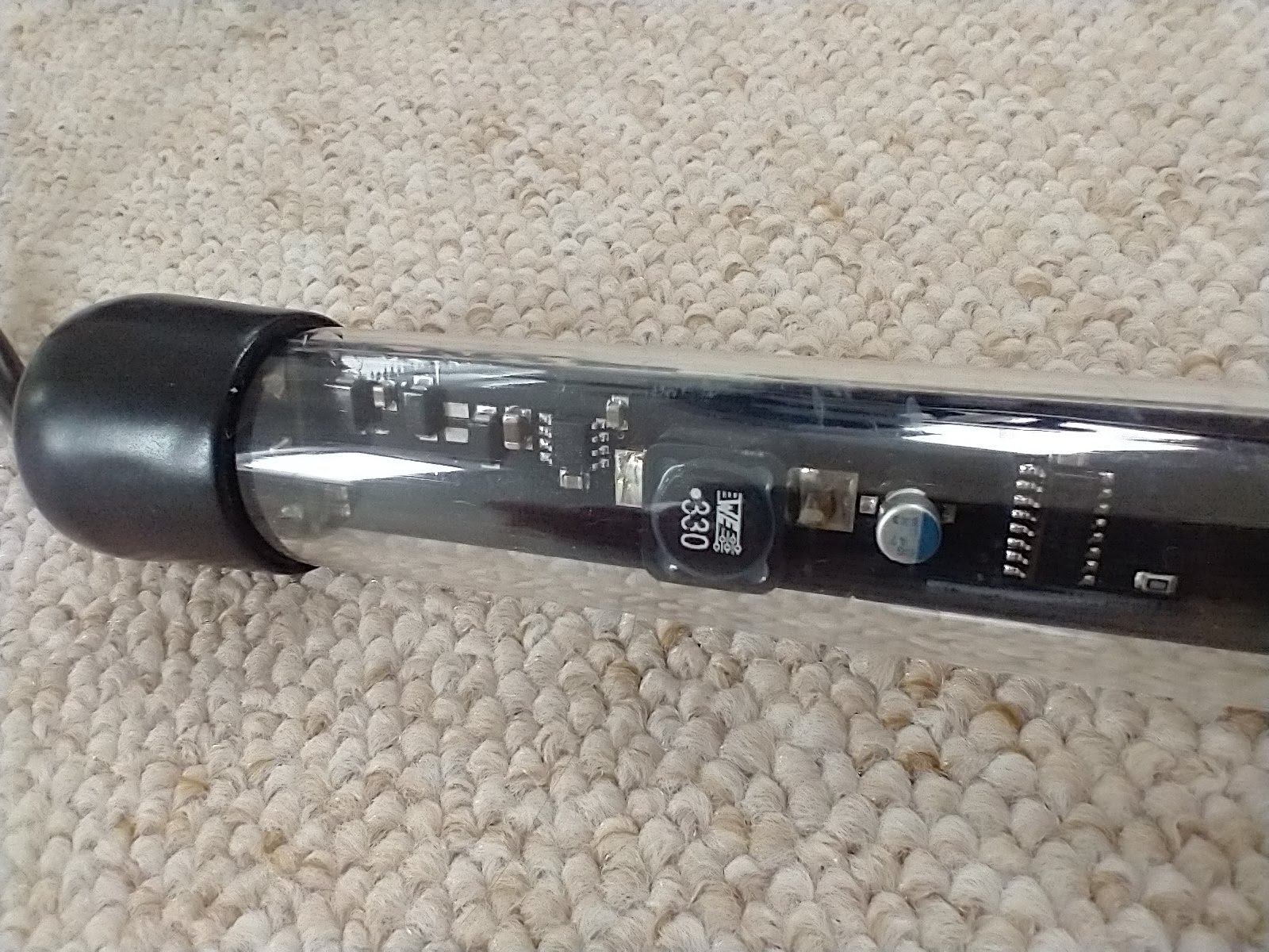

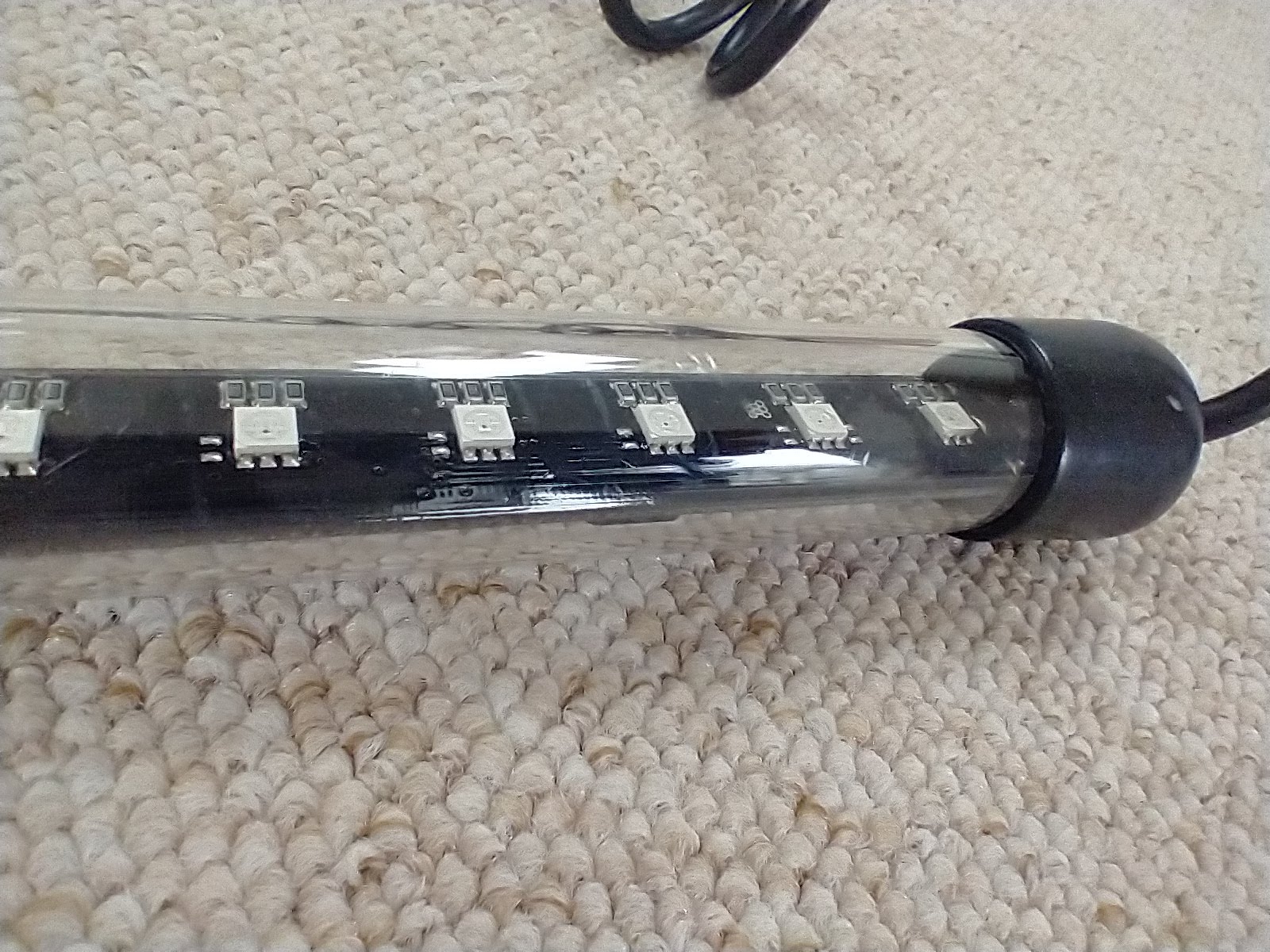

Radian Posted February 18, 2023 Posted February 18, 2023 3 hours ago, pocster said: Got another one of these light wells to do soon ( ish ) . Going to build it in a similar way but leave a nice hole at the top . Get the glass on and see what happens . A proper comparative test @Radian ! Drilling the other to make a hole of some kind will be a pita ; so want proof of theory . That's good. Condensation is an absolute PITA. Several of my products have microcontroller driven LED's in clear plastic tubes for use outdoors (under cars, yachts etc.) and despite going to great lengths to hermetically seal the end caps and cabling, the polycarbonate tubes themselves have a finite amount of hygroscopic absorption and repeated heating and cooling pumps water vapour through the plastic. Then because it's decoupled from the outside, once the temperature falls below the dew-point the vapour condenses into water droplets. That's not a good look on a PCB full of electronics. Because of the inevitability of this I've had to apply a good coat of mil-spec lacquer over all the electronics and just leave nature to do its thing. The good news is that the water never builds up. The self-heating of the electronics clears the vapour on average and some tubes I've had outdoors since 2003 still work fine with a few drops of water nearly always present. 1
